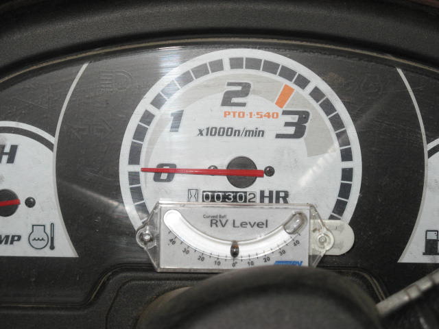

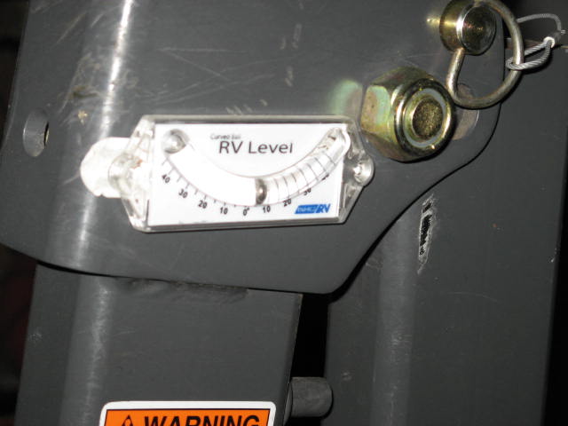

I was looking for an inclinometer, and saw some very nice units here on TBN, but didn't want to spend the $80.00 it would have cost me to order here in Canada. This was especially true since I could get something very similar at my local Canadian Tire. I posted some pics of the RV levelers that I bought in a two pack for under $15. I didn't use the double sided tape that they came with and instead used some 3M tape - so if I ever want to remove them, its no problem.
As you can see, one is on my dash, and the other is on the ROPS, so both forward and side to side levels can be monitored. I can feel when I'm approaching 15-20 degrees. I try never to exceed 20 degrees on a side slope. I know that the tractor can handle 20 degrees quite easily if I'm careful. I use the inclinometers to confirm what I'm feeling, and they work great in this regard.
