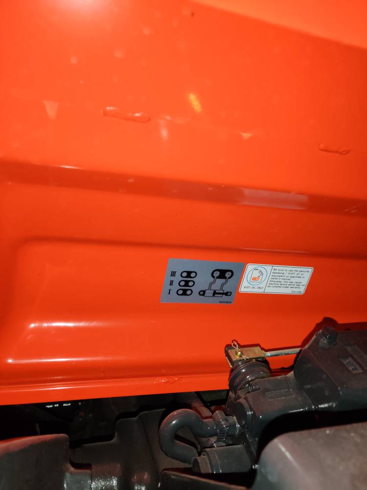

Weird, mine told me it wasn't possible to have 3 'stock' rear remotes. Despite their being a picture of all three on rear of the tractor. I didn't want to argue or press the issue since I don't really envision using 3 remotes ever. View attachment 624276
My dealer told me the same thing. In fact, the only reason that I am waiting on the 3rd remote is that he listened to his manager or somebody that told him only 2 were possible. :( When they received the NX5010C chassis and were working it up, I visited and saw only 2 remotes. He told me the 3rd was not possible. I told him what I learned on TBN about the 3rd remote situation and he proceeded to order another remote and the longer bolts the next day.
My understanding is that Kioti only offers the 3rd remote option outside North America and dealers here cannot order an "official" 3rd remote kit. The US dealers need to order two 2nd remote kits and get longer bolts elsewhere. This means that you end up with the factory gray and two blue covers for the remote control levers and QC's. The official 3rd remote kit has a green lever cover and green QC covers. Otherwise all function the same. I got the 3rd with detent for possible constant flow.
Why Kioti uses the same sticker on the rear showing 3 remotes in the US while telling the US dealers that 3 are not possible is beyond me. :confused3:
If you decide that you need a 3rd someday, it should be cheap and easy to install yourself. The hardest part is probably pulling the cable, although might be easier on a non-cab model.
