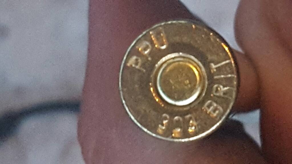

uploadfromtaptalk1493514857409.jpg I really didn't expect to have a primer that after hit has zero dimple and only some minor scratches. Shot gun fires regular .410 target loads without issue.
   / Ammunition #1,205
View attachment 507756 I really didn't expect to have a primer that after hit has zero dimple and only some minor scratches. Shot gun fires regular .410 target loads without issue.
In my mind without a doubt, that cartridge falls too far into the chamber for the firing pin to even reach.. Who advised that .303 british could be fire formed into a .410 shotgun? I have never heard of that. I have always heard that .45 Colt would fit into the chamber. In fact all of the Taurus Judge models show interchangeability with .45 Colt and .410 shotgun shells. I think it drops too far in.

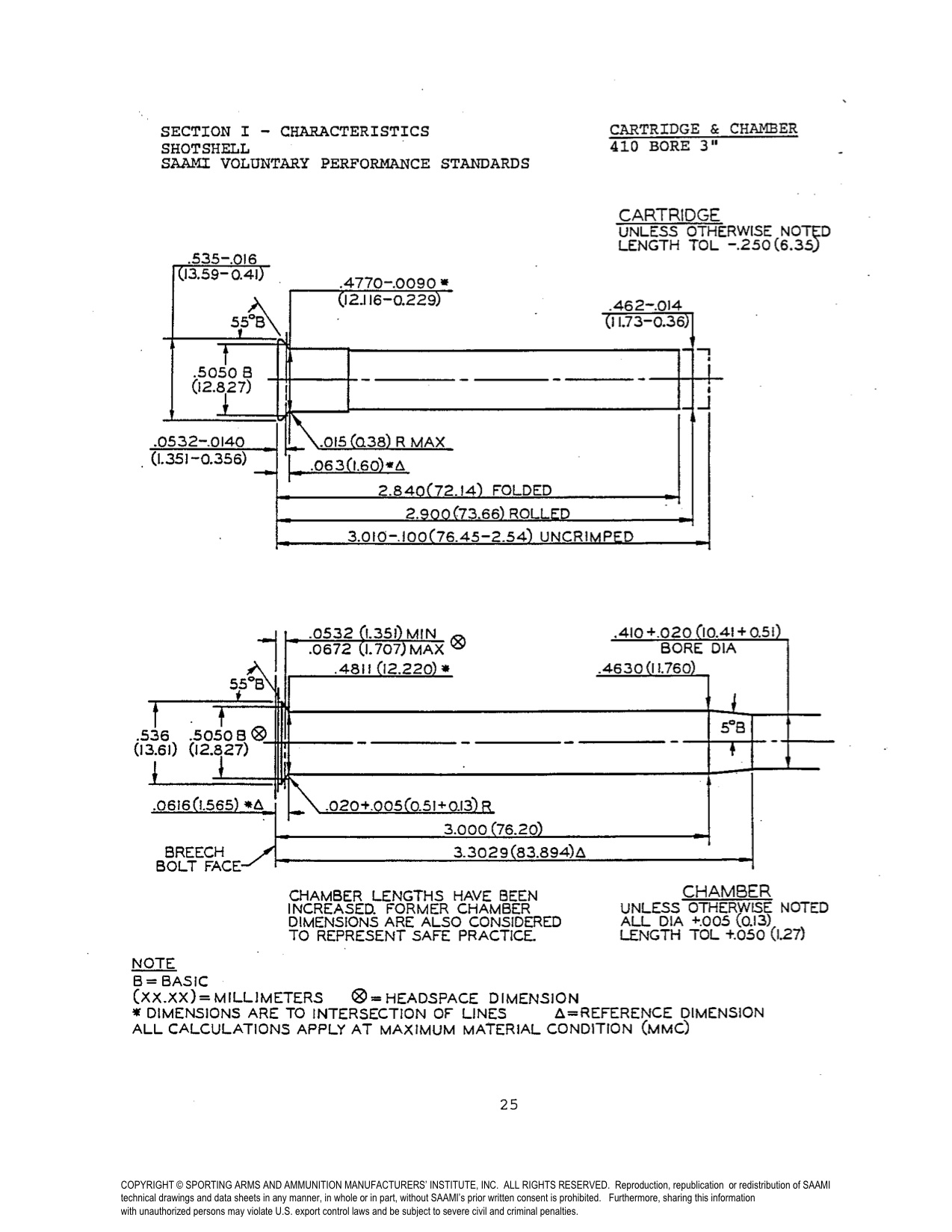

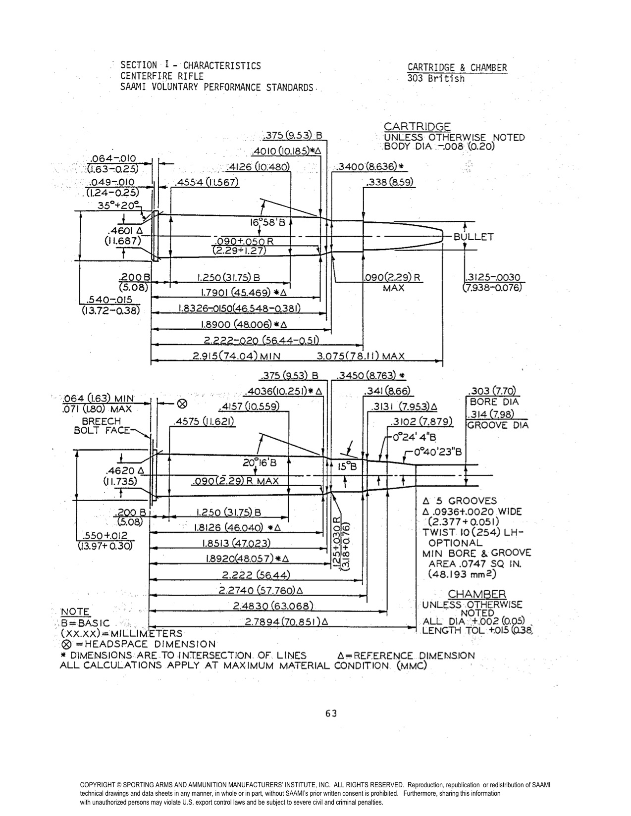

Measurements, cartridge is top drawing, chamber on bottom.
410
303 British
Bruce
