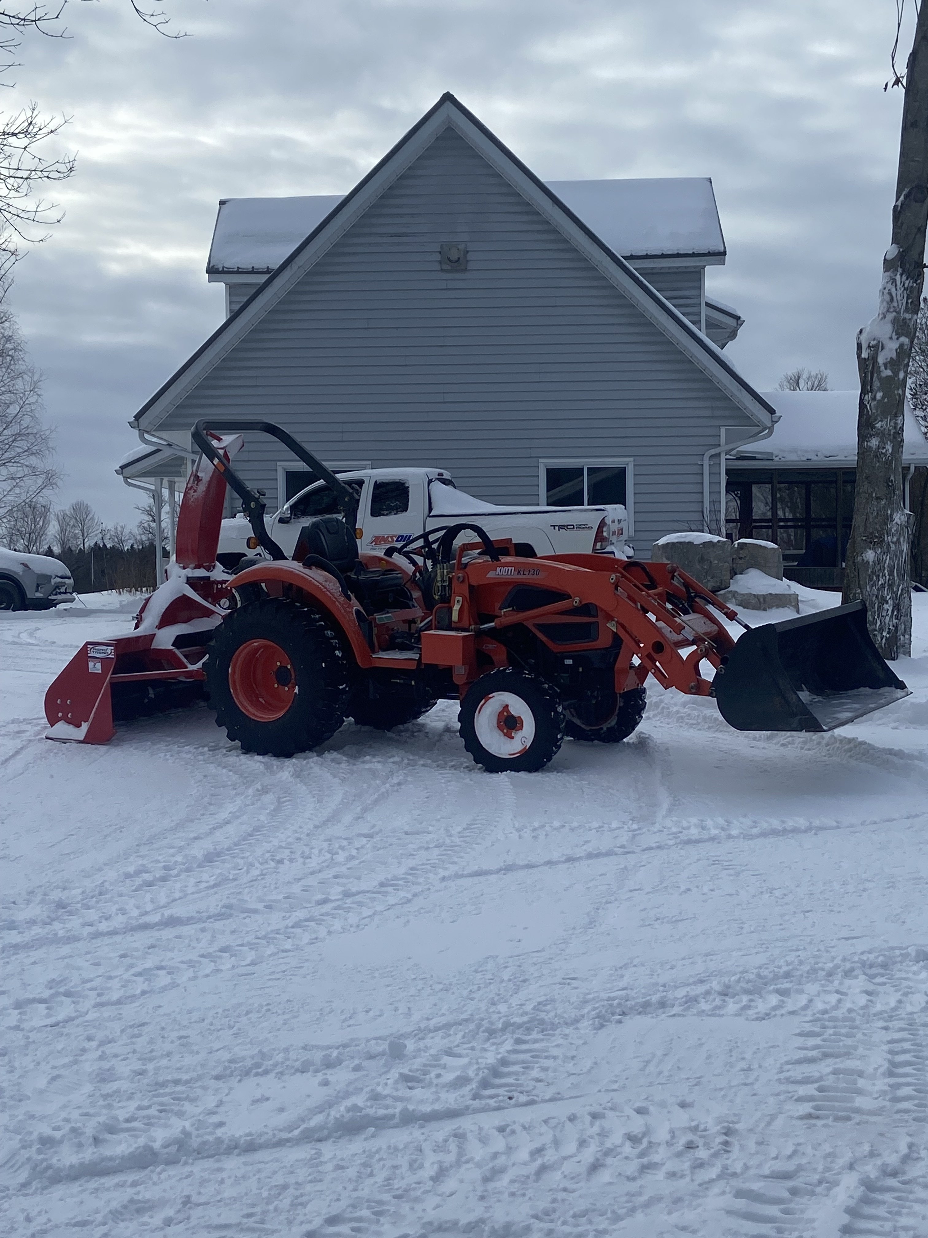

Myself I use the ATH in my Kioti CK30HST and JD X390 lawn tractor. My tractor operates like midsummer, even if it’s-20C. A quick 5 minute warmup and off I go to blow away the snow.
The hydro transmission in the JD doesn’t seem as hot after a grass cutting, although it does get warmer than I initially expected.
