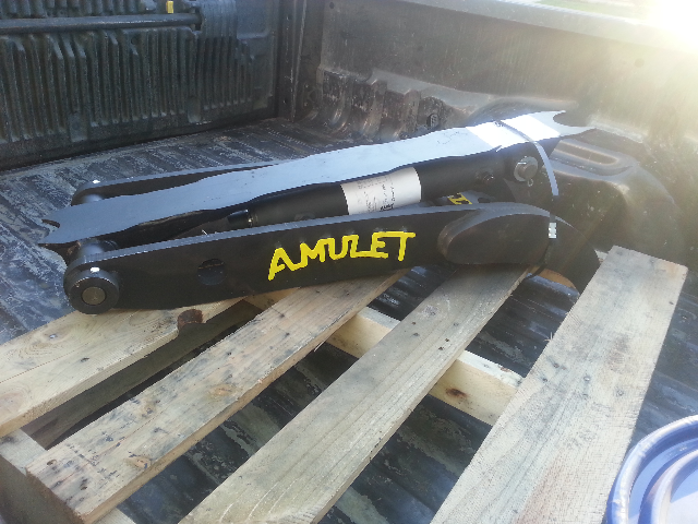

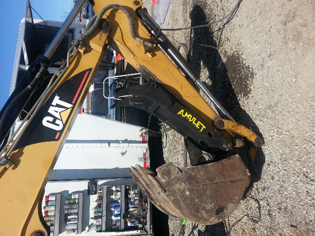

Picked up the thumb at the freight terminal this afternoon. Looking forward to putting it on tomorrow.

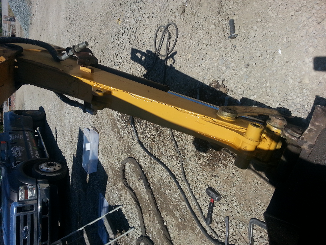

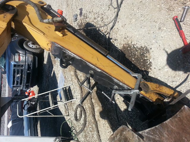

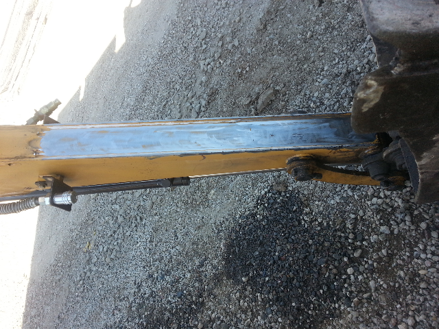

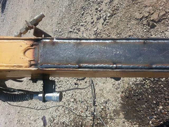

There are some pics.

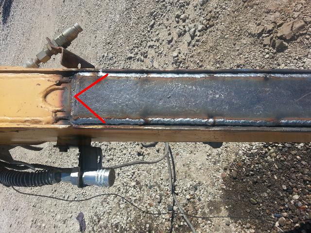

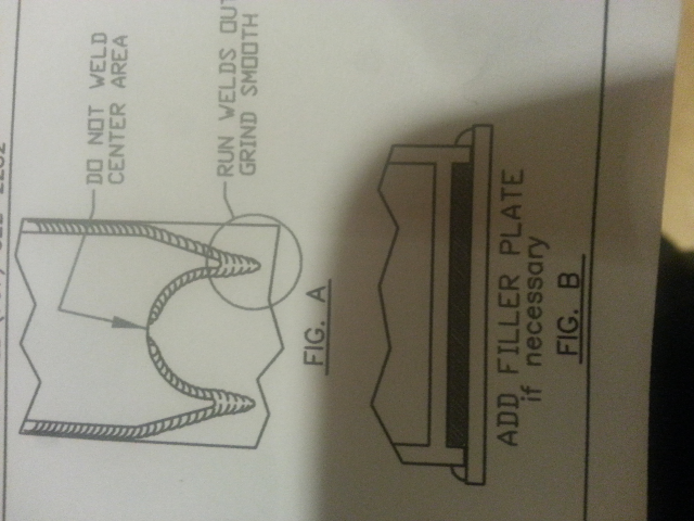

Because the width of the mount and the arm were neatly the same I had to add a filler plate so the mount had a solid surface to mount to.
Here it is mocked up.
Here's the mount clamped down and then welded on.

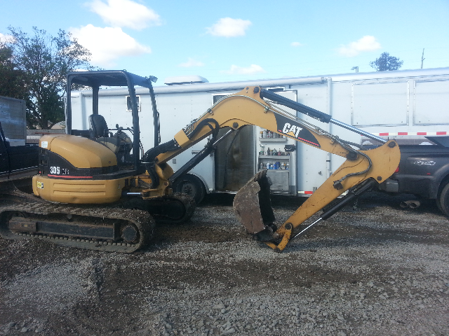

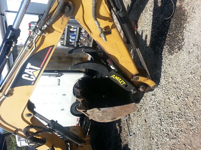

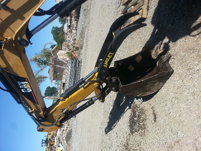

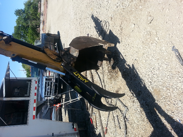

Here's a few with it all attached and with the hoses made.

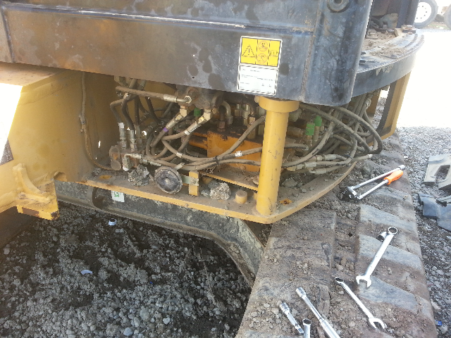

The last one is with the cowling off so I could adjust the overload relief.
Brian
   / Amulet excavator thumb #15

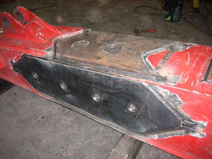

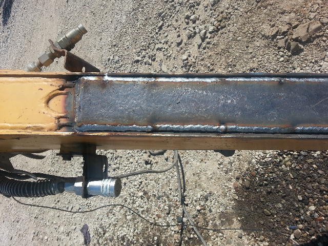

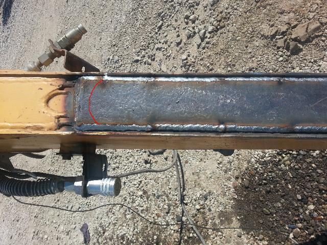

We may never know, but it would be interesting to see in the future if there is going to be an issue with you using 90-degree corners on that filler plate?
You see V-shapes, or radius cut fish plates used on excavators all the time. A good idea with V-shape fish plates is to tail out the welds like this guy did.

I wish there had been more room. The mount was the length of the arm if I had fishtailed the filler plate I wouldn't have been able to weld the ends of the mount. I guess I could have made smaller fishtails concentric with the ones on the mount.

Does it have it's own dedicated hydraulic valve/circuit?
Yes, it uses the auxiliary circuit on the excavator. All I had to do is make some short hoses from the existing quick couplers to the thumb cylinder. There was also a selector valve to switch the auxiliary from uni-directional to bi-directional. Even though the cowling came off to get to the valve bank, adjusting the overload relief was a bit of a challenge. It was tough to get to with all of the hoses in the way. The overload pressure was way off. It was at least 6000 psi and Amulet wanted it to be 2100 psi. The overload relief is what keeps the machine from bending or breaking the thumb or hydraulic cylinder when curling the bucket into the thumb.
