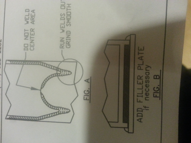

I couldn't decide which forum to post this in. I finally decided it was more of a welding job than anything for me. Anyway, I ordered an Amulet thumb for a customer's Caterpillar 305 CR excavator Friday. They have to build it and ship it to me. I expect to see it the coming Friday and put it on Saturday. I will definitely post pictures before, after, and during. It should be a fun job. The hydraulics are already on the machine so all I really need to do is weld the brackets for the cylinder and thumb, mount them, and make the hoses to the cylinder.
I quoted my customer $3000 for the job.

There should be instructions for welding the thumb brackets on. If it uses separate small brackets for the cylinder and thumb hinge pins, they can be welded all around. If it uses a large mounting plate with the cylinder and hinge mounts already attached, only weld on the sides lengthwise with the stick/boom. Don't weld across the top and bottom (across the width of the stick). That's an application where you could use Shield Arcs suggestion to put silicone seal across the boom to keep moisture from getting under the plate.

I have welded a little but in no way am I a welder. Why wouldn't you weld all the way around?

These are the welding instructions I have so far. We'll see if they send any more with the thumb.
It would add stress to the stick welding straight across it. The instructions show curved ends and also to leave a space un-welded in the middle. I'm sure Shield Arc could explain it better than I could.

Generally the reason is stress raiser. And the HAZ / Heat Affected Zone. That's why you see in really stressed area where fish plates are required, engineers will want a diamond or oval shape fish plate. With diamond shape fish plates its a good idea to tail out the weld like in brain55 weld detail he posted.

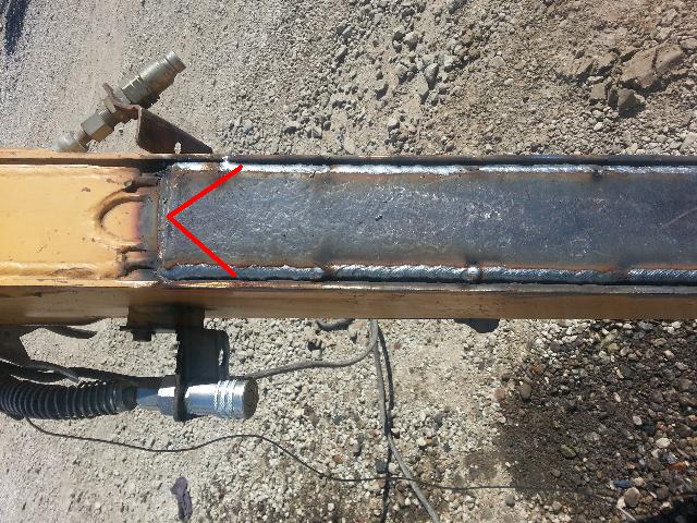

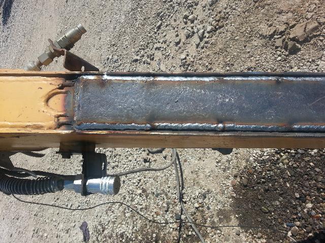

There are some pics.
Because the width of the mount and the arm were neatly the same I had to add a filler plate so the mount had a solid surface to mount to.
Here it is mocked up.
Here's the mount clamped down and then welded on.
Here's a few with it all attached and with the hoses made.
The last one is with the cowling off so I could adjust the overload relief.
Brian

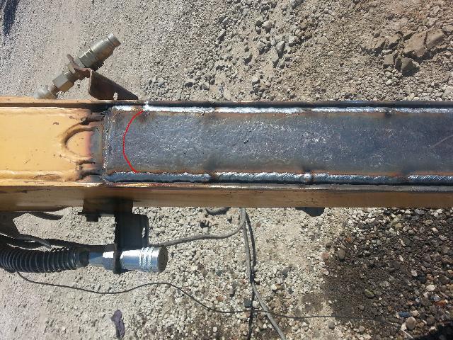

We may never know, but it would be interesting to see in the future if there is going to be an issue with you using 90-degree corners on that filler plate?
You see V-shapes, or radius cut fish plates used on excavators all the time. A good idea with V-shape fish plates is to tail out the welds like this guy did.

I wish there had been more room. The mount was the length of the arm if I had fishtailed the filler plate I wouldn't have been able to weld the ends of the mount. I guess I could have made smaller fishtails concentric with the ones on the mount.

Yes, it uses the auxiliary circuit on the excavator. All I had to do is make some short hoses from the existing quick couplers to the thumb cylinder. There was also a selector valve to switch the auxiliary from uni-directional to bi-directional. Even though the cowling came off to get to the valve bank, adjusting the overload relief was a bit of a challenge. It was tough to get to with all of the hoses in the way. The overload pressure was way off. It was at least 6000 psi and Amulet wanted it to be 2100 psi. The overload relief is what keeps the machine from bending or breaking the thumb or hydraulic cylinder when curling the bucket into the thumb.
