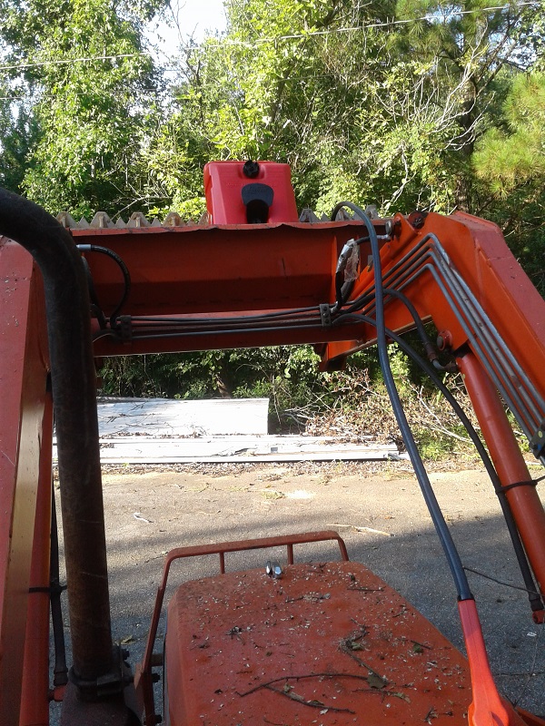

Remember to use a cargo strap to hold it in the bucket. Safety first.
I have a Duramax Flo N' Go 14 gallon that is gravity fed and I use the FEL to get it above the level of my fuel cap.
I also have a Duromax/Fel solution
Should I add a groundstrap?
Now why didn't I think of that, redneck fueling right there. If I would've done that 4 years ago I wouldn't of pulled my shoulder muscle on a nice winter Sat morning, I couldn't do anything rest of the day. If my electric pump goes that's what I'll do with my 5gal jug, 40 years ago I could've thrown that 5 gal jug over the tractor. You probably posted that pic before but I missed it that's why it's always good to keep posting the same picture here and there, thanks for the picture.
Maybe if it was gas a ground strap wouldn't be a bad idea, but diesel............

Might find reading on static electricity interesting on "Snopes".
   / An easier way to refuel your tractor #47
If you have no ground strap or are simply unable to provide an adequate assurance of grounding, place the fuel nozzle against the lip of the fill opening of the target fuel canister, this action may provide adequate static transfer...THEN place the fuel nozzle inside the canister to reduce the air space where static can be released prior to beginning the fuel transfer. A submerged fill tube is even better. The fill tube reduces the amount of vapors/foam generated - reducing the conditions where static electricity ignites vapors.
