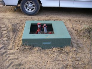

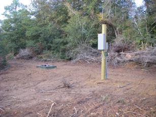

The Great Underground Power Massacree 3
"The Big Coverup
" continued, continued:

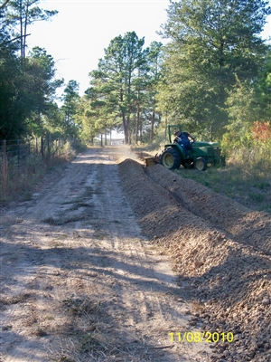

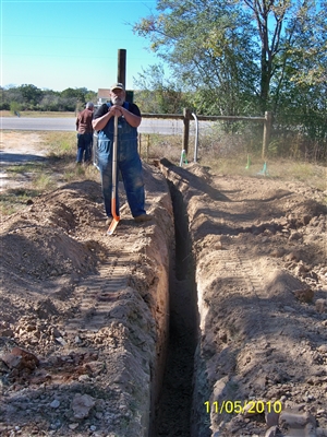

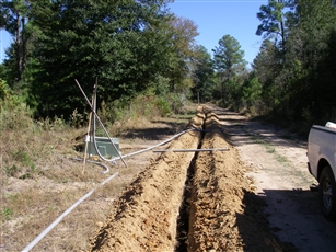

Delivery Dude was quite amused at my reaction to the "Little Yellow Digging Machine" he rolled off the truck...
You see, tho I have operated a lot of heavy equipment, the most modern track-hoe I ever touched had a cluster of levers in between your knees and two pedals...I've NEVER operated one of these new-fangled joy-stick jobs...and I gave him a pretty confused look when he handed me the key...
Delivery Dude was a either a very good teacher, or these machines are close to idiot-proof, because with about 10 min of OJT, in the time it took for him to load the trencher and chain it down, I had the darned thing hopping and bopping like I was born in one.
I cleaned up the front bit near the road crossing and then skedaddled back to the far end and finished up the segment from the transformer pad to the meter pole....and that made the trench DONE....!
I started putting conduit in the ground....the section from the meter pole to the pad was already glued up, so it was in the ground in a flash....
Then it was a matter of gluing up a tube-turn and lowering the pipe into the trench....and by the time it was getting dark, I made it to the junction box pad, halfway to the road-crossing.
I slept deep that night...
After my usual "working" breakfast of a bowl of tylenol tablets in yogurt washed down with black coffee, I got back over to TOGR...
The mornings have been pretty cool the last week or so, and the trench is so deep, it puts a pretty severe angle on things as the pipe goes into the ground, and rather than risk cracking a glue joint or even the pipe, I figured I would bury the pole to transformer segment and round up some shoring boards for the conduit ends while things warmed up a bit....
...the inspector requires the last couple of feet of each segment be left exposed to verify depth, marking tape and that a long sweep 90 was used to make the tube-turn so shoring of some sort is needed to keep the dirt away from the ends of the conduit, and I have plenty of half-rotten old fence pickets and scrap lumber in my materials pile for this sort of thing
By the time I had put in the shoring at the transformer pad and meter pole and then buried that section of pipe, it was warm enough to put more pipe in the ground.
I had to do a little "adjusting" by pulling the pipe a bit with a come-a-long to get the spacing between the front and rear conduit runs where they met at the junction pad to sit just right...but I am only going to do this ONCE....may as well do it right.
I have this bad habit of following engineering drawings as close as reasonably possible...but I am sure the engineers had a good reason for spacing the risers they way they did...
The longest run of continuous pipe was from the junction to the road crossing, and it slid into the ground slick as a cat on ice....by late morning all the pipe was in the ground, the junctions were shored up and I was ready to backfill.
Just one thing I had to do before that tho....Delivery Dude was going to be back for his excavator, and there was NO WAY I was going to let that thing go before I rescued my auger from it's current sad state!
I got hooked up and tried to simply pull it out the way it went in....and nothing happened....
I heard the deer laughing at me....
So...drawing on my vast stores of construction / destruction experience, and my newly acquired operating skill with this wee digger, I slapped the boom around and yanked every-which-way until I saw some movement....and then wrenched the auger right out of the ground...
It left a nice post-hole too...
That'll show those snarky darned deer...

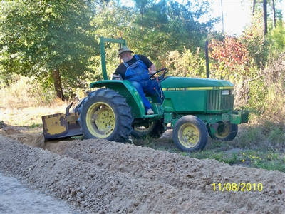

So...With that annoyance taken care of, I ran the excavator back up to the front of the property and parked it for Delivery Dude.
If I should happen to have an extra $20k laying around, I have GOT to get one of these!!!
The afternoon was spent looking over my shoulder as I pushed half of the fill back into the trench, and strung out the warning tape...
The "Little Green Giant" made it all very easy....even without a hydrostatic drive, the gear-box on this machine is so smooth, I got into a nice rhythm pretty quickly....and by quitting time, all the tape was down, I had completely backfilled and smoothed out the front half of the driveway and I was beginning to feel good about the progress again.
Neighbor Joe dropped by and told me he was going to nominate me for Road Commissioner....he said anyone who can smooth out a driveway that nicely with a box blade and a piece of old railroad track on a chain ought to be able to do some good....
Joe is nice like that....

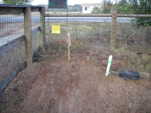

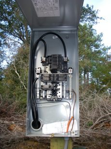

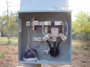

The wiring went in "..quick like a bun-yay...", as Marcel Johnson used to say...the full-sized box had plenty of room for the big wire...
I buttoned up the boxes and wandered up to the front where I fired up the little yellow digging machine and dug some tree-planting holes that me and Precious Bride had staked out earlier so they could weather a bit before she planted in them and then cleaned some brush and debris away from a spot we want to put a gate in for a drive-thru in the front-most pasture...
Good fun....
Right about the time I was creeping out of the woods, Delivery Dude came rolling up and I bid a sad farewell to my new little buddy...
The excavator....not Delivery Dude...tho I am sure I will be seeing more of each before it is all over...
With all the lessons of the pan-delirium of the past few days in mind and with my deployment rapidly approaching, I figured I better just sit on my hands for a while and wait for Joe the Inspector....
The deer were no-where to be seen...
Foo..
Right at the appointed time, Joe the Inspector and Bubba High-Tension rocked up in their pole-truck....
Each transformer pad, the terminus at the road-crossing and the wiring at the meter can all received a nod of approval....
And suddenly the torment was over....:eek:
