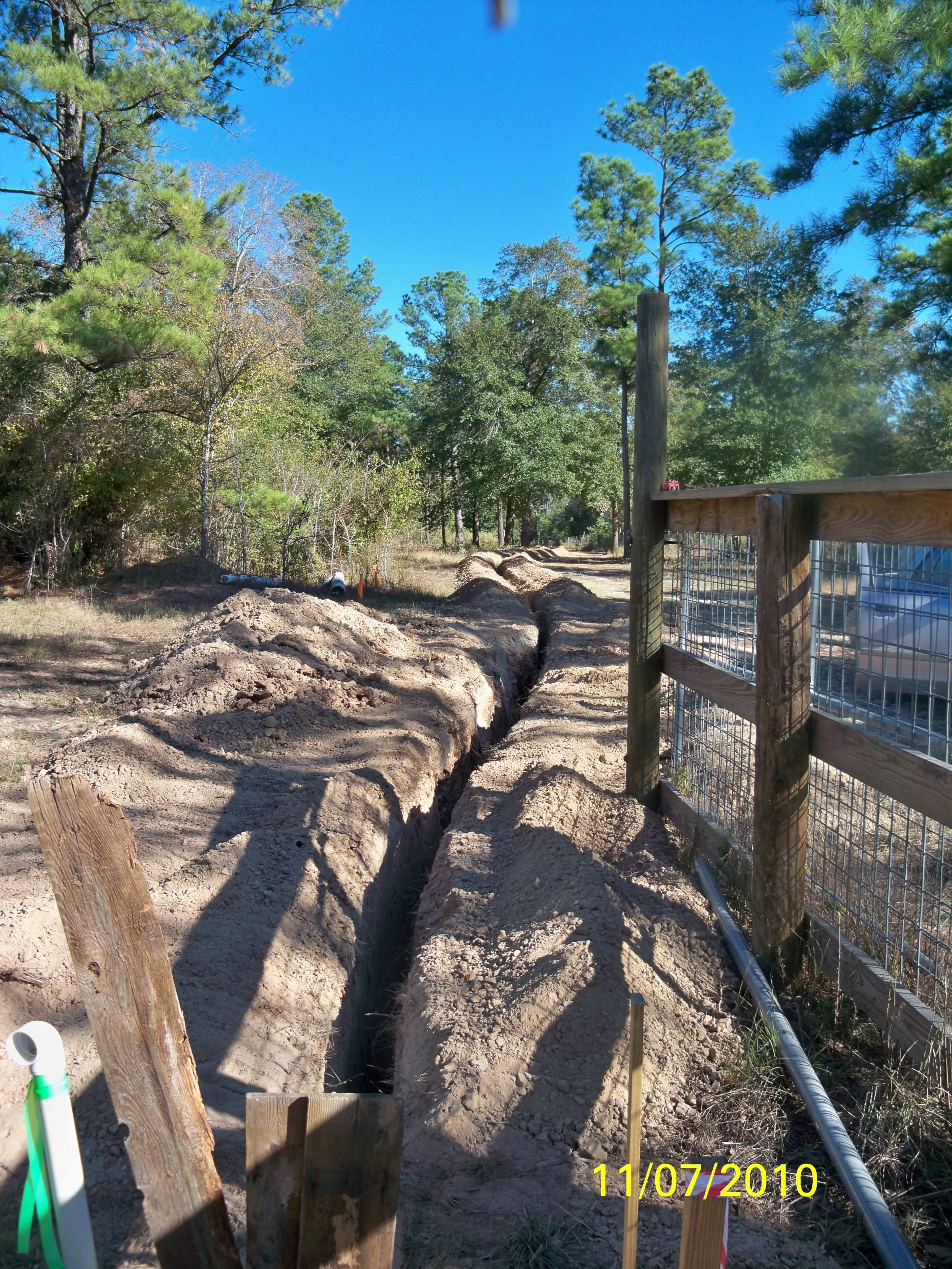

The next morning we headed over to TOGR and sure enough, the flags and stakes for the road crossing were in place.
I called in my request for digging clearance from "Texas One-Call", tidied up a bit...got the conduit out of the path of the trench...cut down some brush that had grown up in the last month...not a lot to do without a clean dig permit...
So...PB and I had a bit of a relaxing weekend with the In-Laws....went and located a well stocked equipment rental yard in College Station and set up a trenching machine with a 5 foot stinger...puttered around town a bit....sort of the calm before the storm...
As luck would have it, PB had to return to the Coast and her job....seems they NEED her to help count all those beans....so we headed back down south...another delightful ride, but it's just too bad she is going to miss all the fun...
Well...there will be a lot more pipe needing to be buried....the electrical lines to the house pad and the barn, water lines and another conduit for communications...she will get her chance to dig in the dirt...

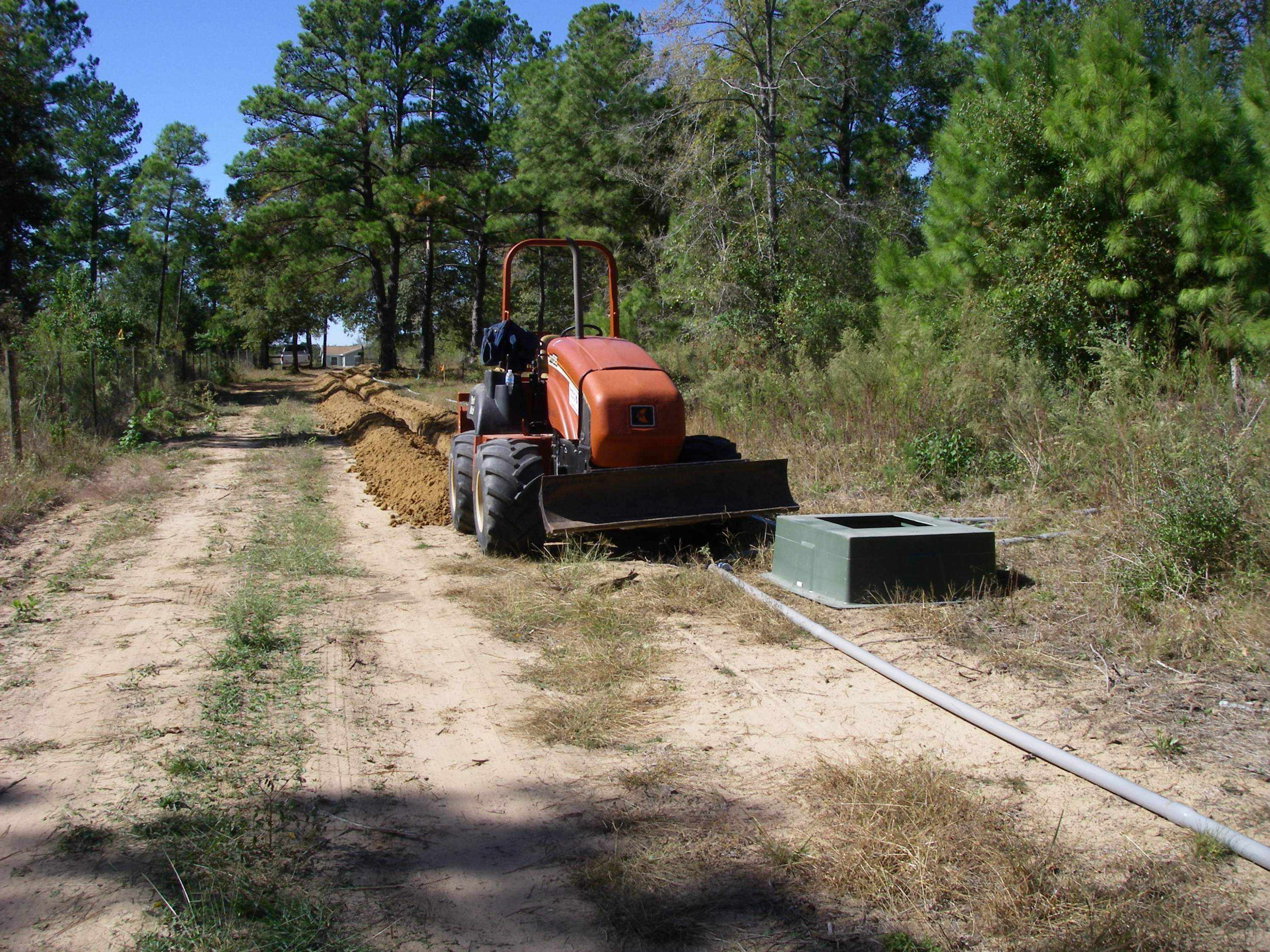

This time, when I passed thru Navasota, I picked up the transformer and junction box bases from the Commissariat of Power...the yard-man showed me the transformers and such...
The bases resembled nothing so much as big green fiberglass flower boxes...and when the transformer and junction boxes are bolted on, they will look like olive drab refrigerators....
I can see Precious Bride painting some flowers on them or something....

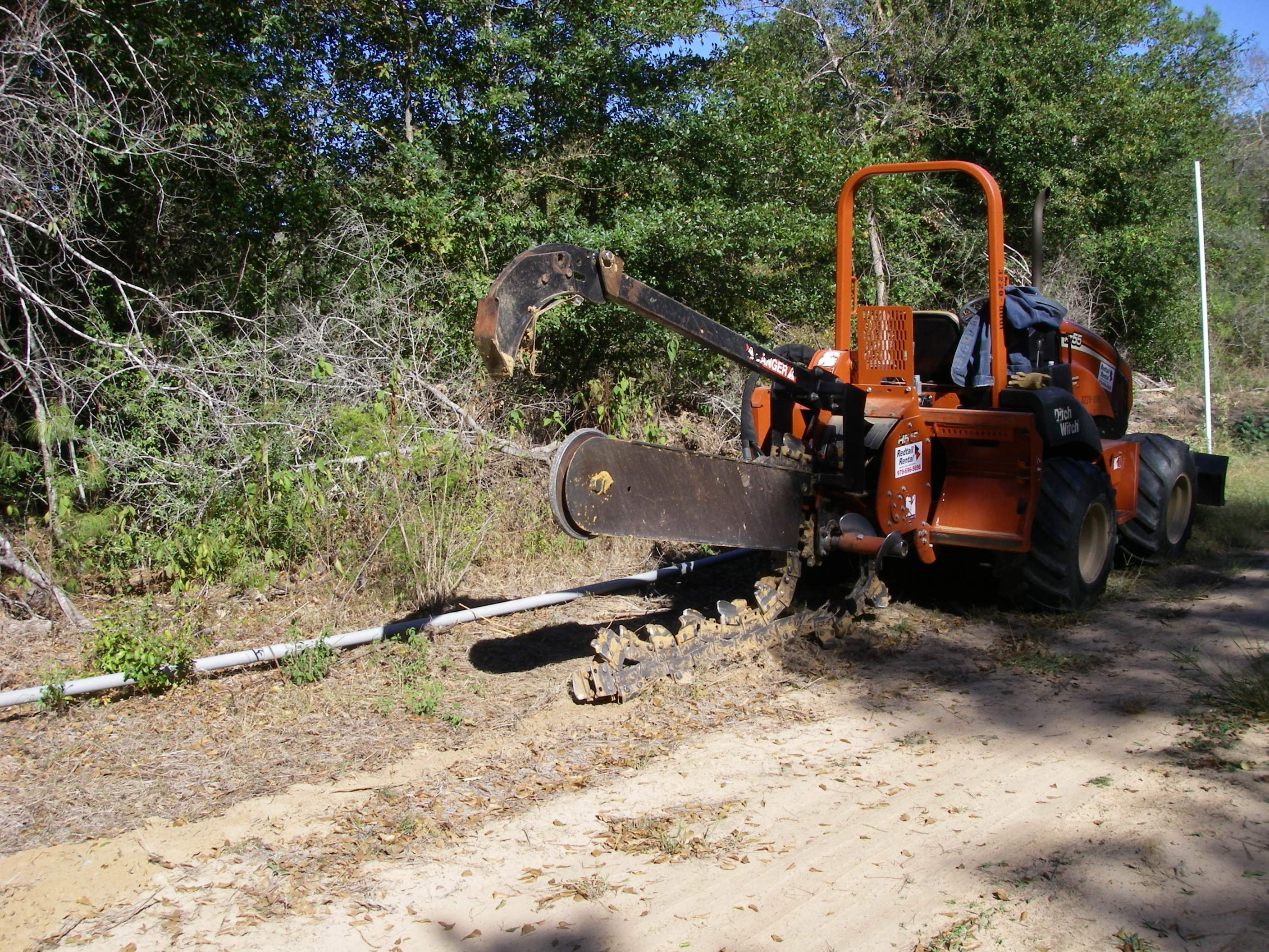

The next morning "Locator Dude" was good at his word....right on time....and as promised, marked up the site and authorized a dig permit right from his truck.
The guy apologized about a thousand times while he did his thing...and during our discussion, I discovered that there seems to be quite a bit of new construction going on...not bad for a recession...
Anyway....once I waved goodbye to "Locator Dude" I busied myself staking and flagging the water-main running across the front of the property so the line-crew doesn't park a bucket truck on it...

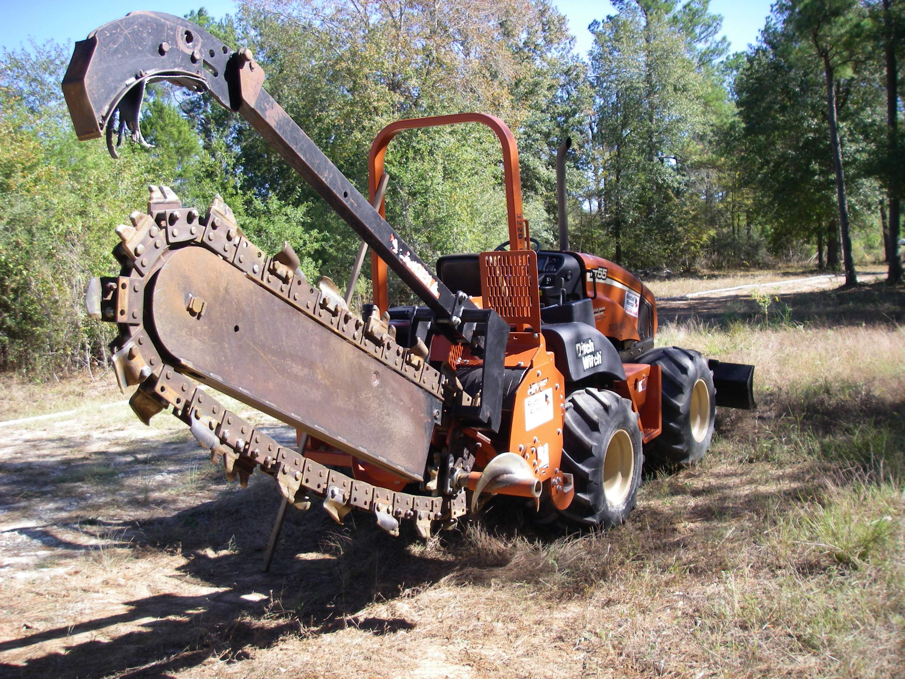

As requested, the truck bearing my trencher showed up about noon....
After unloading and inspecting the unit, I discovered that the rental yard had disconnected the "auto-pilot"....it seems users were engaging the thing and then dismounting the machine...and getting into all sorts of mischief...!
Well....never having run a trencher this big, and paying a premium for this one....I had sort of hoped to have all the bells and whistles...but....I can cope.

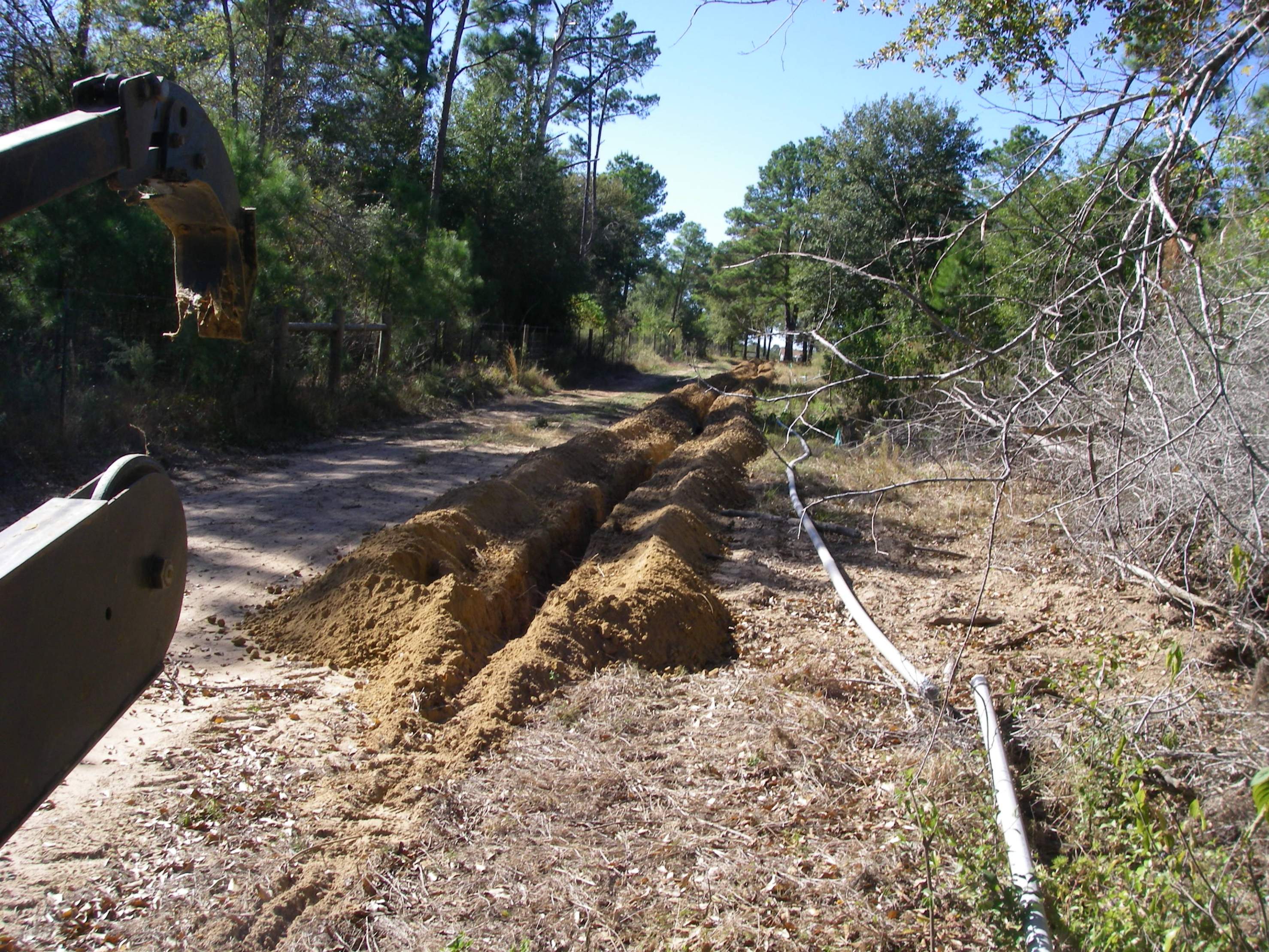

I waved goodbye to "Delivery Guy" and fired the trencher up....moved into position at the front fence and lowered the stinger into the ground....
The thing is a monster.....!
The sandy clay in this side of the property has had all summer to bake into the equivalent of a fire brick....you need to loosen it up with a pick just to stick a shovel in it....but the chain on this trencher has carbide inserts on every tooth, just for this sort of thing....and tho I had to be very careful with my speed to avoid overloading....it chewed thru the hardened ground beautifully....with the stinger down as far as it could go, the machine was churning out spoil so fast the augers had a tough time kicking it all to the sides....but the fines that filtered back into the trench wound up making the equivalent of a nice sand bed at the bottom....
This is definitely the right machine for the job...

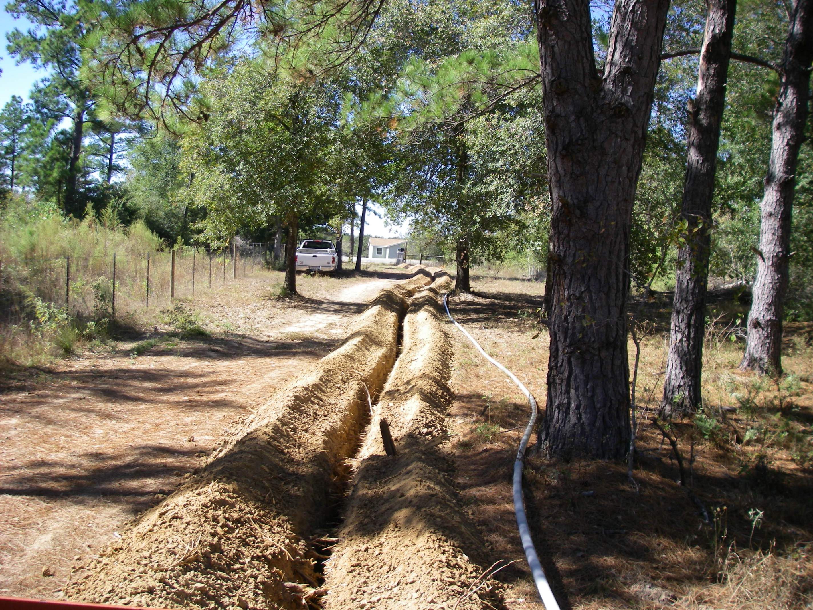

I steered on down the driveway....experimenting with the controls until I got everything spinning in greased grooves....my flags on the fence showed I was ticking along at around 250 feet per hour...
That doesn't sound like much when you are sitting on top of the machine watching fence posts creep by....but it beats the **** out of what I might be able to do with an excavator....
I neared the first area I felt might be a problem....I had to cut pretty close to some large oak and pine trees that flank the driveway....beautiful things that are part of the reason we chose to go underground....
But aside from having to slow down a bit to let the teeth chew thru the dense tangle of surface roots and having to back up a couple of times and stop while the teeth chewed thru some deep tap roots....everything went along just fine.
The lack of an "auto-pilot" meant I had to pay a bit more attention to the hand throttle, but it was not really an issue....
Having passed the trees, I figured it would be smooth sailing until I got to the Big Curve...and it was...for a while anyway...
I was ticking along, minding my own business, enjoying the mild afternoon and congratulating myself on my excellent choice of equipment when barely 10 feet short of the start of the Big Curve an impressive "CLANG!!!!" and then grinding split the air and rocked the machine, causing me to pull the Emergency Shutdown....
When the dust cleared I discovered that I had slung the chain off the guide bar....
Now HOW I did this was a mystery....as you head into my property the soil gets sandy-er as you go, and the area I was cutting was far from any trees or such things.
Checking the trench did not reveal any roots, previously uncharted well-heads, pipes or cables, buried trash, rock ledges, Jimmy Hoffa....NOTHING but dirt....
Oh well....it was getting late in the afternoon, so I called the rental yard and we agreed that if they would cut me some slack on the pickup time tomorrow (I only rented the machine for one day) I would be happy enough to see their mechanic first thing the next morning.
They agreed immediately...nice folks...
So I shut it all down and headed back to MIL and FIL's for the evening....a little saddle-sore but pretty well pleased with the progress thus far.

Terry, I don't know about your machine, but the older models I have rented all used grease to maintain chain tension. If that is the case, they should have told you to keep plenty of grease in it to keep tension on the chain. You just raise the boom and pump grease until the chain tightens right before your eyes. Maybe the newer ones have an improved method.:confused:
   / An Old Goat Ranch in Texas
#100
You are ABSOLUTELY correct, Chief....the small stuff uses screw jacks of some configuration like a big chain saw, but this big boy has a hydraulic ram built into the boom that is connected to a grease zerk under a screw cover located at the side.
According to the rental yard, this setup is supposed to maintain tension automatically....but we all know a lot of things that are SUPPOSED to work but don't...
