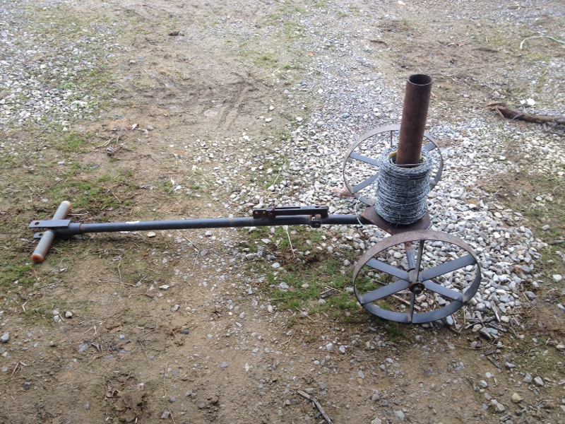

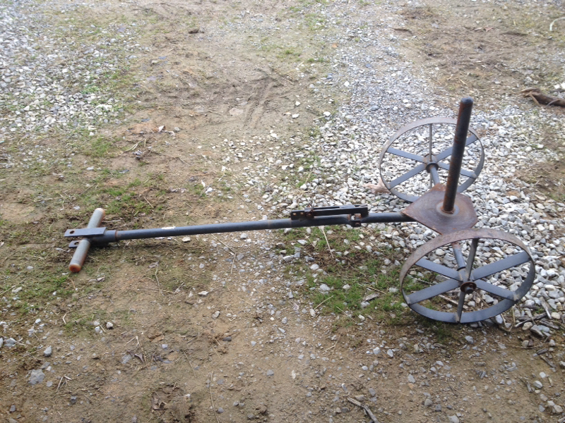

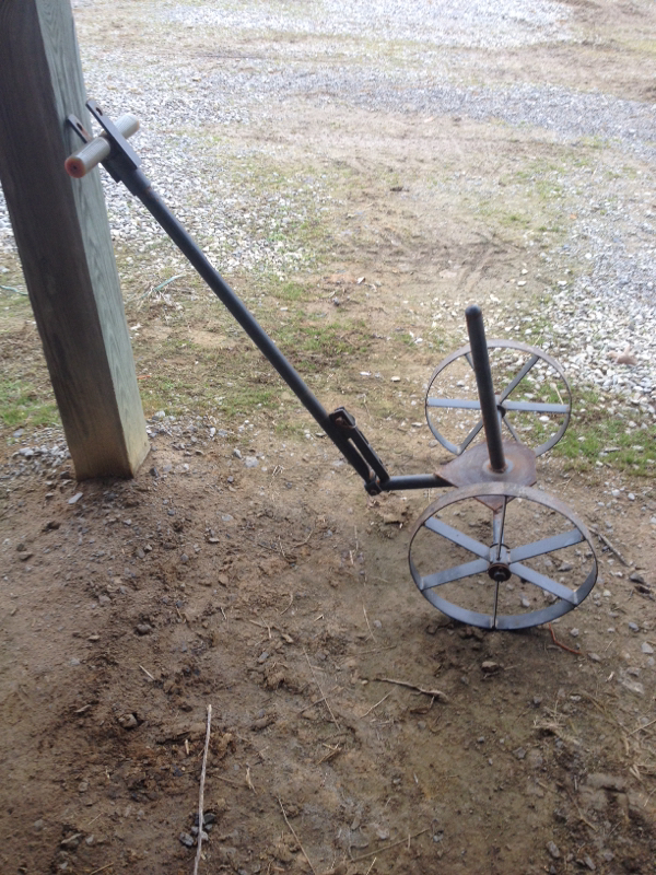

Eddie. Have you ever seen one of these. It's what I unroll barbed wire with. It can be a walking job or pulled behind an ATV. One of the pictures has an extension in it. It's an old metal pto guard. It keeps the wire from tangling when we get down to the last few winds on a roll.

Sorry for the multiple post but this app locks up if I try more than one picture per post.

View attachment 408411 Sorry for the multiple post but this app locks up if I try more than one picture per post.
That is a VERY clever wire spooler!! I use a piece of bent re-bar that I hook thu the spool and then drag the spool along the ground. It's a bit herky-jerky... this widget looks like smooth sailing...
   / An Old Goat Ranch in Texas #595
Terry. Thanks it was bought about 10 years ago. It has paid for itself many times. It unrolls very smoothly. Just have to watch the start and end of the rolls. Sometimes it wants to get tangled at those points. But I think a lot of that is in the rolls.
   / An Old Goat Ranch in Texas #596
That's a great contraption for taming a spool of barb :thumbsup:
I poke a broom handle through the centre and get a friend to hold up the other side while we walk it out.
Eddie, you still look to be young and fit so I don't think you will have any trouble with the rolls of stock fence for 20 acres.
You can just lay a roll on the ground, tie the end to the start of the fence line and then push out the roll with your boot.
Very easy on flat ground and simple too on a hill if you start at the top.
If you haven't done fencing before, take care with the loose ends. You would think barbed wire is worst, though straight wire can also flick up and go for the eyes.
It can be tempting to use a tractor at every possible occasion, but when fencing I would only ever use the tractor as an anchor point for straining the wire - not for pulling it tight.
Maybe one of the new fancy JD's that has buttons on the fender to inch forward very slowly would be ok though.

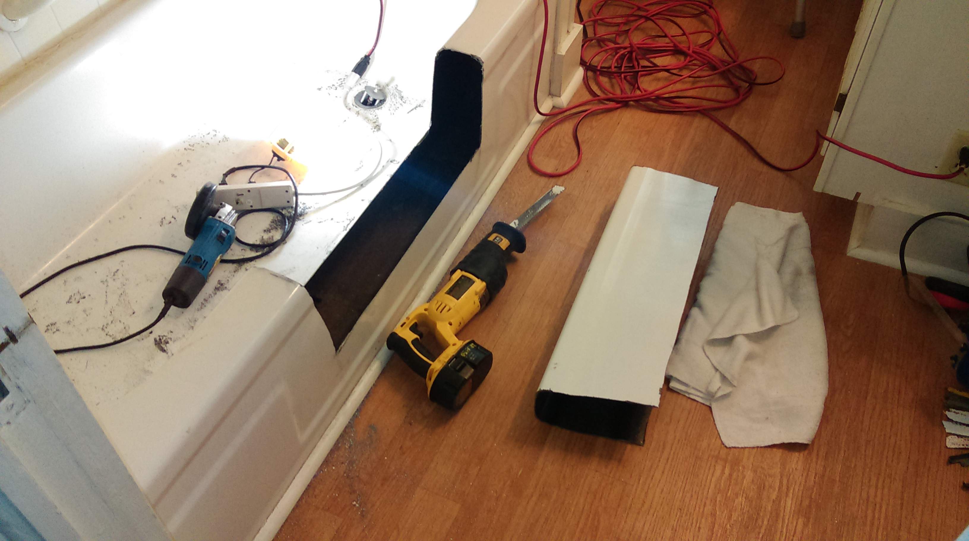

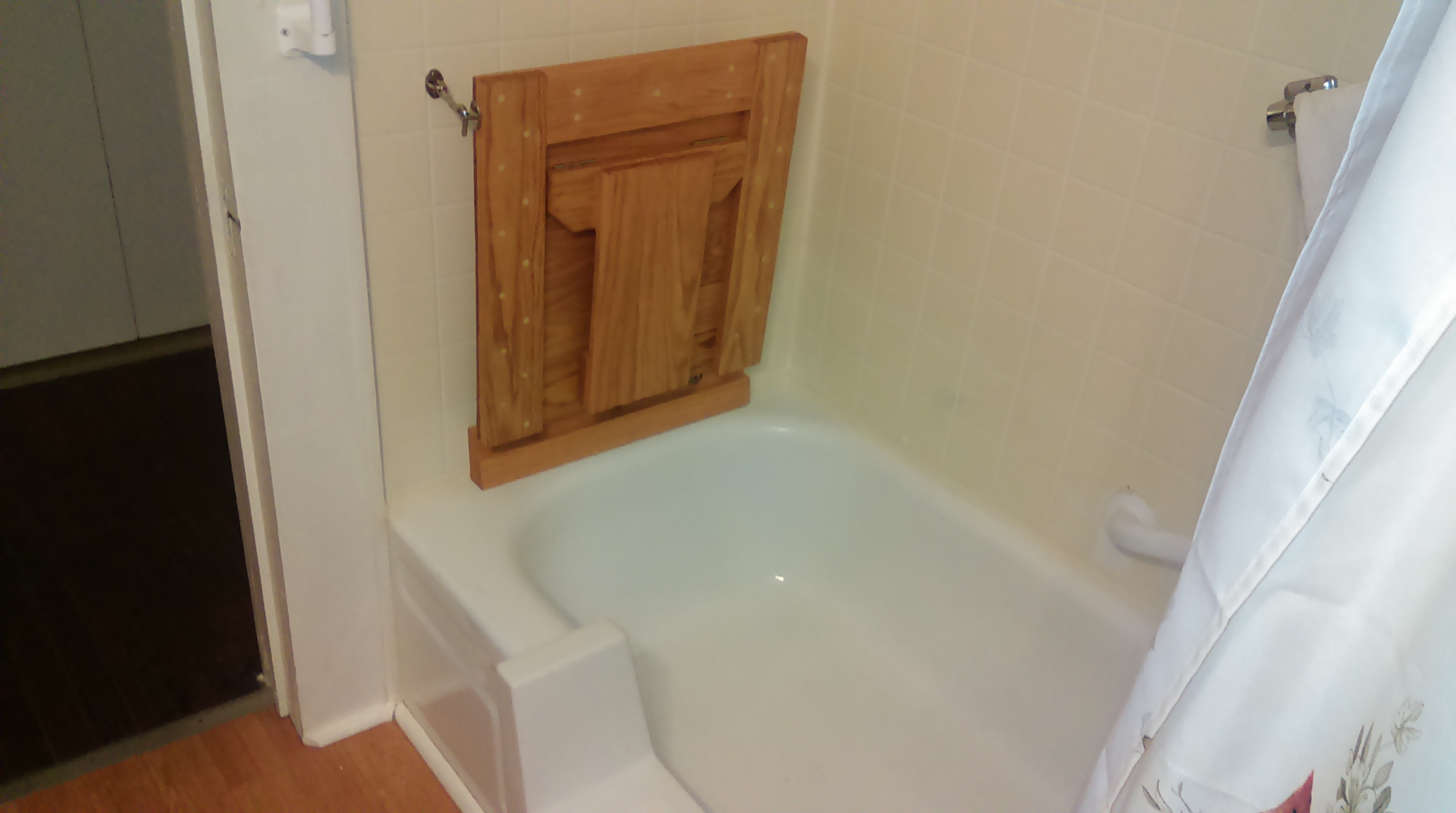

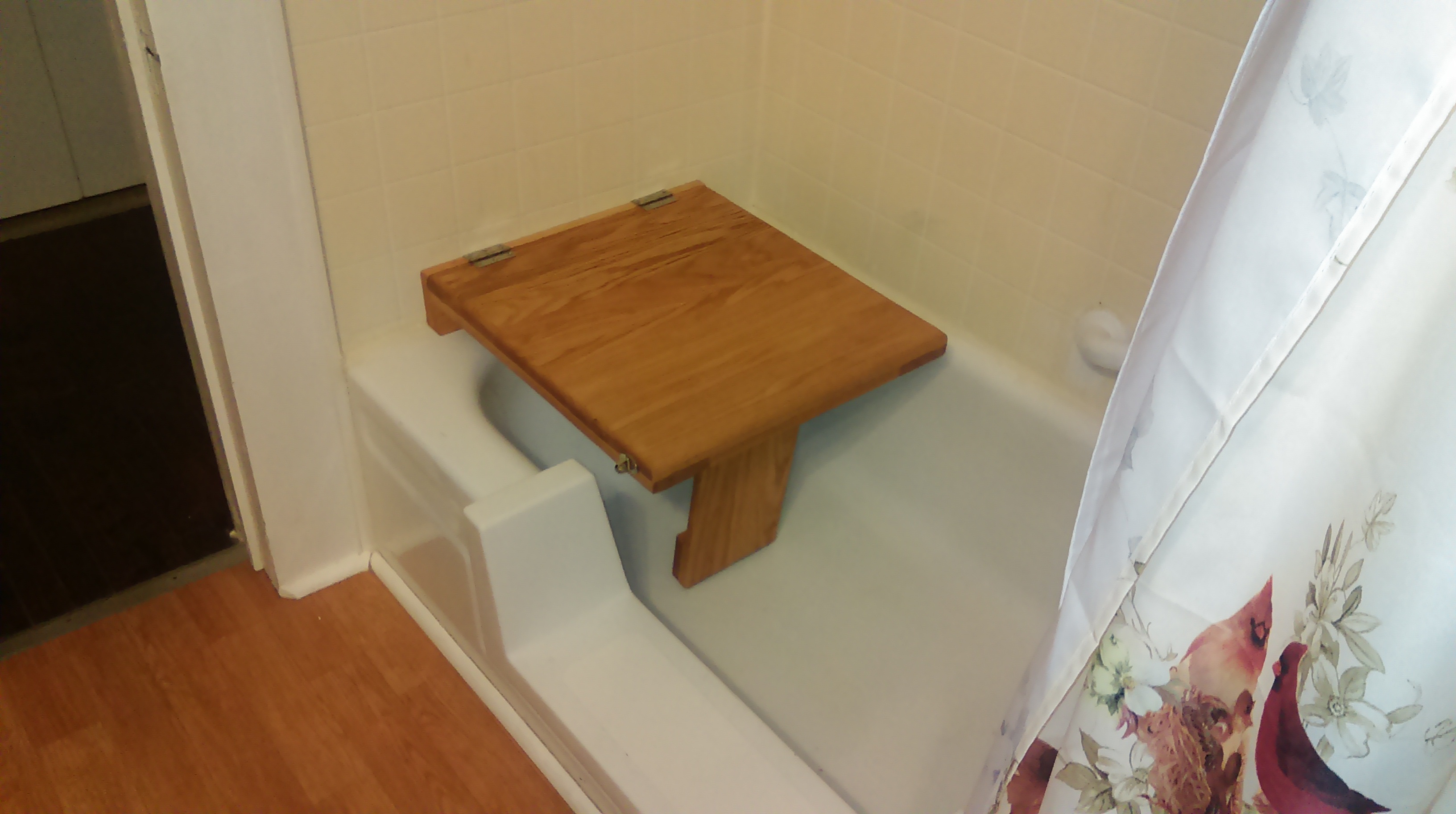

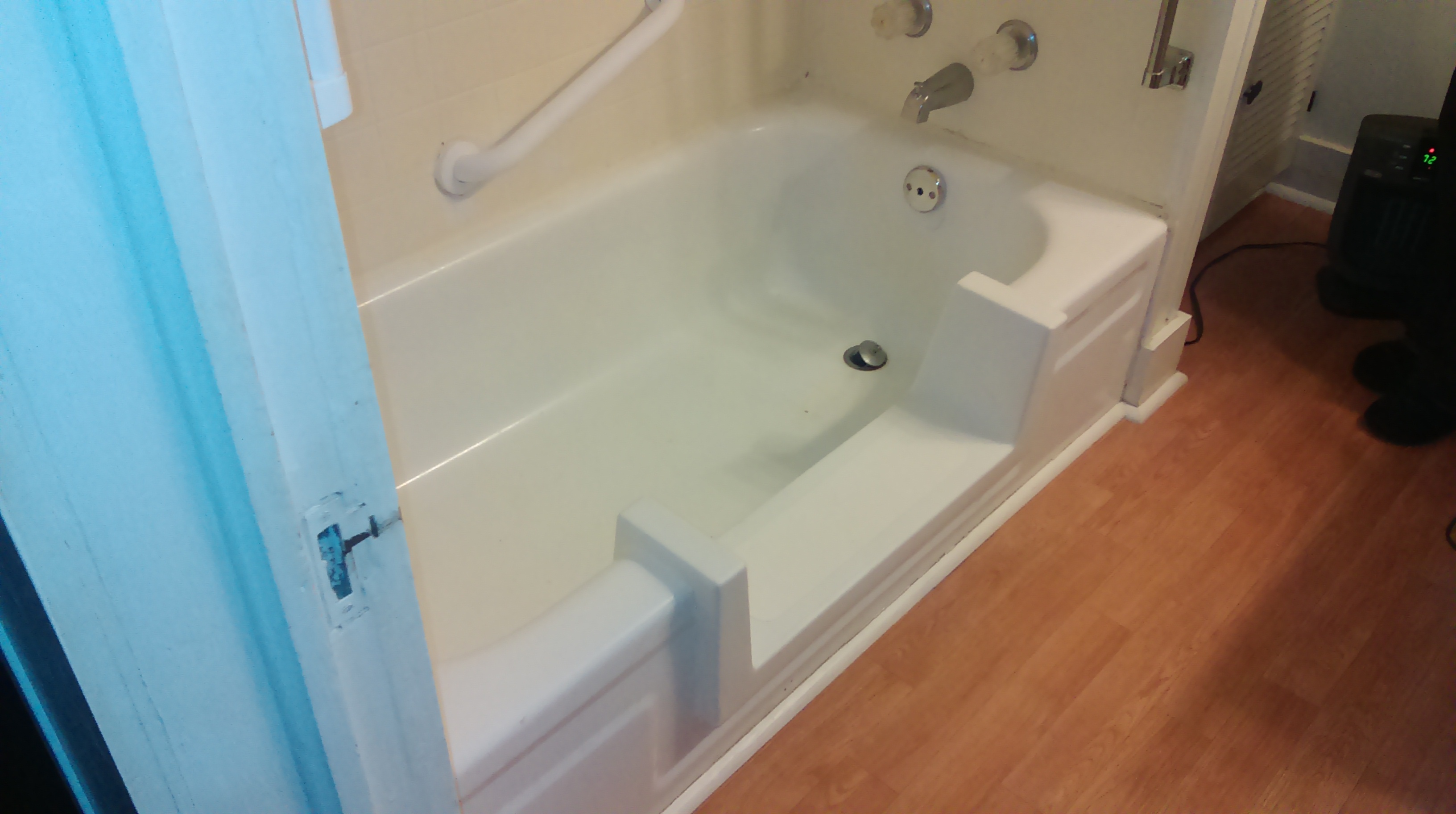

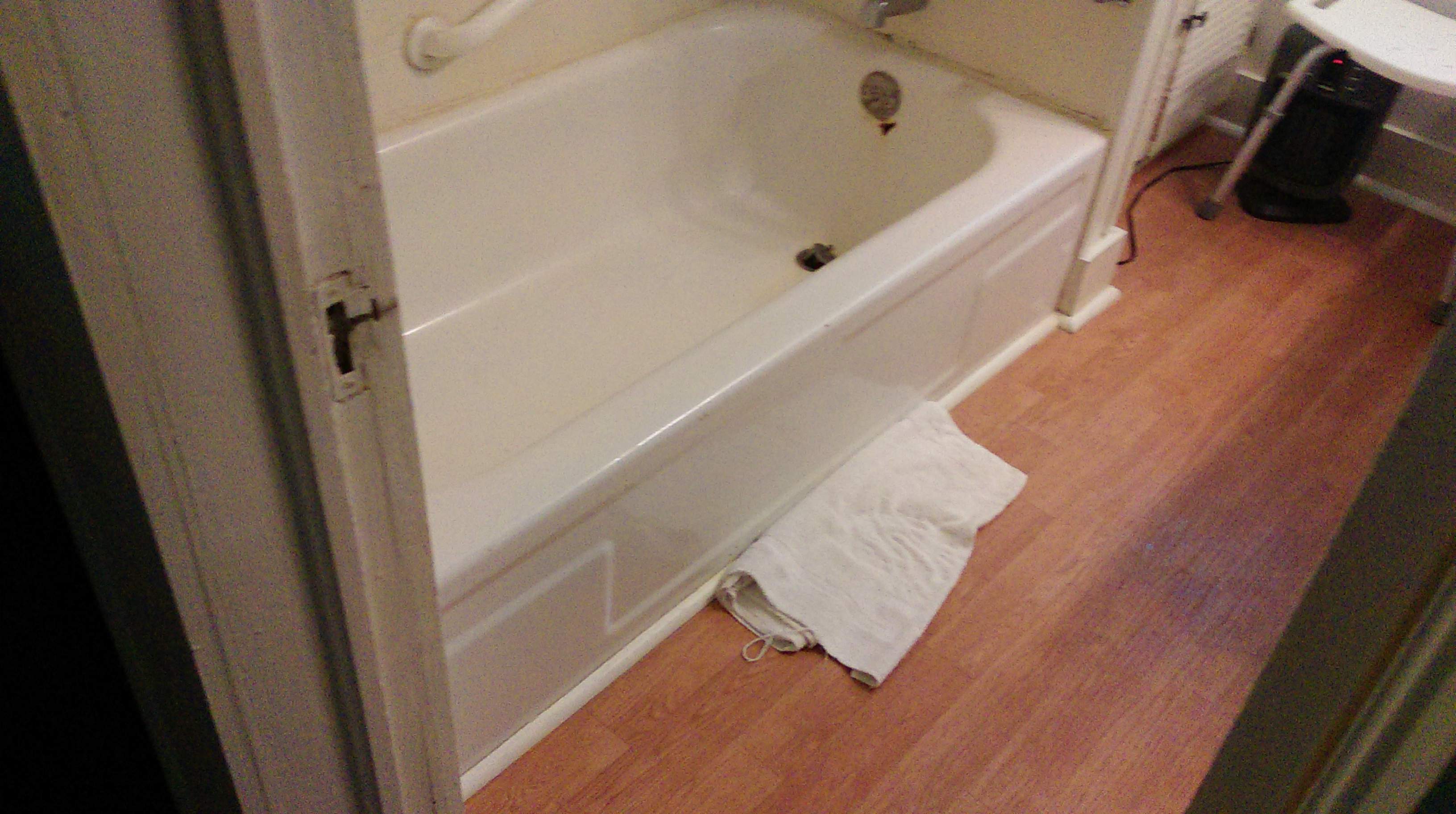

One of the prime reasons to move from the Coast to Bedias is to help my in-laws maintain their independence and I have been picking away at their house and grounds a little at a time to help that along
Bathtubs, as nice as they are for more nimble folks, turn into dangerous obstacles as mobility and balance decline. So I was planning on rehabbing MIL and FIL's bathroom by ripping out their tub and replacing it with a tiled shower stall, and repairing / refitting the rest of the bathroom as needed or what I estimated to be about a $4,000 endeavor.
However when word got out amongst my vast network of fellow DIY-ers, some sweet info filtered back there are kits out there that allow you to cut a door in the side of your tub, and eliminate the tripping hazard without having to tear the place apart.
I investigated a number of suppliers and settled on one... purchased their kit and a bottle of clear anti-skid coating for the floor of the tub as well and the results speak for themselves.
The kit went in beautifully, the non-skid finish is excellent (it replaces those "non-skid" mats and those nasty self stick things PERFECTLY) and the total cost for the supplies was under $500. You can even get a plug for the thing to allow the tub to be returned to use a tub
I also shopped for a bench to finish up the job.... give the Gammer and Gaffer someplace to perch while bathing... I was very unimpressed with the stability and quality of the assistive chairs and tub seats available.... they are all tippy and rickety... as much a hazard as the tub they are supposed to "improve"... so I built a nice folding oak bench that I have bolted into the wall.
No tipping or slipping here... and you can use it as an engine stand if you need to do some work on the tractor...
Thus far the in-laws (AKA the "Happy Bottom Bathing Society") report absolute satisfaction with the job and no splinters from the bench.

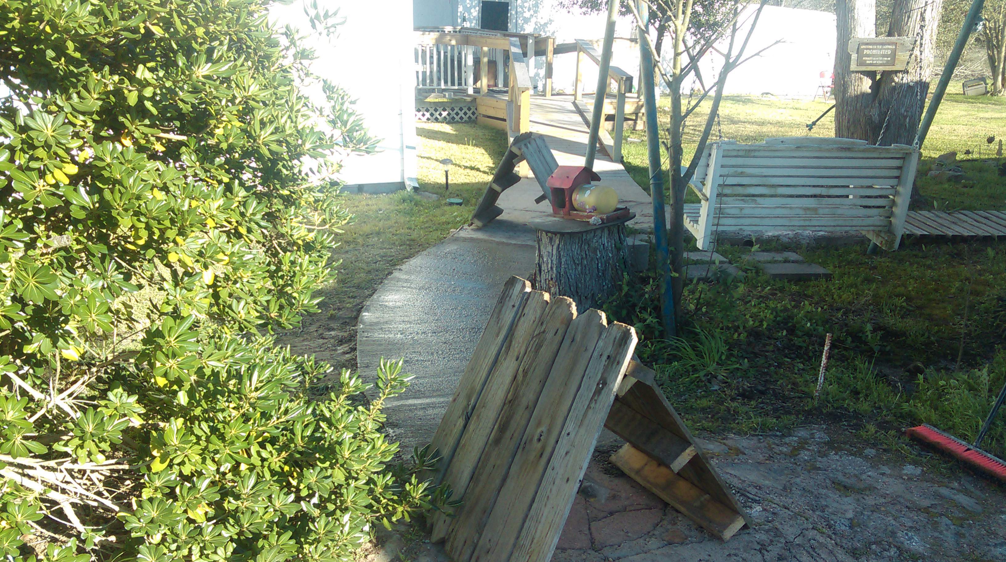

The Skateboard Ramp I built for the Gammer and Gaffer around their small back porch has been making life a lot easier... no stairs to negotiate and you can even use a small wagon to help get groceries etc in and out of the house and outbuildings.
Unfortunately, there was still a particularly rough piece of side walk between the ramp and the garage that was a potential death trap... beautiful river rocks that would get as slick as snot on a doorknob with any moisture at all, a light dew made 10 feet or so of walk absolutely lethal so, beautiful or not, it had to go.

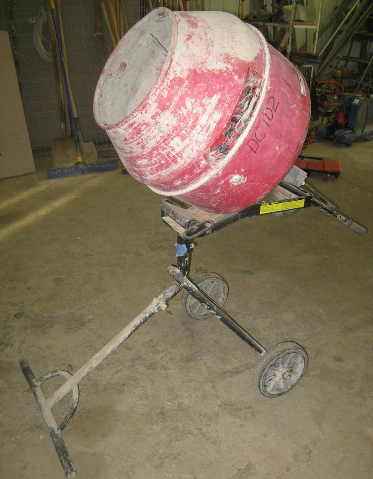

One problem begets another, so before I could fix the sidewalk, I had to fix a problem with my equipment.
Small batches of concrete are prohibitively expensive out here in the Middle of Nowhere... less than a full truck gets charged a "short fee" plus the usual mileage on top of the cost of the mud... so owning a small mixer is just a Good Thing.
As usual, when I need to own a piece of equipment, I turn first to Precious Bride, who, once charged with a Mission, will circle buzzard-like over Craigslist until she zeros in on a Good Deal and true to form, she found a nice little electric mixer for an embarrassingly low price.

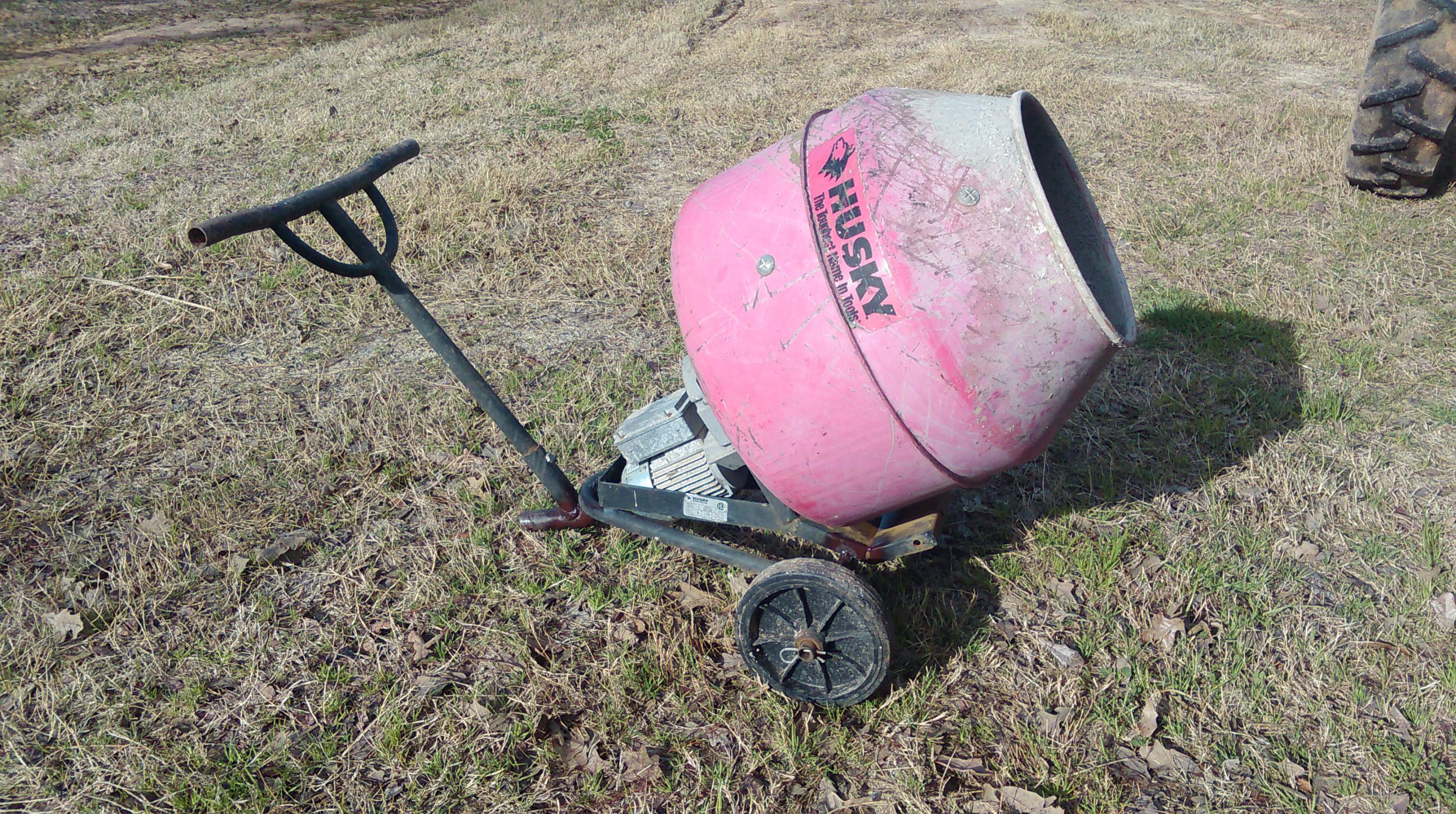

It just took one bag of mix before I found out why the price was so low... the **** thing is on a high pedestal and once you have a bag of ready-mix spinning in it, the laws of Physics turn the spinning drum into a top-heavy howling juggernaut of centripetal forces just waiting to tear somebodies lower back into shards.
I have been looking for an excuse to change that for some time now...
I broke out the cutting and welding gear and made me a Low Rider (cue the music)
https://www.youtube.com/watch?v=-xTGrfs5TXM
So with the mixer all New Improved Minty Fresh etc me and Charles my Right Hand waited for a couple of clear days, busted out the old walk and replaced it with some nice flat concrete.
The "Presentation Grade" stones from the old walk were saved and stockpiled for some future project... you never know when a nice smooth river rock will come in handy.
When it was all done and dry, the In-Laws now have a straight shot from the kitchen out to the garage with almost no speed-bumps and this is a Good Thing.

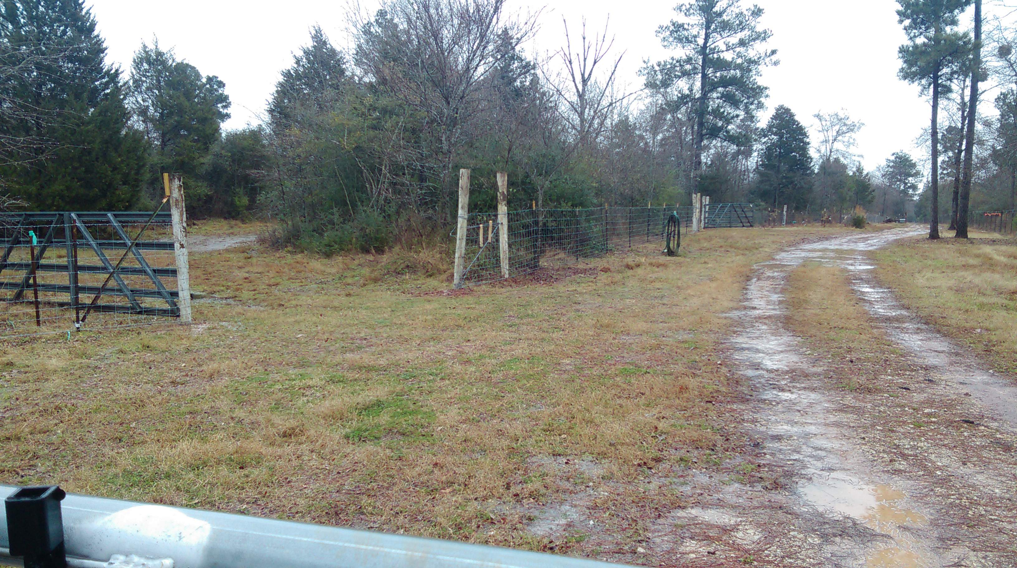

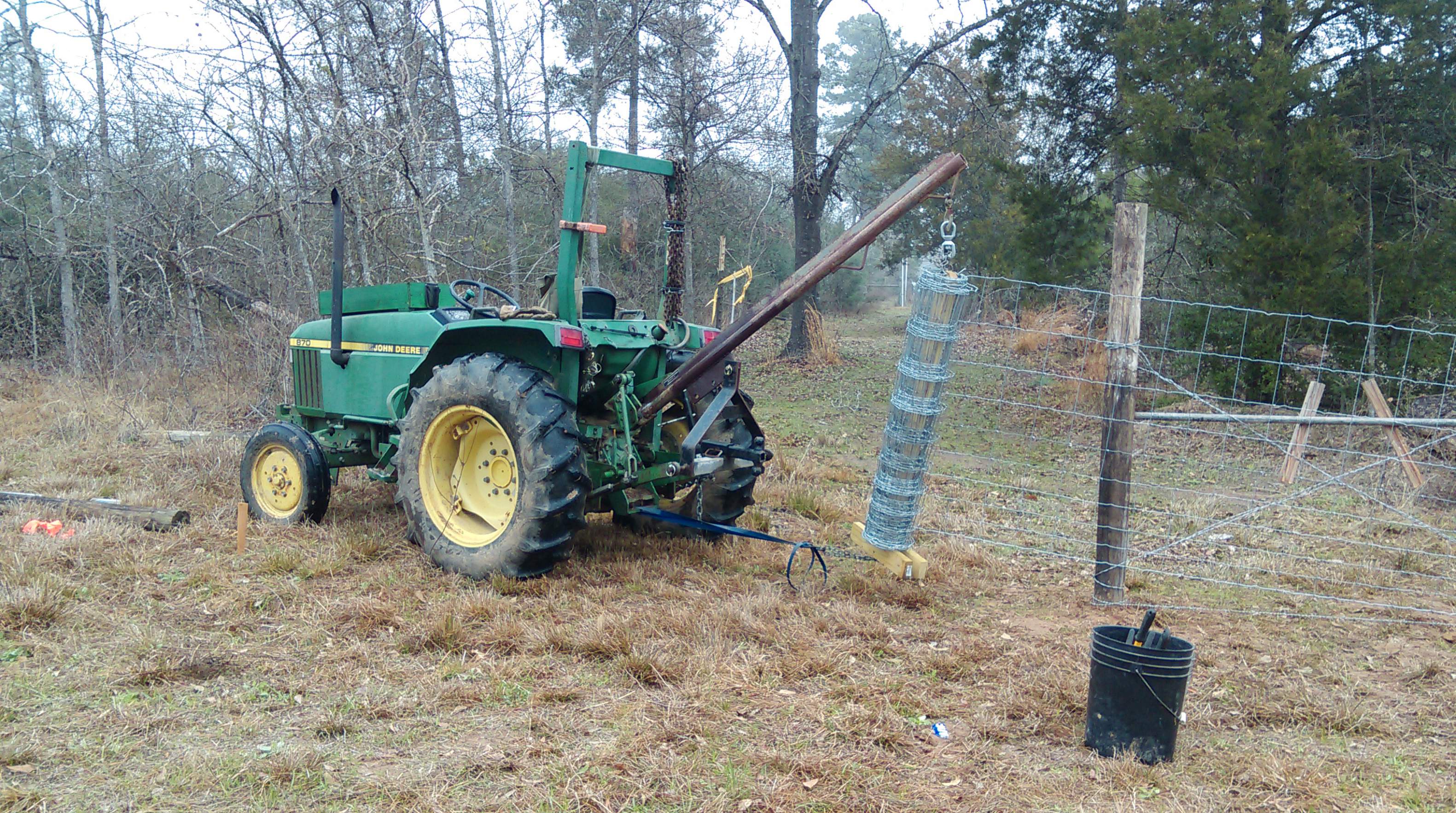

When the rains let up, or a least backed off to a drizzle, Charles and I got busy on the fence and sure enough we completed the main line that divides the property into the home-site and pastures a total of about 1,800ft or .5km of mesh and barbed wire... 7 gates... 3 corners many, many tee posts.
It was easy digging all the gate posts and pounding in tee posts in March vs August was the difference between hammering them into oatmeal vs concrete.
To speed things up I "Engineered" a widget to allow me to unroll the fence mesh off the back of the Little Green Giant... what a difference that made!
Being able to unroll an entire 330 foot roll of mesh at once by simply put-putting slowly down the stream was a real pleasure... almost.... after all, it's still fencing...
So, here is the new view from the front gate... not bad, all things considered...
