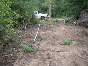

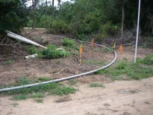

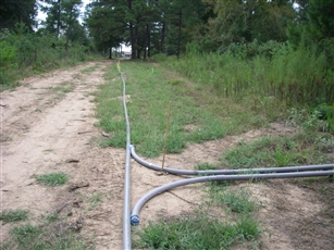

A 90 degree change in direction is going to be required to run the utilities into the house site from the Utility Corridor, and Engineer Dude gave me two options regarding the Primary Power:
  • He could have the installation crew set a junction box at the corner and make three cable pulls.
or:
  • I could make a long sweeping 90 degree curve in the 2" PVC conduit so only two pulls would be required to reach the transformer pad.
Since there is going to be one junction in the line about half-way along anyway, to allow the Commissariat to use up short lengths of wire and provide a spot for a second transformer to potentially serve additional houses that might be placed there in the future I decided to make a long sweep and avoid one additional box and connection point.
Here is where the Texas heat came to my aid ...
I glued up enough pipe to make the curve, about 60 feet in all, and set it out on the driveway in the sun to bake ...
It got up to 103 that afternoon, so the gray PVC soaked up the sun and was soon limber enough for me to hand-drag it around a t-post I drove in for the purpose .. it worked like a charm I soon had a 25 foot radius 90 degree elbow, complete with pulling string all wrapped up and ready to go
The Power Dudes should have no problem pulling cable through that but just to be on the safe side, I will get Engineer Dude out to approve of my work before I schedule anything ... we could always put in another junction if he doesn't like it ...
I finished out the day by making all the tube turns / risers ... four from two inch pipe for the Primary and two from three inch for the Secondary line to the main disconnect ... the impressive length of those risers made that deep ditch look like a mighty good way to keep anyone from hooking that line and since I think it will be running 13kva or so, that is a GOOD THING.

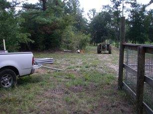

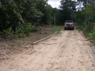

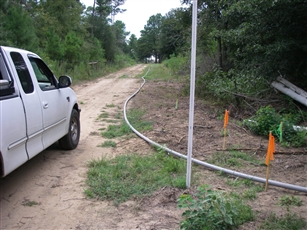

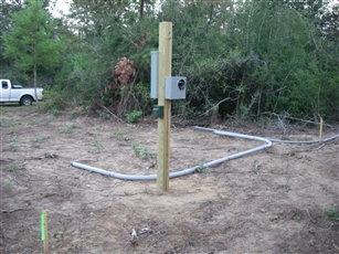

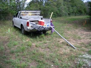

The next day started off with a beautiful, cool foggy morning ... of course, anyone from Texas knows the nicer the summer morning, the hotter the afternoon is going to be so I put a good foot under me and got started ...
To run the main line, about 800 feet or so, I decided to use my pickup as a "Lay Barge" and assemble the line as I drove ahead 10 feet at a time.
I loaded up a bunch of pipe, used the tailgate as a workbench and my tractor as the anchor for the spool of pulling string that I was lacing thru each section of conduit with a 1 pound lead sinker as I assembled it.
Tho I have blown pulling strings thru some pretty long stretches of HDPE conduit, I have found that the more joints in a line, the greater chance of a hang-up so I did this run piece-by-piece.
I pulled up a stick of conduit from the pile, ran the string, cleaned, primed, glued, drove ahead ... pick, string, clean, prime, glue, drive ahead ... repeat as necessary ...
I was making some good progress, but it was getting to be a PITA climbing in and out of the truck every 10 feet and as the temperature climbed, the ice water supply was starting to look a little low by about 10:30 or so ...
... Then the Marine landed ...
Good Neighbor Joe spotted my gate open and tried to sneak up on my in his Prius ... in "Stealth Mode" you can hardly hear that darned thing rolling on my sandy driveway and I guess I am still a little deaf from living too close to the artillery .... so Joe got the drop on me ... and scared the BEJAYZUS out of me with the horn .... I have GOT to remember to order some gravel ...
Anyway, heat or no heat, Joe would not be talked out of helping me, so he put on his working hands and threw down.
Once we got the rhythm down, that pipe went together in no time at all, and by high noon, we had the main line strung out and capped.
Now, I am all about being self-reliant, but nothing beats a helping hand now and then .... Good work with Good Friends ...
I also highly recommend having a Marine or two around at ALL times ... you never know when one will come in handy and like a good pistol, it is better to have one and not need him, than need one and not have him ...
With this part of the work done, Joe and I parted ways ... he to complete some errands and me to clean up for lunch with MIL and FIL. I took a siesta thru the heat of the day ... I believe it hit 107, so waiting till late afternoon to continue was just the sensible thing to do ...
It was still pretty warmish when I got back out to TOGR around 4 that afternoon ... still WAY hot, but when compared to the oppressive humidity of the Gulf Coast, the dry heat of Central Texas is a cake-walk ...
The finishing touches that afternoon included setting out the tube-turns and capping all of the open ends of the pipes with heavy plastic and electrical tape to keep critters and moisture out while I await final approval for the route and materials and start digging the ditches
That was a good day's work ... a tip of the Fedora and a cheap cigar to Good Neighbor Joe. HOO-rah !

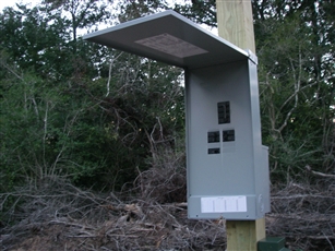

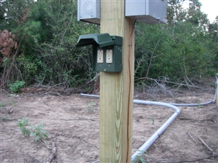

I had already set the Power Pole once I laid out the route for the conduit, so I decided today I would hang the electrical boxes and wire up what I could.
The Commissariat of Power provided their own meter can, which I picked up at their yard on my way thru Navasota ... I already had a 200 amp feed thru panel to act as the Main Disconnect and the assorted breakers to power an RV hookup, the Barn and some GFIC outlets.
But now that the boxes were laying out on my tailgate, I noticed that the PVC fittings I had bought were too large for the knockouts on the back of the meter can ... oh well ... since it was still relatively cool I decided to at least drive the ground rod
I have a VERY heavy post-pounder ... I made it years ago out of a piece of oil-well drill stem about 4 feet long with a 3 ID ...
... it probably weighs about 60 pounds but sinks t-posts into anything but solid rock like it was driving them into marshmallows ... it was not very long before the ground rod was in place and I had the ground wire clamped and run halfway up the pole.
I am going to have to give that post driver up eventually ... every time I use that sucker I am reminded the next day of how many years it has been since I was 18 ... but ... it sure does the job RIGHT NOW ...

The smaller rigs are plentiful and rent cheaper than the Big Box stores, but I will have to plan well in advance if I want to trench the deep cut, and have a Plan B in case all the machines are tied up there are several owner-operators with back hoes around Grimes County, so it shouldn't be to much of a problem should all the big trenchers be tied up ... I will give Dirt Guru first shot ...
My route thru town finally took me past the grocery store, where I filled MIL and FIL's order, got a nice big cup of gourmet coffee and even got a FLU SHOT fer cryin out loud ... you have to love a modern BIG Grocery Store ...they stock everything from Birth to Death and anything in between ...
Fortified by the coffee, I left Town, taking another route back to TOGR, also thru the backroads ... when you get off the main highway around here, you are on roads that might have had their origin in the cart paths of the Republic ... they wind and twist and present new surprises around every bend ... and even if you travel them frequently, you find the farms and ranches are always changing, and it is surprising how quickly you will begin to recognize those changes ... when time is short I must take the Straightest Path but when I can meander,I much prefer the backroads ...
I dropped off the groceries on my way past MIL and FIL's ... one of my most endearing traits to both MIL and Precious Bride is my ability to carry 10 plastic grocery bags in one trip and reach all the high shelves in the kitchen without a ladder ...
... a fella has to go with his strengths ...
Back out on TOGR I had the boxes mounted, popped the breakers in, got the ground wire hooked up and the GFCI outlets wired in just a little while ... nice getting the right parts ... I sealed up the meter can with a plastic bag and duct tape to keep the hornets / bats out ...
Later, when the power and water is in and a little of the dust settles, I will put a small peaked tin roof on the top of the pole and rig some lights under it as a sort of electrical "Tiki Hut" ... I don't like the harsh glare of the usual mercury vapour or halogen lights neither does Precious Bride
I just need a little light so I can get a good silhouette to aim at .. I am an "Iron Sights" kind of guy ... I think Precious Bride prefers the night vision goggles or that pink anodized Gen 4 scope with the sequins ...
With the pole done, this was as far as this project was able to go ... it is now up to the Commissariat of Power to get the road crossing settled with the Texas Department of Transportation ...
