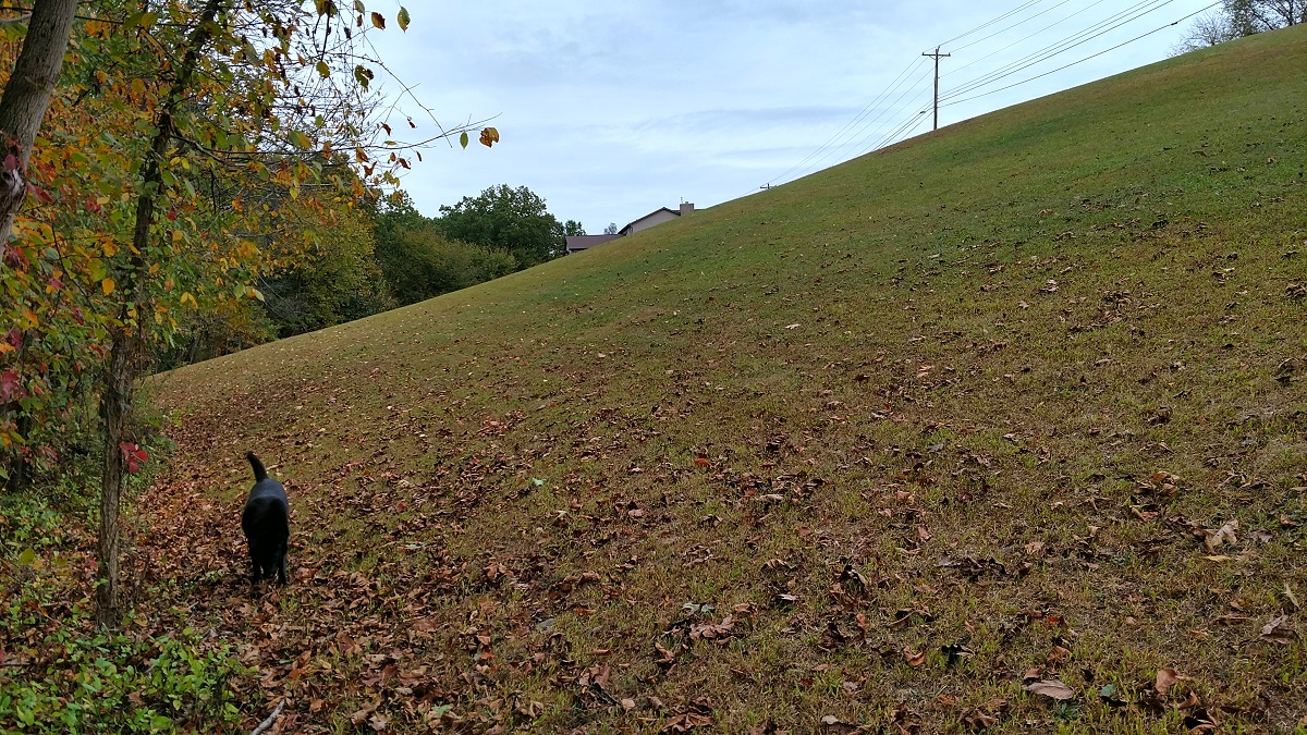

I agree with Mike. I'll show you 17 degrees and 32 degrees.... Your not using high range on either. Maybe not mid range.
The photo with the leaves in the yard is the 16-17 degree main yard.
The photo with the Craftsman garden tractor is a 32 degree bank going up to a guardrail.
I used a 6 foot level laying on the ground with a mechanical angle finder laying on the beam to determine the angles.

You could be correct. Won't know till I tried it but I made a mistake when I used the asterisk which normally means "degrees" instead of using the "percent" key. I meant a 30% incline which is less than a third of 45* incline which neither of your pics demonstrate.
   / An understanding on the age old debate of geared/hydro
#33
Sorry. I did mean 30% and not 30* which is more than 2 times steeper than a 30% grade. My machine has only two ranges with 8 forward speeds and will go up a 30% incline in 5th gear or 1/high. It will skid a 1500lb hitch in third (or 3 low) going up this same hill.
