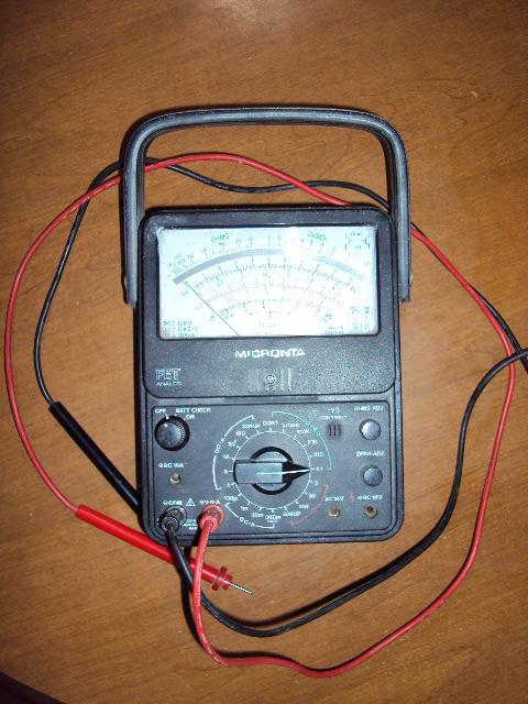

I have a nice old Micronta (Radio Shack) made analog multimeter. I needed to press it back into service for its 10amp, DC capability a few days ago. I was trying to track down some parasitic battery drainage on a vehicle.
It worked fine two days ago. Today I tried to use it and when I turned it on, it goes to full left deflection. In the On position, the Ohm and Zero adjustment knobs do nothing. Changing the dial between any of the settings does nothing either. If I turn the On knob to battery test, it does exactly as it should. It goes to the right to indicate battery strength.
I've checked the batteries and fuses and all are fine.
I'm kinda stumped. For it to have worked fine just a few days ago, and now this full deflection to the left today I'm experiencing. Yes, it could have just croaked today, but I'm thinking it is something I'm missing.
Any thoughts?
All ideas are greatly appreciated

I would check for the position switch the meter is being driven to the left by voltage so maybe a corroded wafer contact. or wire became loose. The bat.check is just a single switch to resistor to meter.
I have a stack of the little analog multi-meters. all one problem or another and unable to locate parts. Shipping prices excede the cost of new.

Are you sure the battery hasn't been put back in backwards on that thing? You sound familiar enough with the stuff so don't get offended. Depending on the Micronta a lot of them didn't have transistors in them which would drive the needle to the peg. You might just look to see if a piece of junk hasn't landed in there and shorted out some contacts. And last but not least those meters can develop poor solder connections which can do the same thing. Take a magnifier out and look for that unless you have really good eyes.
Another thought is make sure the Zero adjust pot for the Ohms hasn't opened up or something.
I work in an Calibration lab where we test electronic equipment for accuracy. I have been around those items a time or two.
My toss it factor is getting easier to do as I like to fix what I can. But I have a lot going and little space in my house so I tend to "donate" more now to the give away pile.

Just for kicks, I tried turning it on today and it "seemed" to work fine. I was using it to see if a Throttle Position Sensor was working or not.
The reason that I say "seemed" to be working okay was that when I was measuring battery voltage of said car's battery, it read consistently 1 volt lower than my little digital multi-meter.
I think I have the instructions still, but maybe what I need is a refresher course in setting up my Analog Multi-meter, Analog Multi-meter 101.
Here's a picture of it:
1) Under the white lettering "MICRONTA", what is this little slot screw used to adjust? (sorry, hard to see it in photo)
2) What is the proper usage of the Ohm's and Zero adjustment knobs?
Appreciate the help from anyone who takes the time to type all this out.
Thank you

Analog meters are subject to errors from tipping if the movement is worn out a bit. Then reading errors from parallax errors (when you are looking at the needle from the side instead of from above) And some of them aren't very accurate to begin with. Your DVM could be off as well. Typically though the DVM will give you more accurate readings.
For the ohms mode you want to short the test leads together on the lowest range that you will be measuring. Then adjust the zero pot for 0 Ohms on the meter. As you change ranges you will probably have to rezero it for the most accurate readings.
Be careful measuring voltages of course like being on DC Volts for DC readings and AC Volts for AC. Some meters won't tolerate being hit too hard with high voltages on low ranges.
One thing you might check is to see if the needle moves back and forth smoothly? If the spring is weak or damaged or the pivots are worn the needle will not move smoothly. That can give you reading errors.
/ Analog Multi-meter question, #11
B.W.D. This screw is to place the pointer to 0 when no voltage on meter. be careful go to far and messes up the setting stop.
On the ohms setting touch the leads together pointer should go to 0 on the scale then release pointer should return to full scale on the meter scale.
if not then adjust by again touching the leads together and one of the adjustment knobs should. then open and adjust to full scale reading each adjustment effects the other.
Depending on the grade of the components inside this should work.
ken

I really appreciate the refresher course on the use and set up for my Analog Meter.
Have had several situations here lately that have dictated the use of both my meters for testing.
Watching the sweep of the meter arm was very helpful while troubleshooting whether or not a TPS was good on a car I was working on. My digital would give readings of course, but with Auto Ranging, it always goes through several permutations before it settles on the final number. Therefore, it's kind of worthless to see if the TPS had a bad spot. With the analog, being able to see a nice smooth needle swing with no jumps or spikes, I was getting a more thorough picture of the parts correct function.
