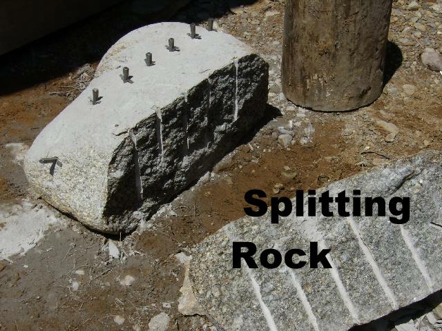

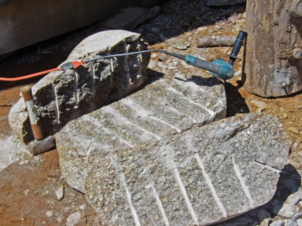

Hammer drills and feather and wedges will work. Be prepared to spend some time though. :D
Check out some INTERNET sites and you'll find some specifics on splitting rock.
I have split a few rocks using an impact drill, feathers and wedges and an angle grinder with a stone cutting blade in it.:D
