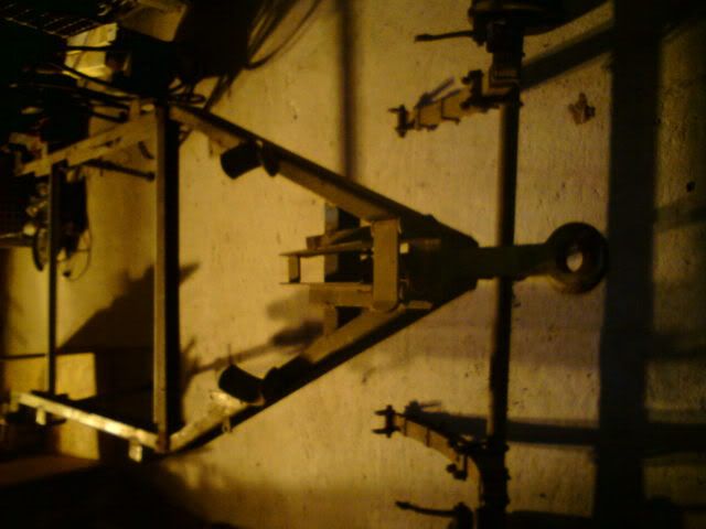

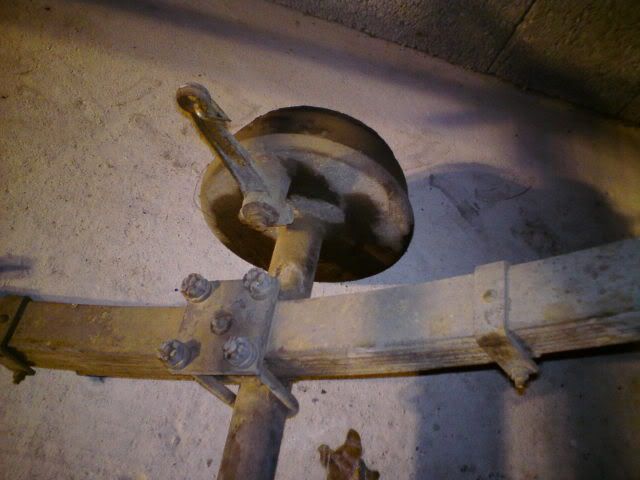

I do have a 2ton military trailer frame which i will use as base. This trailer has leaf springs which i will remove. I intend to use the axle and have the hubs converted to take 5 bolt landrover wheels. Wheel size will be 235/85R16, around 80cm high wheels what brings the frame and so the hitch a couple of cm higher than 40cm, and exactly in line with the original towpoint on the TL.
Here it is:
As you can see the wheels have brakes, i dont want to install a run-up brake mechanism but will install a handbrake mechanism.
The support feet will be relocated to help stability when loading (might skip them and just make something more sturdy)
The loadbed wil have to be ---_____---- shaped (whole length for the dumping feature) to accomodate the wheels (TL is not wide) i dont want to make a platorm as this would higher the whole trailer and make it unstable. (i was thinking about a double axle flatbed but that would limit me in maneuvering around the place too much.
Bottom part between the wheels will be around 0.9 meter and the top wings widen it to 125-130cm, lenght 2meter and complete lenght of the trailer 2.8 meter. (my gangway in the stable is 3 meter wide so i should be able to turn the empty trailer by hand)

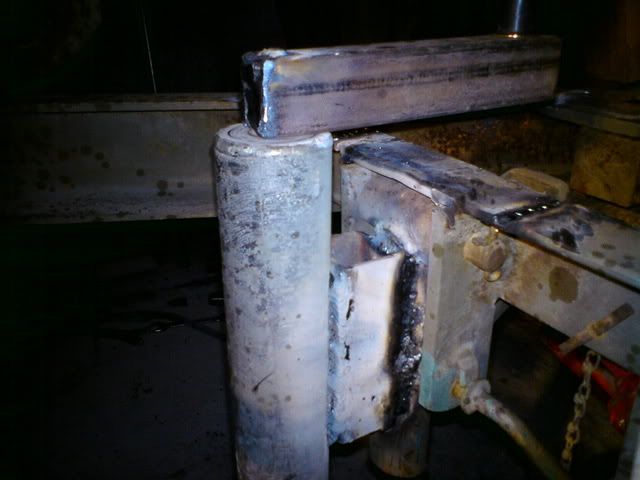

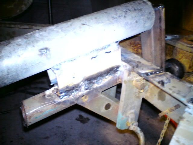

Started tonight.
Base frame and 'the hinge' are finished.
Decided on position of axle etc
Ready for tomorrow.

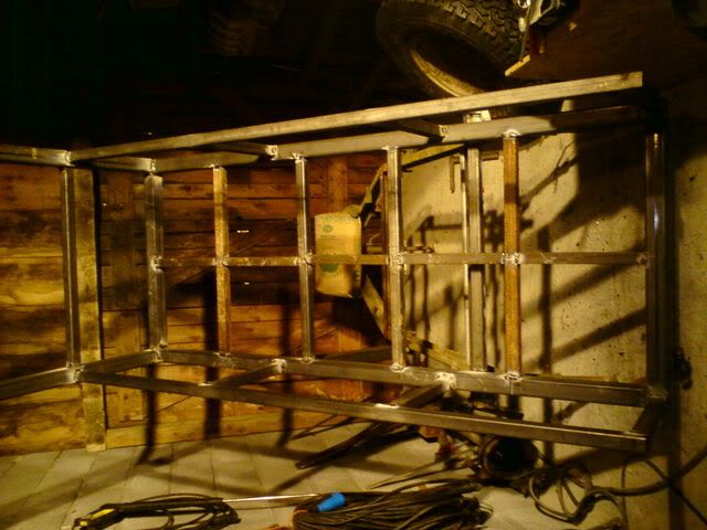

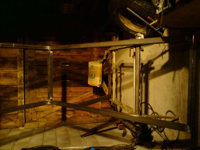

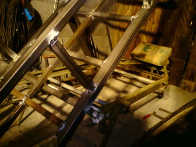

Now, about the trailer, some more pictures:

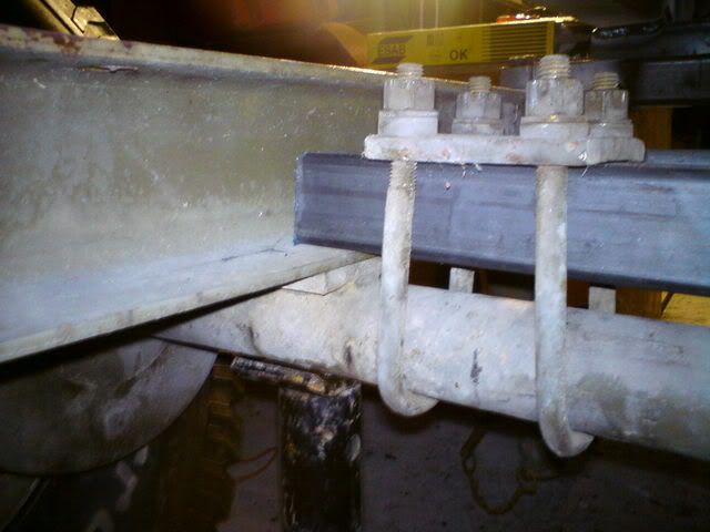

Left the axe free (only bolted down) so i can still move it once everything is finished and i actually can feel and see the real balancepoints.
Looking at height and proportions all limited by the 125cm width of the TL i had to change plans a bit an skip the -----________----- loadbed idea. I will have a smaller load capacity this way but the thing would be completely out of proportion (and entering the +300kg empty range). So a usefull cargo volume of 80x200x40 without side extensions and 80x200x80 with the side extensions. Gives 0.64 and 1.28 cubic meters. or if loaded with manure a load of 0.6 or 1.2 ton. just within target range.
I figured in the mean time i will need a 40cm (80 extended) hydraulic cylinder to lift. Wheelhubs are in the make when Zoro finds a spare moment so maybe in a couple of days i can actually move the trailer on its wheels. Christmas is putting a brake on things, small village so no grinders or chainsaws to be used in these days. Maybe i if i use enough cutting fluid i can drill something and a welder will look as some celebration fireworks...:p

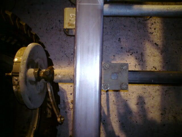

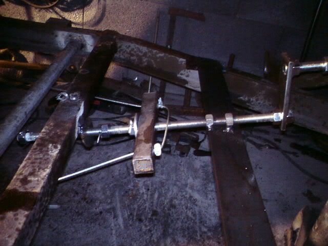

So i played a bit with the brakes and made an own mechanism to apply the brakes. Old style turning to apply the brake but that should also work i asume.
