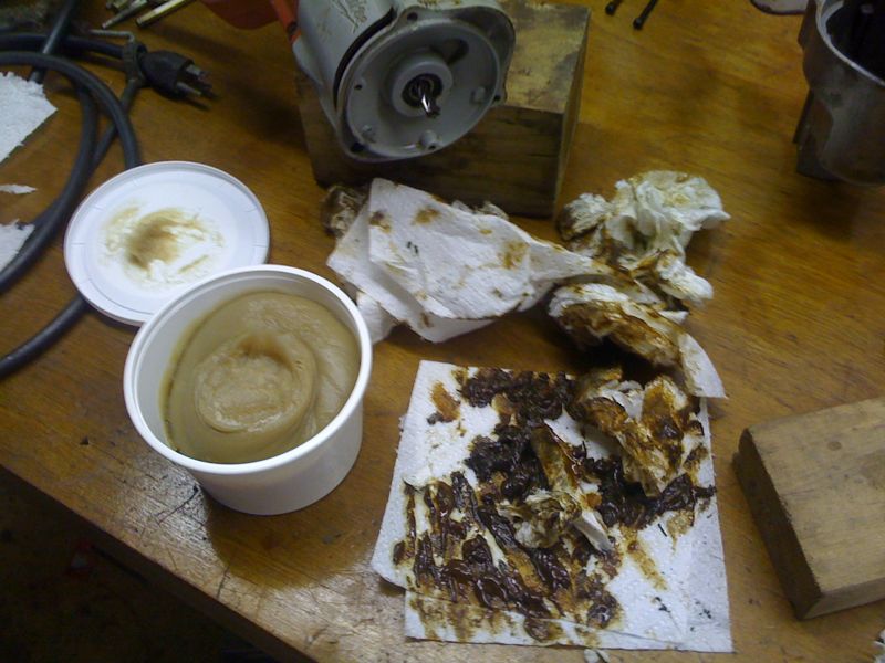

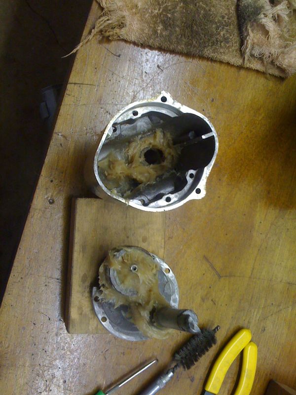

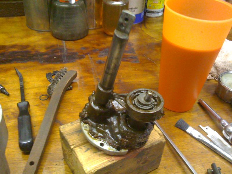

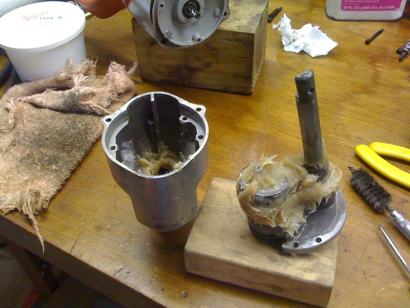

just a guess but the crunchy was gear teeth breaking off, if they have a place to fall then the unit will still work as you say in light duty. I would suggest if the unit allows open up the gear case, we used to call it the "monkey head" and remove the shrapnel and re grease.

Some people recommend open any HF power tool and put in decent grease before first use. I never have; probably should.
