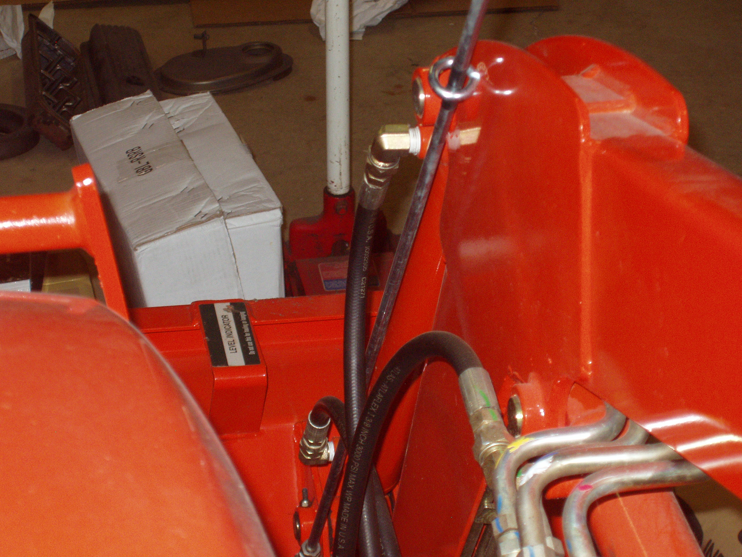

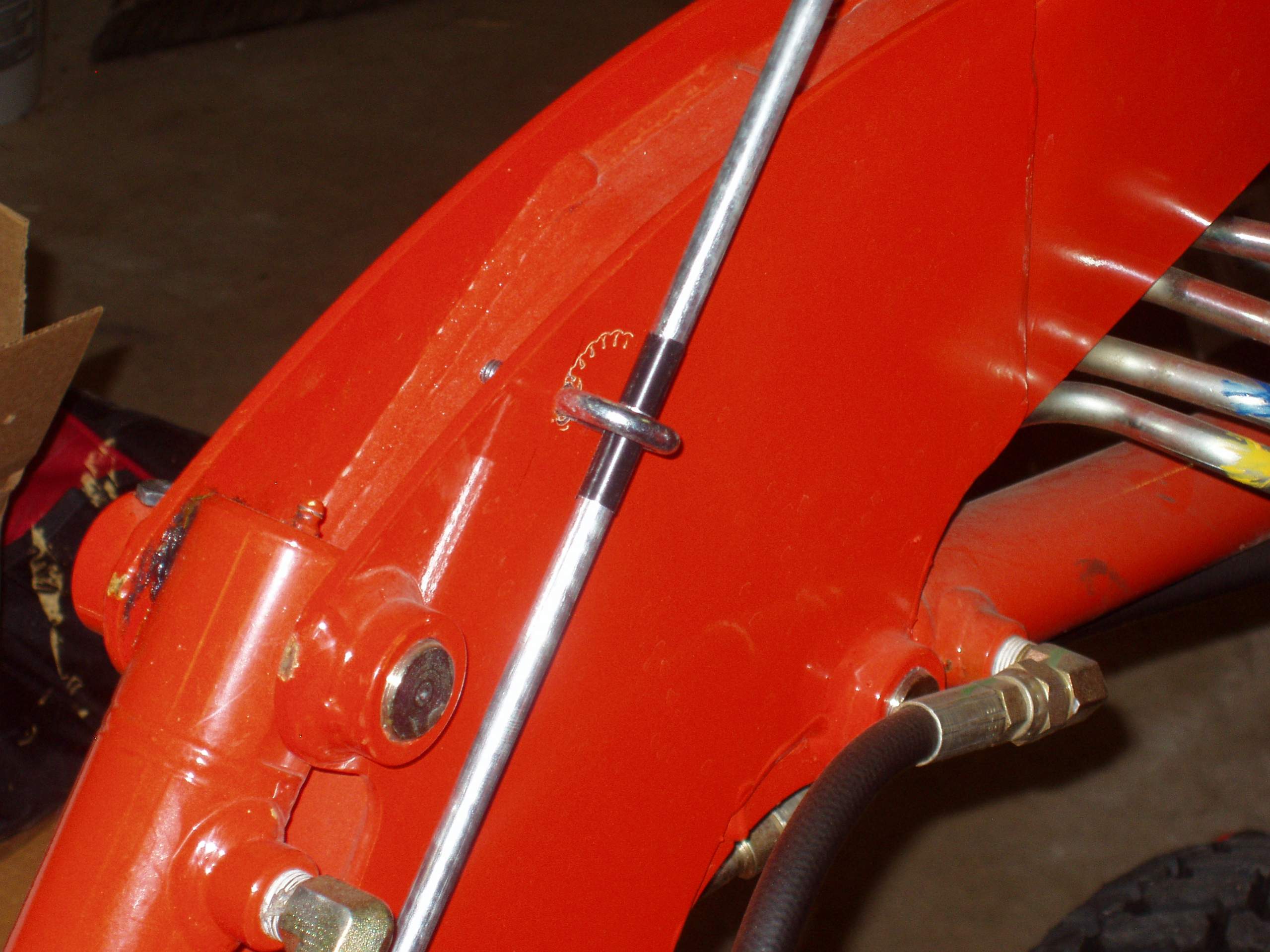

The best thing I ever did to my FEL was to add a bucket level indicator. Repeatability of the bucket angle is very important to getting the most out of the FEL. By knowing where the bucket is and noting what position works best for a given task I can do so much more that I could without it. A small angle change makes the difference between having the bucket dig in or ride up. Without a level indicator you have to eyeball the bucket and hope it is where you want it to be. Then by trial and error you find out if you guessed right. The indicator takes the guesswork out of it once you figure out what setting does what. As an example, I plow snow with the FEL on a gravel area at the end of my cement driveway. I can set the correct bucket angle, which I found from experience, and skim the snow off the gravel without digging in or rideing up. At the end of the push I raise the bucket and dump the snow. As I am backing up I set the same angle again with the indicator. When I start to go forward again for the next pass I power lower the bucket, push it into float and go forward again pushing snow not gravel . Much faster than trying to quess the correct angle all over again. The indicator is not so important for backdragging but it sure is for going forward. I made the one I have on my B3030 from simple materials. Very easy to do. Some say they don't need an indicator and just use the little flat bar on the bucket. I am not that good. The indicator makes all the difference for me for taking the frustration out of precise loader work. Good luck.

Every tractor I have ever owned came with a loader bucket level indicator. I agree, it is a very advantageous tool. The one on the Kubota LXX40's is very slick. Its adjustable and when you hit flat, you have a positive visual of it.
