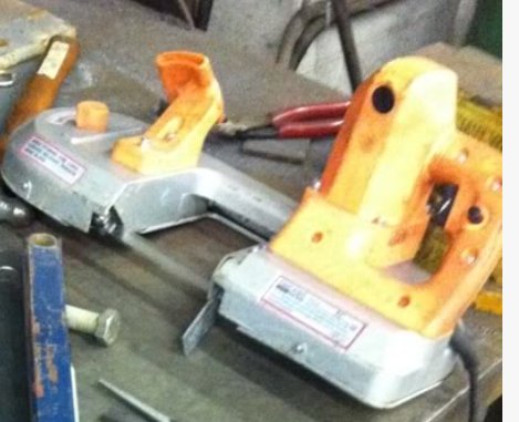

On your bench you have this power saw..
We don't seem to have anything like that in the UK and I can see many uses for it, an probably cheaper to use than a 9" disc cutter. Can you who makes them and what model you have, or some links to similar on line please?
What's the down sides?
Thanks in advance

View attachment 277883What's the down sides?We don't seem to have anything like that in the UK and I can see many uses for it, an probably cheaper to use than a 9" disc cutter. Can you who makes them and what model you have, or some links to similar on line please?
Thanks in advance
It is a portable band saw. i believe Milwakee was the first to make the Porta-band. This one was just a cheap made in china piece I picked up at Harbor Freight tools about 10 years ago. The blades that Harbor freight sells seem to last a really long time and are about 20 bucks for 3. I've tried a bunch of other brands of blades, and haven't found a better blade for money.
Only downside i see is it needs a deeper throat, it is sometimes hard to cut non flat things.
I've had it for years, and ended up buying a Milwakee after I wore this one out. I also do alot more work than an average DIY person would use it. its cut anything from thin sheet metal to 2" solid bar. For the money, I was throughly impressed and wouldn't ever think of comparing it or using a 8-9 disc cutter instead. but like many tools, it has it limitations, but for what it is designed for, it is kick butt for the money!
here is a link to the harbor freight model, like i said it is a good "cheap" unit. But a milwakee or makita is alot more heavy duty. they are about 300 bucks though.
Portable Band Saw with Variable Speed
