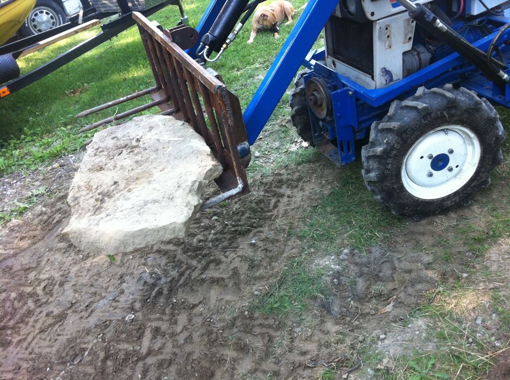

I got to try out my rock/brush/hay rake today. I got this with the old loader setup that I cut apart and re-engineered to fit my tractor. I believe it was a hay fork. I added some 1/4" angle reinforcement at the top of the 1" tines. I'm going to weld in some supports on the bottom of the tines and and a grapple for moving brush and rocks. I also added a quick attach similar to john deeres QA
   / Angry Beaver project (FEL build) #87
Grapple is one of the most useful tools to have. I think the tines on that old hay rake won't be strong enough. Time will tell I guess.
I like the quick attach, I have an idea of one for myself but it will hopefully be a little bit lighter in weight and also not require modifying the bucket. Before I can do it however I'll need to make the grapple and snow plow all have the same mounting geometry as the bucket which they currently do not.

the tines are bigger than 1"... 1 1/8". like I said I want to add some supports between the lower tines. I'm also going to add more of a hooped cage up top to protect the tractor. the tines are actually stronger than I thought they would be...
   / Angry Beaver project (FEL build) #89
Solid bar isn't as strong as you might think.

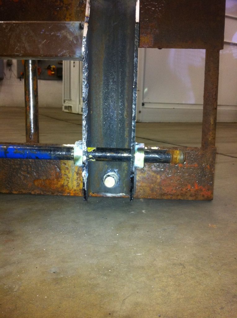

got the quick attach welded on the fork cage so I could use them today.
