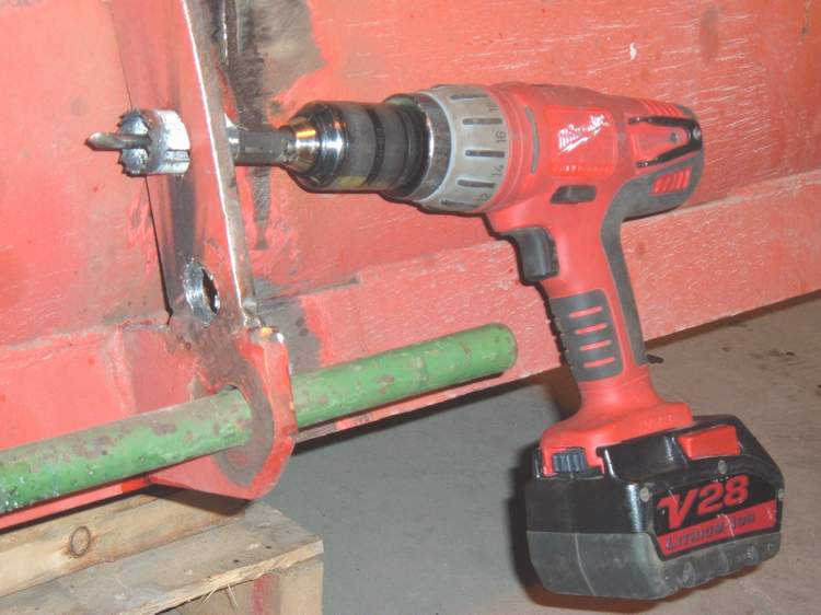

There are surely lots of ways to drill big holes especially for one off or occasional use, this works from 3/4 to 1 1/2 or so, really well in the inch range. I am usually done before a guy could rig up something fancy, on equipment in place other things are not always practical either.
