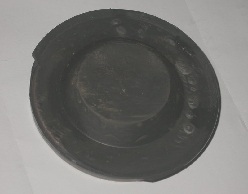

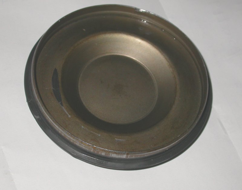

I did check mine and both are intact (no oil leaking ). Also could see where they are in a position to be quite vulnerable if catching a rock just right and rolling over caught underneath. OR in hard dirt compressed under the same place.
   / another 4300 design flaw!
#32
you can see the rubber lip around the outside (some is torn from when i removed it), and the bump is tapered, instead of coming out square.
it also says 'spicer' on it, i can't see any wording on the factory original.

   / another 4300 design flaw! #34
So, the metal lip on the new seal DOES NOT contact or seat on the inside lip of the final drive housing? But, the old metal seal DOES seat on the inside lip when installed! Correct?
That doesn't sound right... I can imagine the engineers adding a neopreme seal to reduce the likelihood that the metal cap will "seep". However, I CANNOT imagine that they would eliminate the metal base seating against the drive housing lip. They might reduce the size of the contact surface to allow for expansion room with the seal - but no metal to metal base - that's not good design work!
Do you have a big ol' socket that would fit around the circumference of the seal to use as a seal driver. I've got some great big ol' sockets that I used on the front axle nuts on an old IH 4x4 1200 series truck. Big honkin' things - 3/4" drive must be 4" diameter!
I wonder if you're installing the cap - all cattywompus..? And that's why it's leaking?
Have you picked the local JD mechanics brains on this problem? Be interesting to get their take on the solution.

it is true. the old one is an all metal lip, the new one has NO metal in the lip, purely rubber. part of the rubber lip is torn off from when i removed it and i can see the metal part is cylindrical...meaning all the metal goes inside the housing w/ just the rubber on the outside. i commented to the parts guy and he was like, yea, that's not going to stop it from moving.
i didn't talk to the service guy because i didn't know at that time that the original was all metal. but i did want to ask them if i could get the all metal ones from somewhere.
the one that got pushed in was installed nicely, and didn't leak until it got knocked around. the new one, i did have a problem getting in there straight, it is a bit off, but w/ the sealant, it is currently sealed. as long as it is still good when the axle builds pressure, i'll go w/ it until it gets knocked out again!

Bring the original one to a driveshaft shop. I bet they can order the all metal one from a Spicer supplier. Can probably even look it up in their books.

unfortunately, the one i removed was already a replacement. the original is on the other side and still in there. but i can get the measurements from the replacement and see if i can find an all steel one, if deere can not.
if you do front axle work, don't destroy your original caps!

i guess part of the confusion is my fault. i didn't know about the all metal cap until i talked to Dfkrug about his caps. the one that got pushed in was a rubber lip....which i THOUGHT was original equipment...since that is what they sell as replacements. so, i guess that side had already been worked on before i bought it, and the cap replaced. the other side, which i have never opened, seems to still have its original cap.
the one picture i showed was of Dfkrug's all metal cap. the post w/ 2 pics, is the old rubber lip that i removed...one pic of each side. the new rubber lip is never pictured and installed.
so, i removed a rubber lip and replaced w/ a rubber lip.

Bring the rubber one to a driveshaft shop and tell them you want the original metal style. I have never had any trouble getting old Spicer parts at the big-rig driveshaft shop in town. Even Spicer parts they don't deal with on a regular basis.
