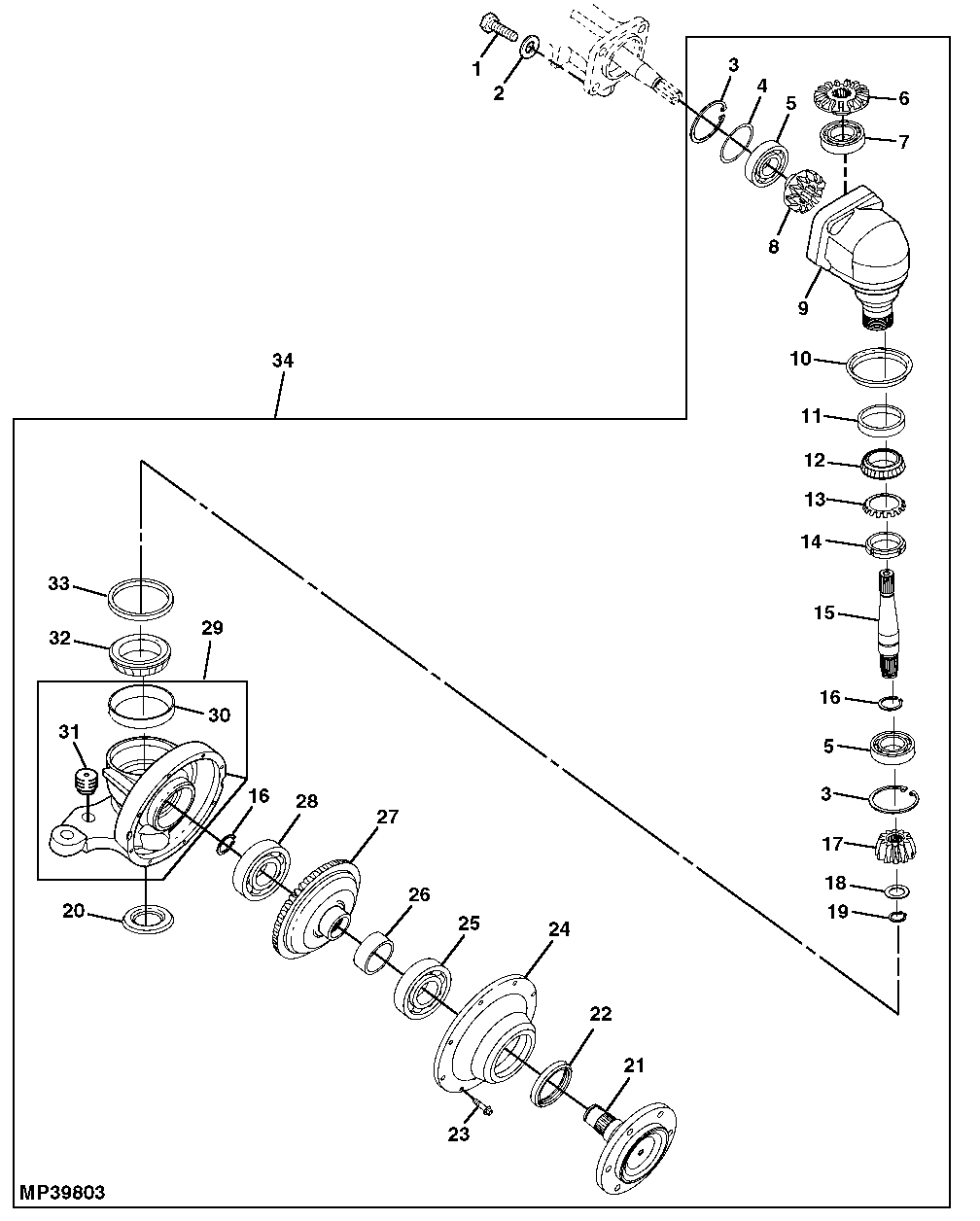

Perhaps he is talking about part 20 here:

exactly right Cocre. the plug just pushes in, with some sealant. there is no stop to 'bottom it out' on
i understand that it is not a bulldozer, and it is not a tank, but it IS a tractor. i should be able to drive over a pile of dirt (straddle it) and not experience a potentially catastrophic front end leak.
it would have relatively simple to design the final drive housing with a shoulder that the plug would contact, so then it could withstand SOME pressure on it. as it is, it can just push in until it hits the kingpin with very little pressure. better yet, it would have been simple to make a solid cap to fit over it.
now, i have not studied it closely yet. it looks like it just got pushed in, but it could be crushed. if it's crushed, that's ALMOST understandable. but they could have still put a piece of 4" round steel over the bottom.
