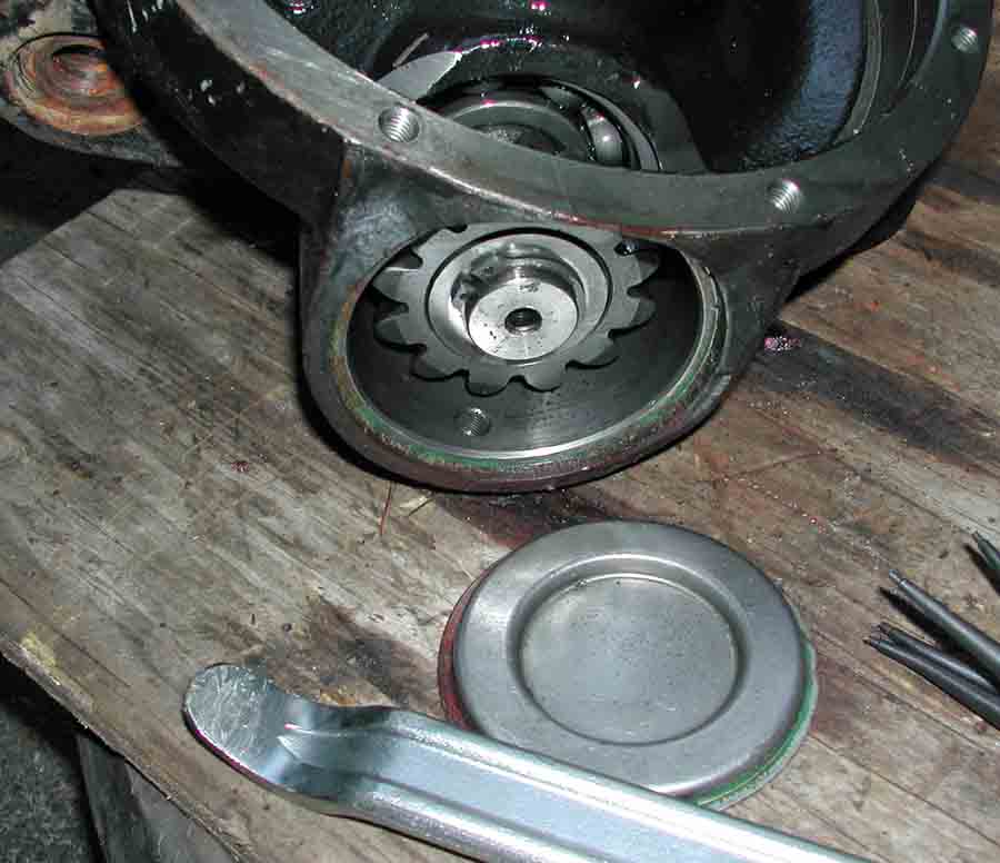

on a side note, the tech manual just says 'replace the cap'...it doesn't tell how it should be done.
the cap has a rubber lip, extending beyond the OD of the cap. does anyone know if you drive the cap in until the lip just hits the shoulder of the housing, or do you drive it in until the lip folds back up into the ID of the housing? i can see it going either way, and not sure if it matters. the factory cap looks different, so i can't compare.
   / another 4300 design flaw! #23
Drive the cap in until the flange contacts the 'shoulder' of the swivel housing.

i took this picture from Dfkrug's 4300 rebuild thread...
his cap is all steel. my new cap looks similar, but the lip around the outside is rubber. his cap, you can tap up until it hits the steel flange, and it won't move unless it's crushed by something. if i tap mine in until the rubber hits, there is nothing to hold it from going in further, with minimal pressure.
the cap on the other side looks like his steel one...so it does look like they made a change on the replacement parts that is worse than the original. i will look into if they ever offered the 'all steel' caps later.

no problem Beenthere....besides being a rant, i wanted to post what happened to me so others could be aware. if you take a look under yours, see if the 'bump out' is squared off like the one in the picture i posted, or if it is tapered. the new ones are tapered, and a rubber lip. the factory ones appear to be all steel and square on the bump. if yours are the all steel type, they will be much harder to do what i did to my replacement cap.
#27
thanks, after seeing what an all steel original looks like, i do believe that it correct. don't know why they went from a steel lip to rubber.

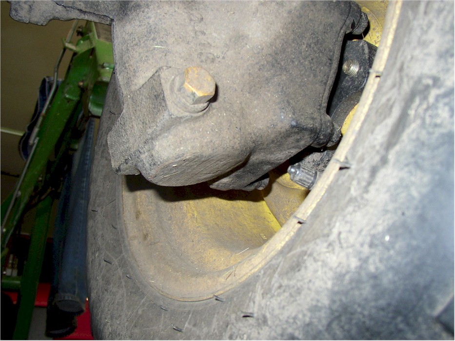

And then before all that, this is what they did on the 55 series tractors. Hard to see any way to damage that.

EXACTLY my point JD755...why take a nice solid object and replace it w/ a hole facing downward into harms way! maybe it was done for easier service, as it was pretty easy to remove the spindle to get to the knuckle seal.
i do feel better knowing that the cap design was changed and that the original design w/ all steel cap wasn't AS prone to what happened to me....but then i feel worse knowing that the new cap is probably all deere offers.
