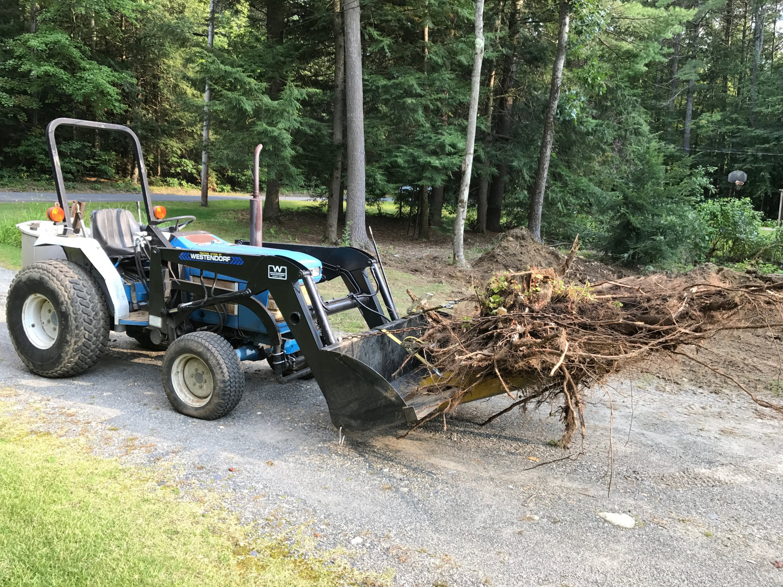

I was able to dig numerous stumps as large as 24", both hardwood (maple and oak) and pine buy using a $300 attachment called the "Rip and Dig" on the bucket of my 1995 Ford 1620 27 Hp tractor. I just started out about 5 feet and starts digging to break off the roots, and continued until I could push underneath the stump. By repeatedly lunging into the dirt beneath the setup, eventually cut through enough dirt and root to the point I could see the stump move. From there I would either attach a chain and pull it, or lift it with the rip and dig. A few stumps required me to use a grub ax on the largest roots. Some were so heavy that I could only skid my bucket or else my rear would lift off the ground. I could get a large stump out in a few hours.
Of course, I would have loved a BH or excavator. But, I used an old 27hp tractor, a $300 attachment, some sweat, and stubbornness to get it done!
/ Another backhoe question
#52
Of course, I would have loved a BH or excavator. But, I used an old 27hp tractor, a $300 attachment, some sweat, and stubbornness to get it done!View attachment 776658
This looks very much like the "stump bucket" I am highly considering! I makes a lot of sense, stab, stab, cut roots, stab stab, and eventually all of the roots are sliced along with the dirt they were holding onto. The heavy duty one by Titan is what I'm looking at. $1,500 is a lot lot cheaper than $10,000! Plus no additional moving parts, and it's SSQC.
