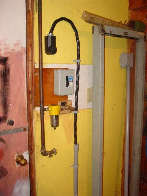

Hello, I am installing an outlet for my welder and plasmacutter. It is a 50 amp outlet in a weather tight shielded box and is the normal Nema 50 with L1, L2 and ground connections, no neutral.
I have a fuse panel in the house, with 200 amp breaker entrance, house was supposed to be electric heat
I was recently told I will need an inline GFI unit for the outlet because it is outside and the GFI is 260$.
The other option I was told would be to move the outlet inside. This seems stupid to me as I will be running the welder in the same location, no matter were the plug is.
Anyone have some thoughts?
The GFI has no effect on electrocuting one's self via the welding leads as the transformer electrically isolates them.
Best I can figure is if the inside of the case shorted to L1 or L2, the GFI would trip. But the case is well grounded so it is kind of a moot point?

The NEC® (which is now an International Electrical Code®) would not require a GFCI on a 250 volt outlet in any configuration.
Now, do the codes in Canada parallel this? I have no idea. But anywhere in the US that follows the NEC®, a GFCI would not be needed.

Article 210-8 of the NEC® has all the requirements for GFCI protection for personnel. Article 210-8 says that all 120 volt, 15 and 20 ampere outlets (outdoors among some other places) shall have GFCI protection for personnel. Then if you look in Article 527, for temporary wiring, they added 30 ampere outlets, but no where does it mention a 50 ampere outlet.

Well, I checked out the CEC and it doesn't really bear any resemblance in arrangement. I noticed they have standardized to the US for hazardous zones and the typing of equipment for those areas.
The closest I found was docks/piers/wharves with outlets need GFI on 15/20 amp that are NOT used for ship to shore power.
And the section which talks about requiring GFI for outdoor outlets within 2.2 m of the ground has an opening statment that NEMA 15 and 20 receptacles are to be used for everything in the section.

I put the outlet in the shop and used 8-3 direct burial wire with 40 amp fuses at the panel. The Canadian electrical code would have let me use 60 amp fuses due to the duty cycle on the welder but I didn't push it!
The 8-3 wire was used so that a sub panel could replace the welder outlet in the shop to free up the 120 v circuit feeding the lights etc.
Attached is a picture of the surface mount receptacle I purchased to replace the out door box.
