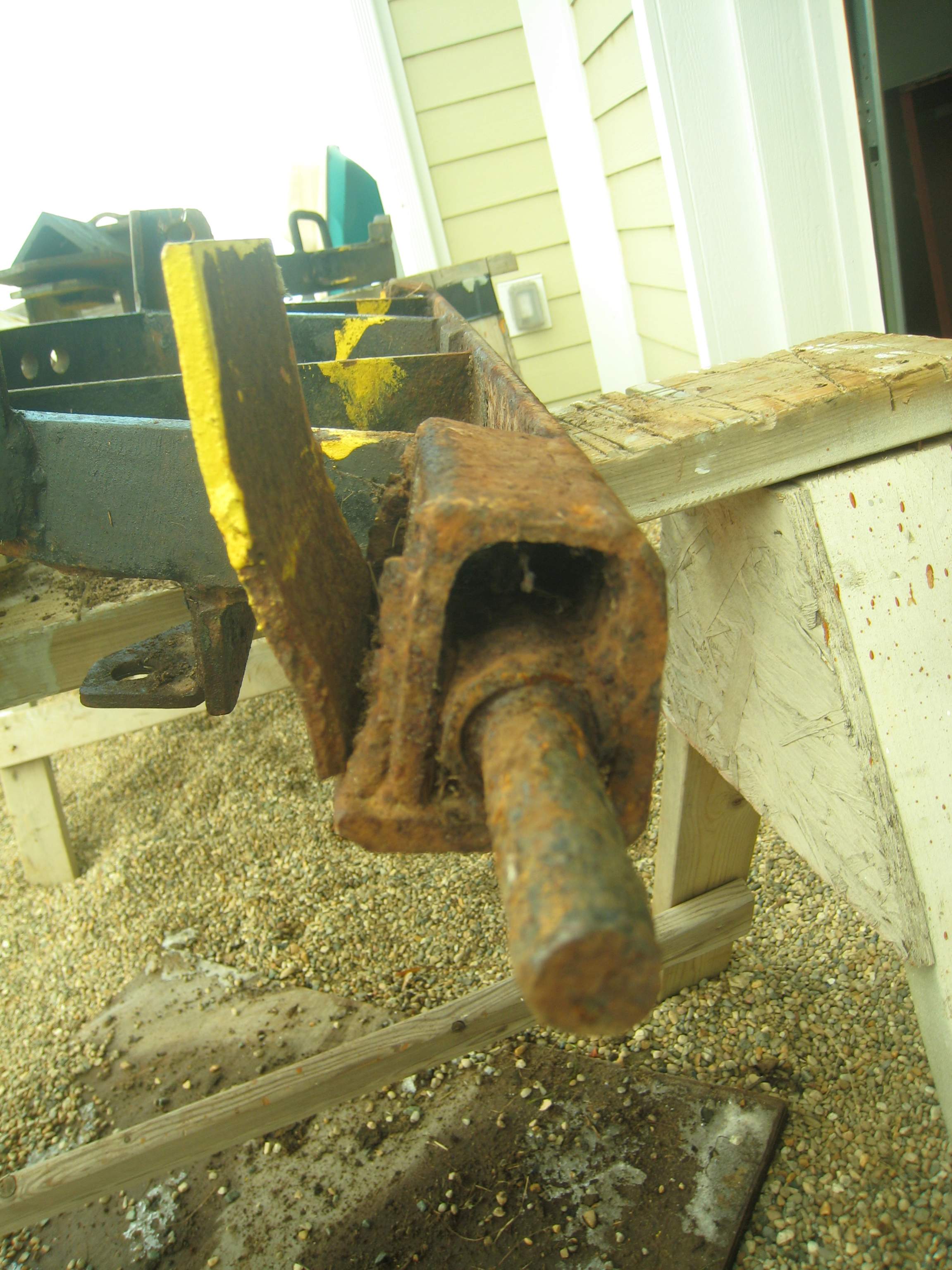

Here are a couple more pics to show you what I am dealing with on the sector pivot pin sleeves. You can see that the one pin has become fused with the sleeve. I don't think I'll be getting that out, nor do I want to!!

Thomas that's toast. Put new back. Those parts on there now have expired :)

Re the pivot pins, yeah, spend your $ there.

Q2) The pivot pins are ideally greased when installed and removed and re-greased each year. Obviously, yours was not re-greased. It is not unusual for the pivot tubes to require removal and new ones installed. Alignment is important for proper pin installation. Weld it up with the pin in place, prior to greasing.
