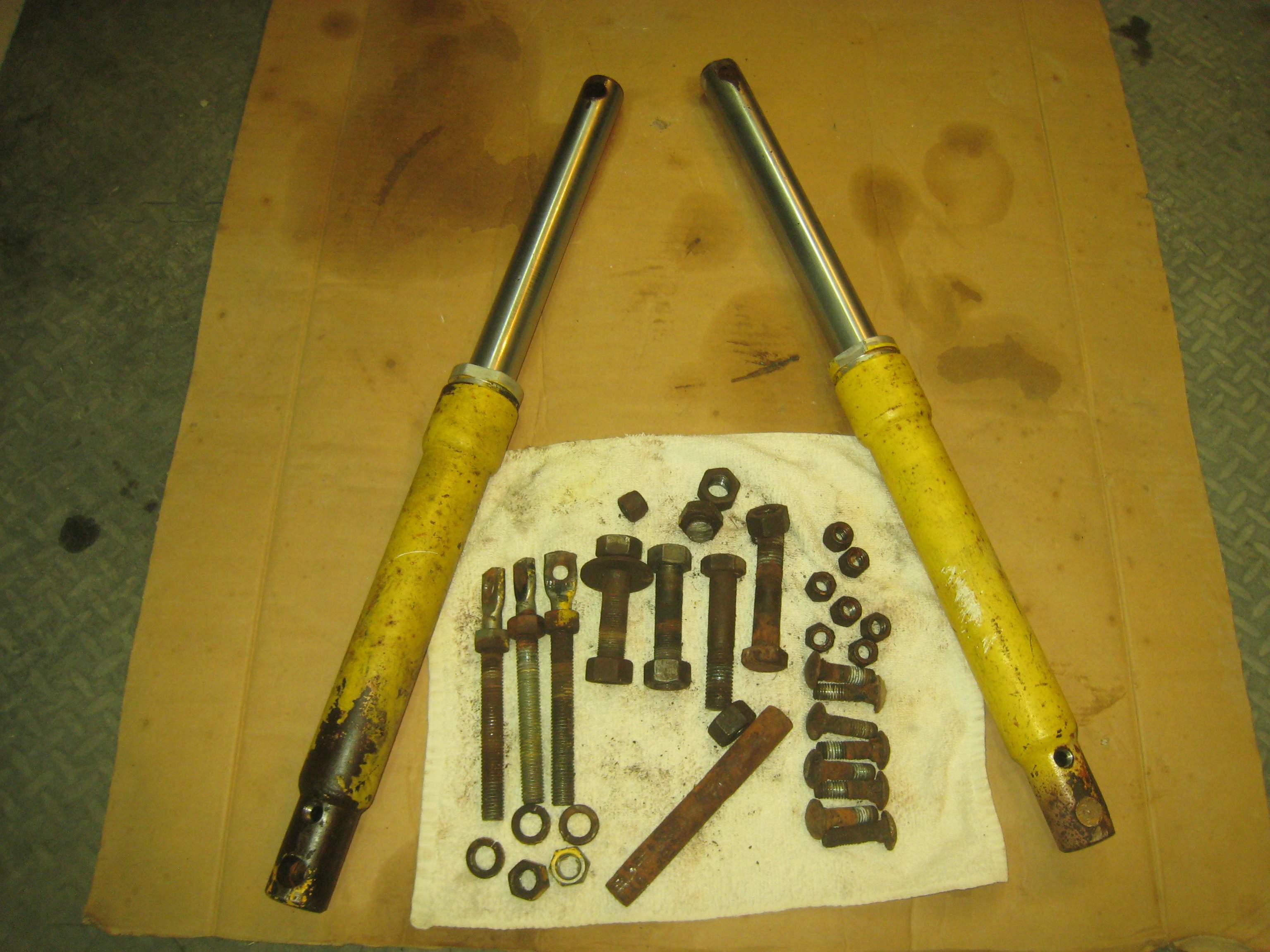

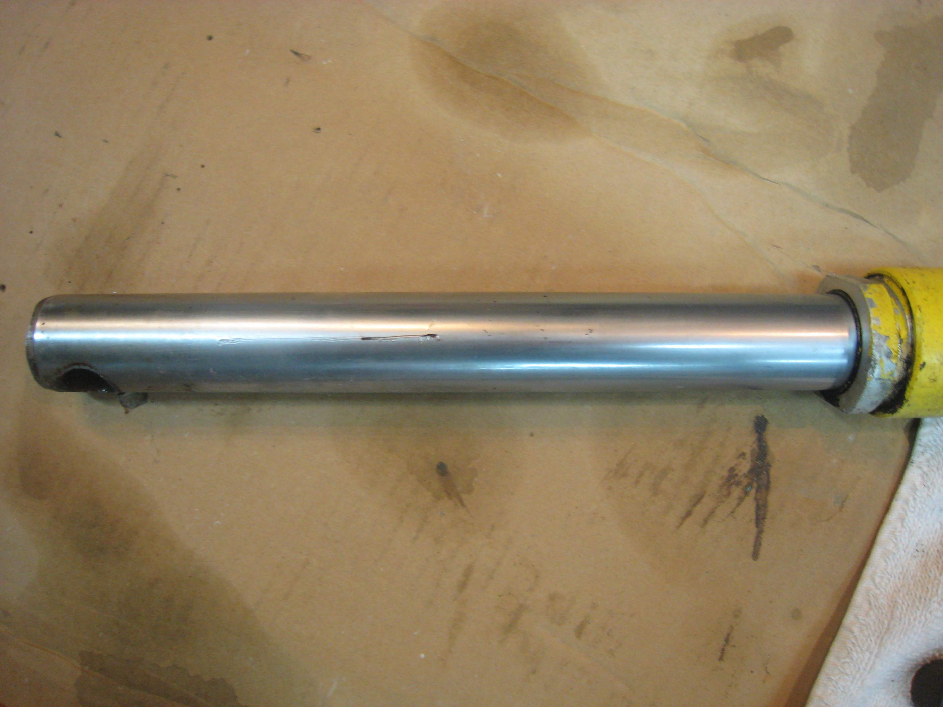

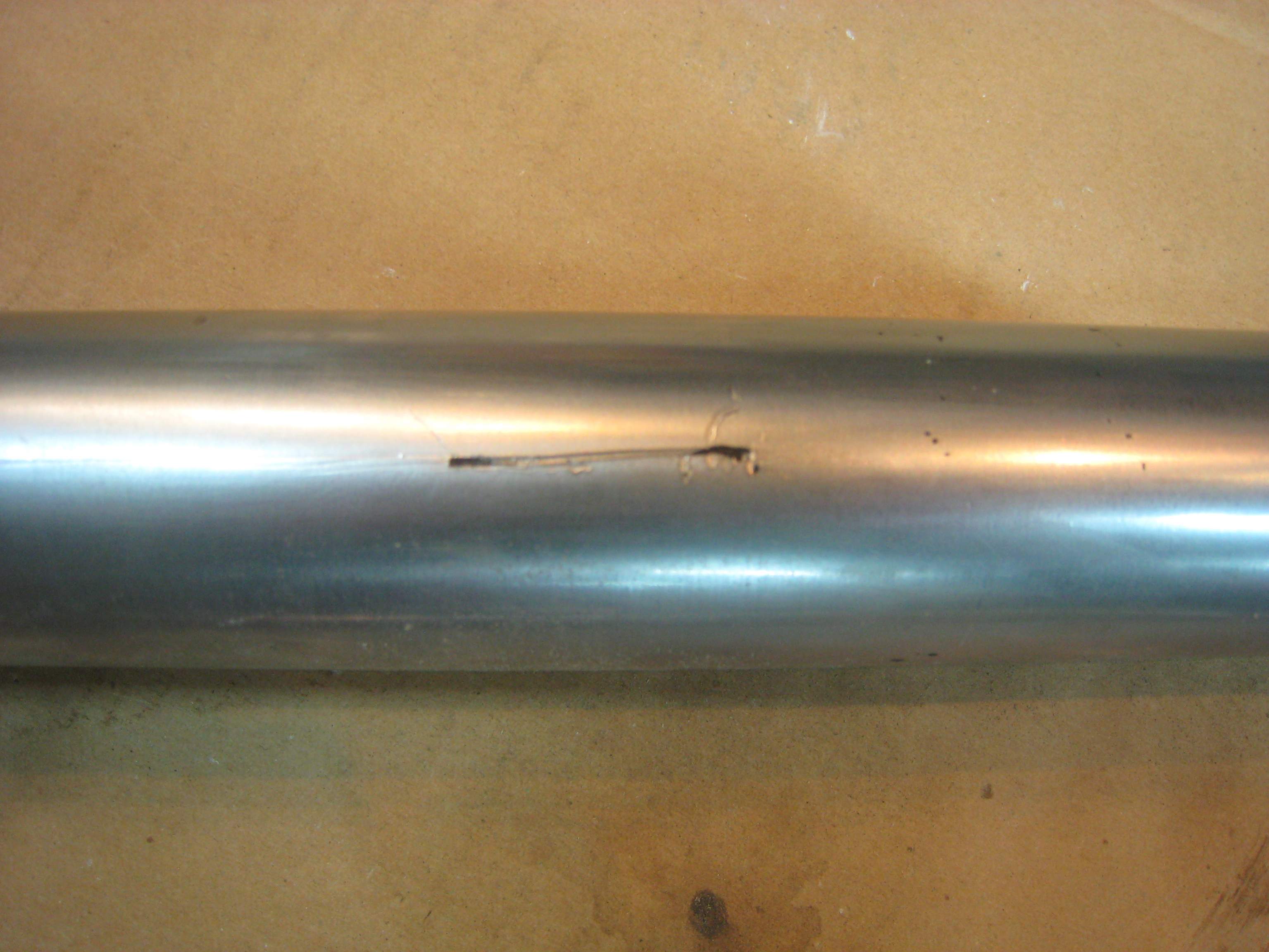

Not sure how bad the cylinders have to be before they would need replacing. Here are a few pics of the worst one. I was able to cycle the cylinders a couple of times and there doesn't appear to be any seals that are leaking. They were very stiff, but your technique worked like a charm!
Thomas I'm glad it helped you out. That looks like a deep mark on that ram. I personally wouldn't use it. There's nothing worst than being out having fun plowing snow then notice fluid leaking out of you angle cylinder and then having to return home only to find out you can't get one or it's going to take the afternoon to replace it. I think these items are cheaper to replace as soon as you see the problem. Just my 2 cents with again. I just like spending your money :).

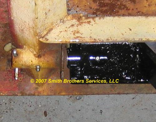

Here are a couple more pics to show you what I am dealing with on the sector pivot pin sleeves. You can see that the one pin has become fused with the sleeve. I don't think I'll be getting that out, nor do I want to!!
Thomas that's toast. Put new back. Those parts on there now have expired :)

As it appears, that scratch looks bad. However, only you can actually tell how deep it is. I would be tempted to takes some very fine emery cloth to it, and then polish it up with fine steel wool. You get it smooth enough and it won't leak much at all, maybe seep just a tad when that spot on the rod is sitting on the seal, under pressure. The ones on my plow rig are pretty pitted up on the top 25%. and they don't seem to leak at all, or at least enough so as to be even remotely noticable.
The rams don't experience a lot of pressure, especially if you change the plow angle with the plow off the ground. And when plowing, the ram which is all the way in (bottomed out) is on the end of the plow experiencing the vast majority of the pushing force.
Re the pivot pins, yeah, spend your $ there.

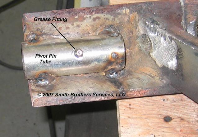

Q2: It looks like I have going to have to rebuild the pivot pin sleeves. I don't think the original had grease fittings - anyone out there every add those to their pivot pins? Pictures would be very helpful!

Q2) The pivot pins are ideally greased when installed and removed and re-greased each year. Obviously, yours was not re-greased. It is not unusual for the pivot tubes to require removal and new ones installed. Alignment is important for proper pin installation. Weld it up with the pin in place, prior to greasing.

Regarding the angle cylinders: There are nor seals on the end of the piston rod that would be affected by heat. These are single acting, displacement cylinders with the only seal being the packing at the end of the cylinder where the rod comes out. Small pits or gouges may not leak because the total length of the packing is almost an inch long. However, the gouge on your cylinder is quite long, and will most likely leak. You can try it and see, there is nothing to loose except a little time to change it out if it leaks.
