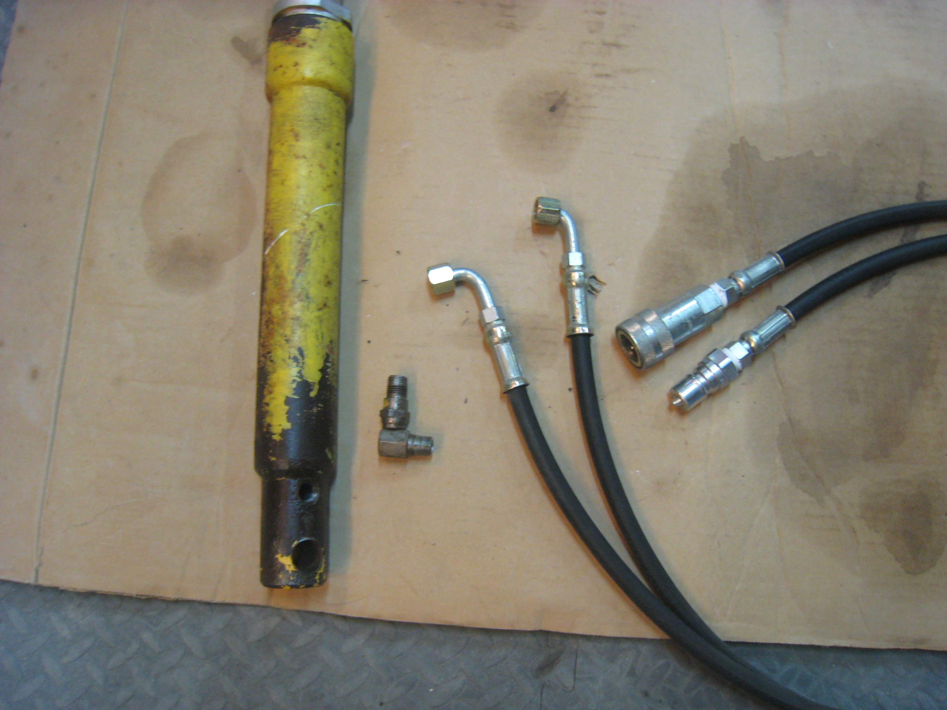

Ok, let's talk hydraulic hookups.
When I bought the tractor new, I had them put on additional front and rear hydraulic hook ups. This will be my first occasion to use the front ones. They are controlled by a toggle switch on the FEL control arm and the quick attach ports are mounted near the front of the FEL.
With the tractor, I received a set of hydraulic lines with quick attach fittings on one end and a 90 degree fitting on the end that would attach to the angle cylinders on the plow. So, my question is . . . What type of fitting would be best to use between these hydraulic lines and the angle cylinder? A straight male to male fitting?, a 90 degree male to male swivel like the one I took off (also in pic)?, or something else. I don't have to adapt the size since the hydraulic lines already match the cylinder (1/4" fitting I believe).
Let me know your thoughts!

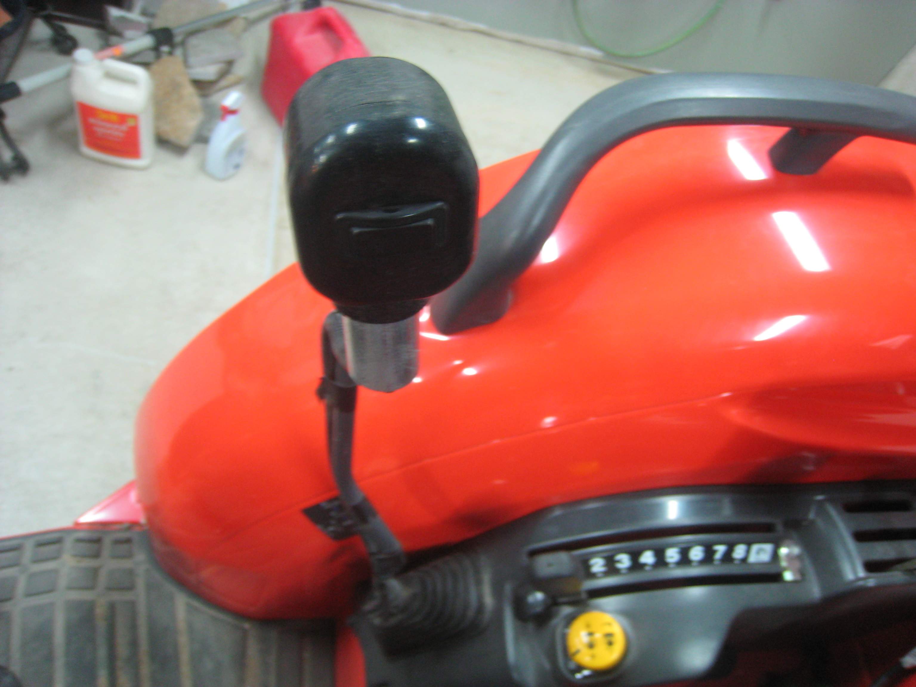

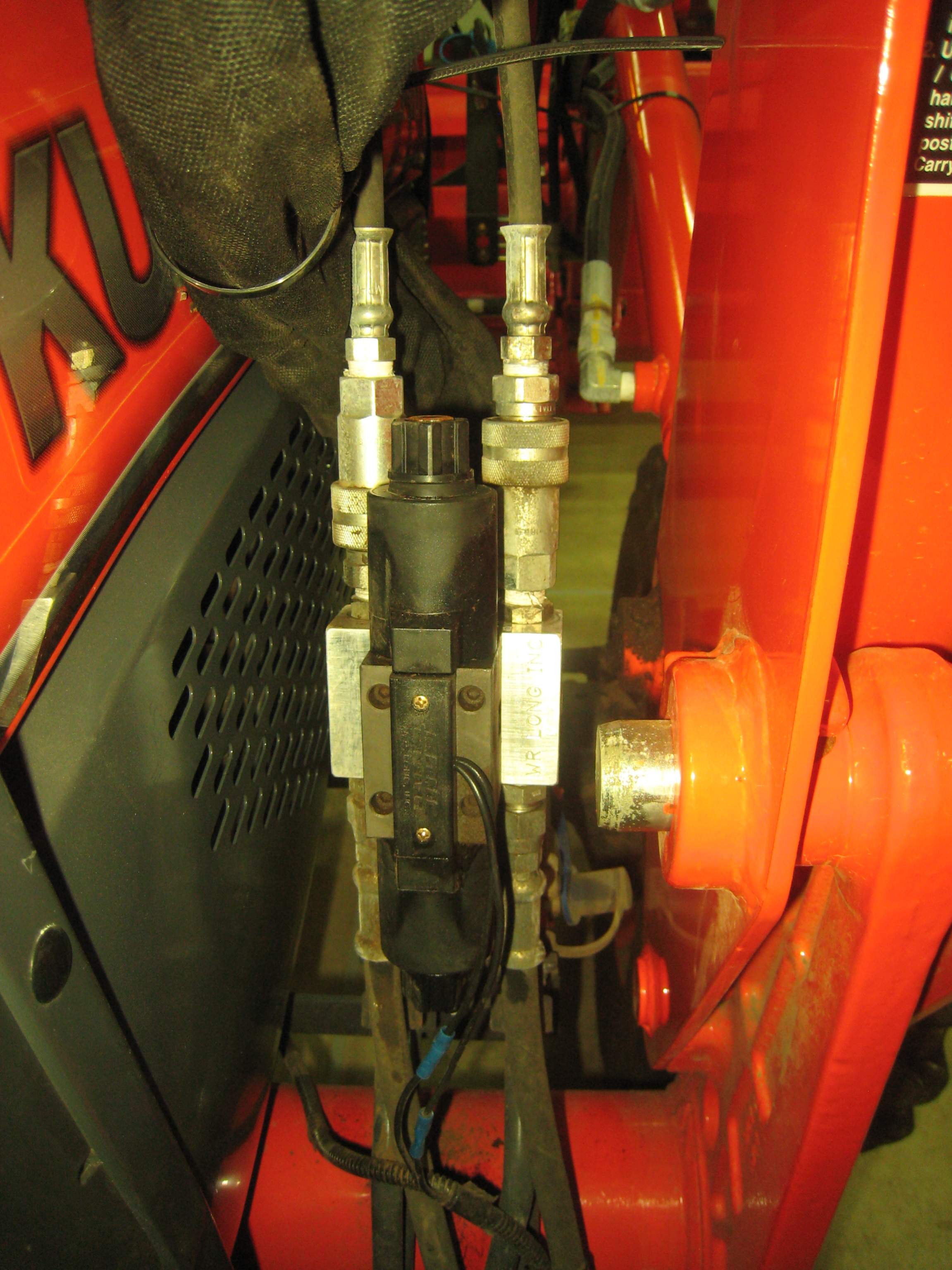

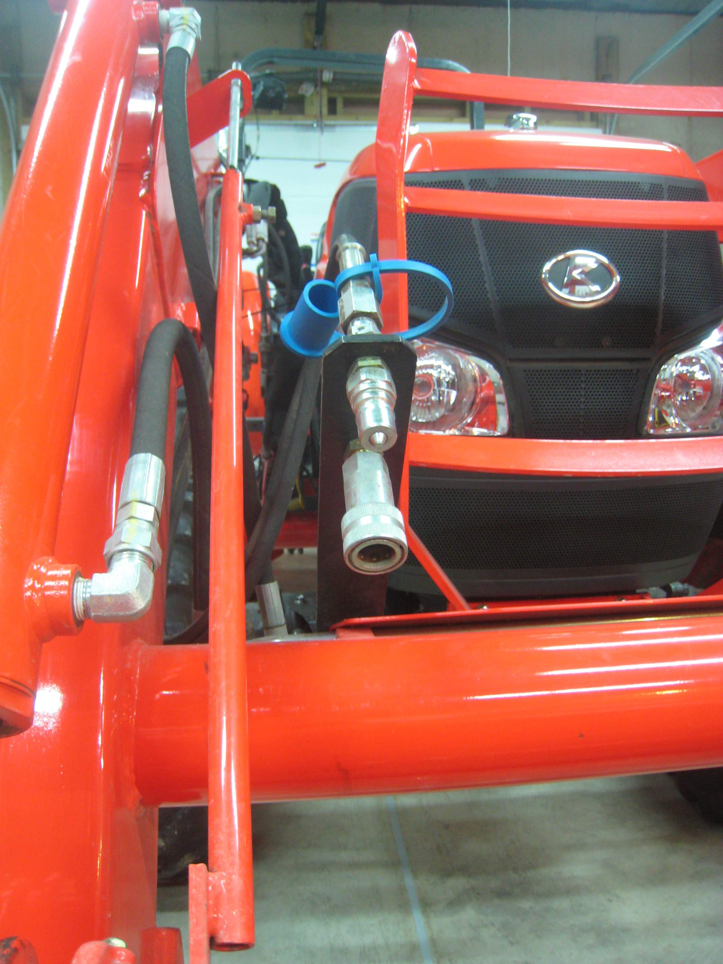

Here are some additional pics showing:
1. QA Hydro Ports on the FEL arm
2. Toggle switch on the FEL control joystick
3. WR Long Hydraulic System
