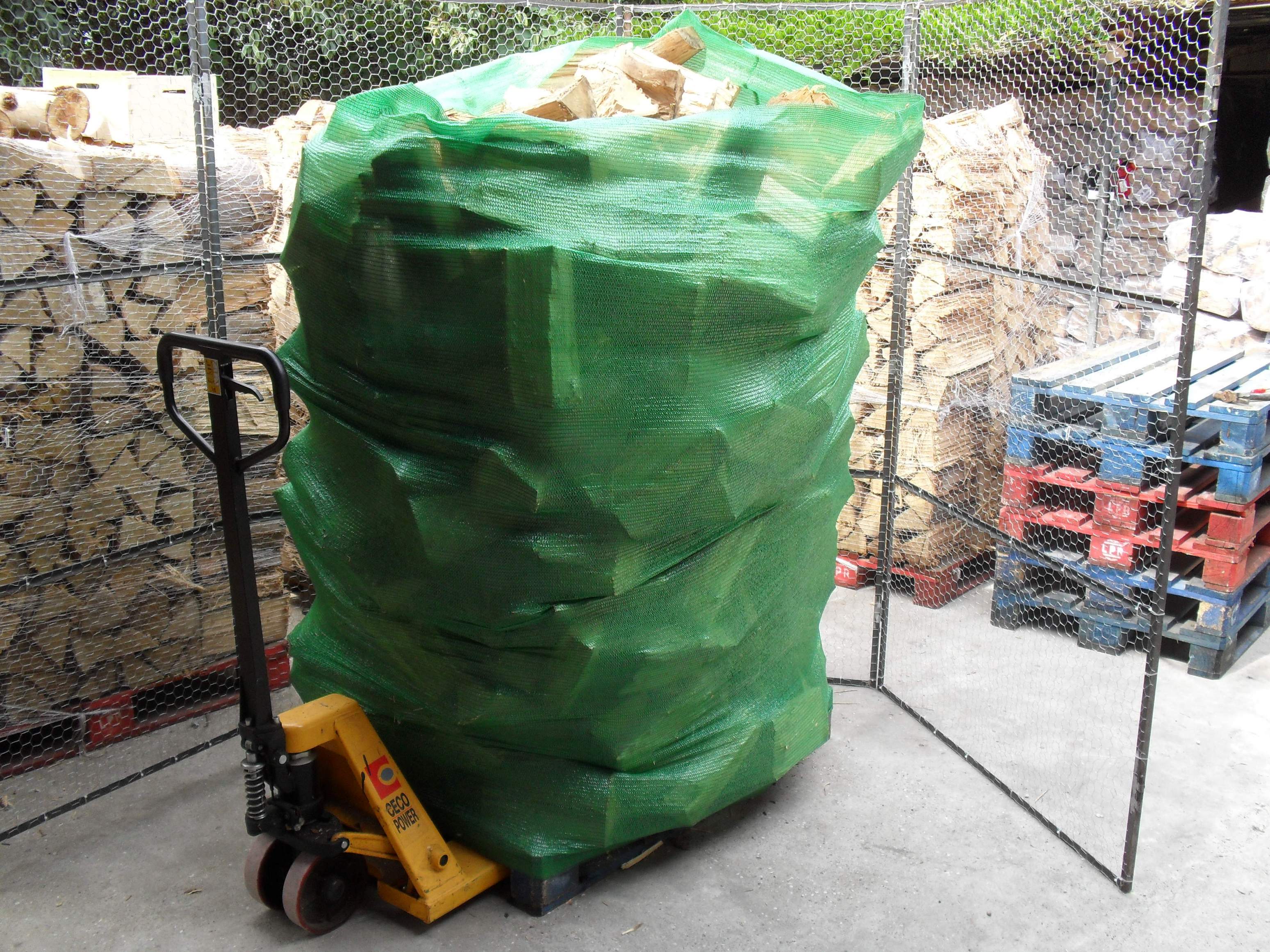

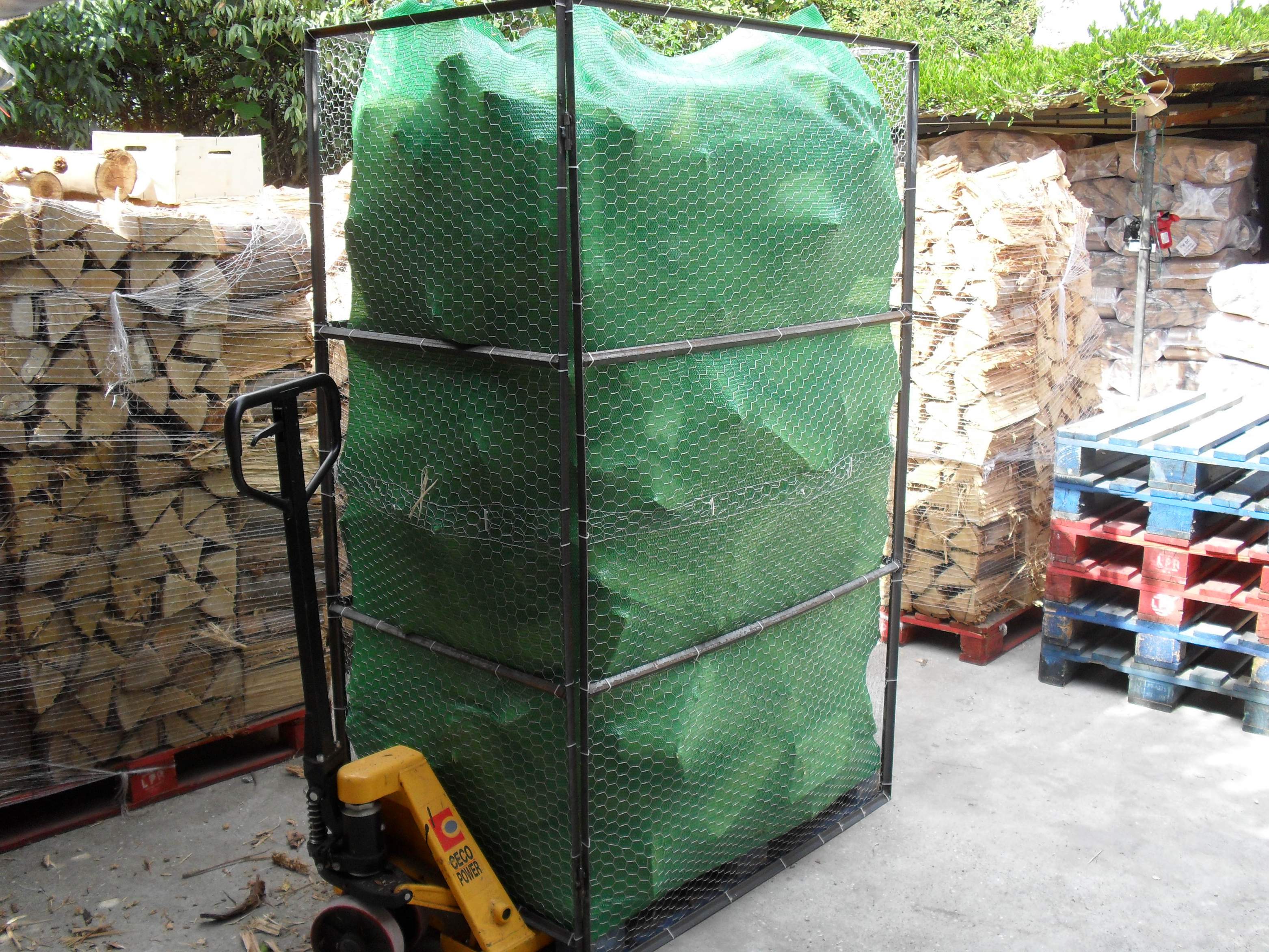

over this last years I tried out some diferent ways to put firewood inside something..now i´m working with improvised 2m3 round containers i made from steel wire mesh, on wood pallets..
- I already tried a system like the PACKfix from POSCH (https://www.youtube.com/results?search_query=packfix+from+posch), but with a square form instead a round one. Very cheap metod, as issues like the unpackage (the mesh grabs to firewood and it´s hard to separate them) and the mesh has to be ultraviolet protected, other wise you´re gonna have lots of them fall in the ground. And you have to "arrange" mannually the wood as the pack fills up, or you gonna have lots of "side holes" that will not help your Pack stay straight. The wood as it dry, "moves" itself, and if you don´t have a straight pack..some picks: SDC10153.jpgSDC11252.jpgSDC11387.jpg
-I tryed something like this too: SDC11077.jpgSDC11080.jpg
think this can work with the PACKFIX metod, but instead a mesh net, you can add a mesh bag like yours, and as the firewood fills in, the PACKFIX form rises up.
...working with a conveyor I figure out that is better if there were nothing in the end of it..the firewood piles up always in the same spot..if you have someking of piecelike you do to work with two pallets at the same time, you have to put some kind of stopper, to absorve the speed and descend angle of the firewood into the bags. I quit using this, think work better only with the conveyor and the right speed of belt travel.
Anyway, from your pictures, i think you will never achieve what your looking for..i work with 30cm log lenght cuts (thinks yours is twice long), and even so, for round containers with 1,25 cm diameter (round is better- as no corners ;), i have to sometimes put my hand in there to arrange the wood..I tryed out with larger containers and figure out that larger is better..in your case, i think for the lenght cut you are working with, you will need bags with 2 or 3 meters wide :)
