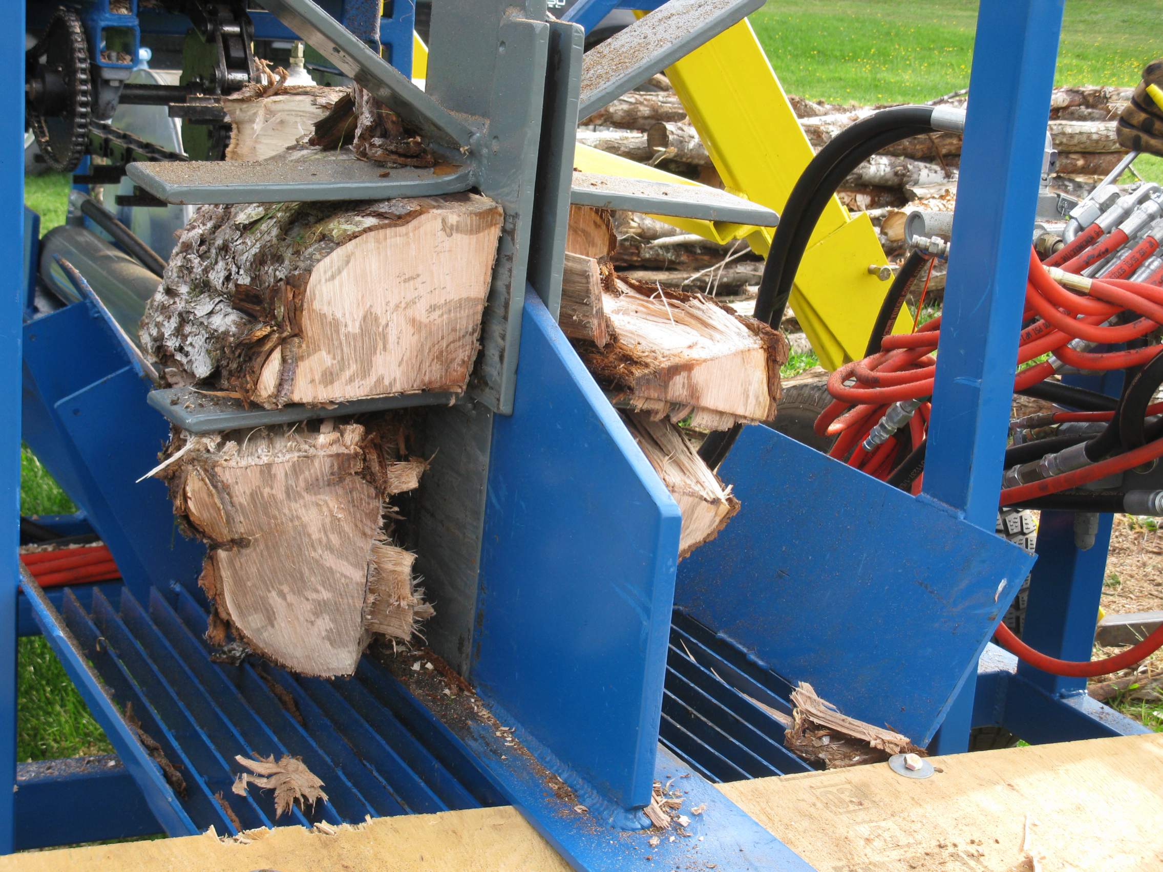

Put the first log through the processor this evening. Made no adjustments to any valves as of yet. Still have a rats nest of hoses. Waiting to see how things come off the wedge before we build the splitter outfeed grates.
How'd it run? Not too shabby...

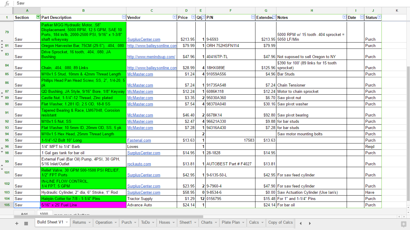

Here is the parts list. As mentioned before I would now go with a hydraulic motor that is one size larger in displacement to get more torque.
Lastly, when cut our log will drop about 27-1/2" to the beam.
