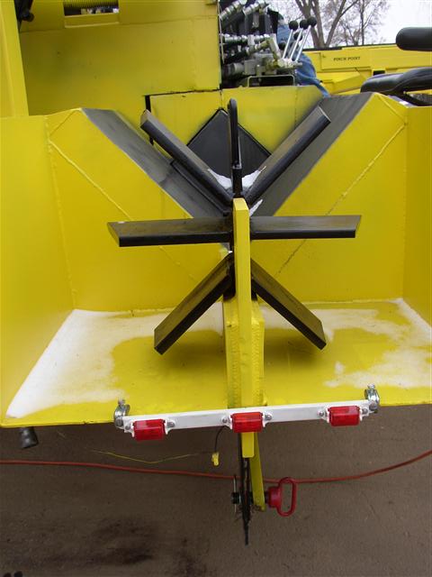

Pusher plate (which is 20-1/2" tall including the plates at the bottom) has its roof on it. This will allow us to simultaneously split and cut. If a cut is finished before the ram is fully retracted the log will rest on the roof and drop off into the splitter once fully retracted. It works in my mind, we'll have to see how it works in reality...
Pusher plate has grab hooks welded on either side in case we need to pull a log back out of the wedge.

Yes, it only travels to horizontal. A good distance above the pusher. Should be 4+ inches above.

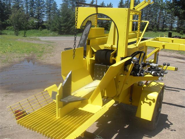

ITS ALIVE!!!!
Got the last of the lines installed tonight and fired it up. Had two leaks that were easy to fix. The oil filter and a fitting that wasn't tightened. Not bad at all.
We got the bar oil pump primed late so we did not put the chain on. Motor at least spins though. Looks like we will may take the needle valve and the check valve out of the line for the bar oil. Seems to have a nearly perfect flow without them in the loop.
Our biggest issue is that the I-beam bends way too much! With the splitter valve relief set at 2000 psi we saw both ends of the beam flex and we saw the beam twist near the rear mount. Not good at less than 20 tons, really it was pretty scary! We are going to box the beam in on both sides. Probably with 3/8" so that it looks like this

Put the first log through the processor this evening. Made no adjustments to any valves as of yet. Still have a rats nest of hoses. Waiting to see how things come off the wedge before we build the splitter outfeed grates.
How'd it run? Not too shabby...
/ Another Firewood Processor #100
Good job. Seems to work pretty well definitely faster than a chainsaw a splitter. :thumbsup:
