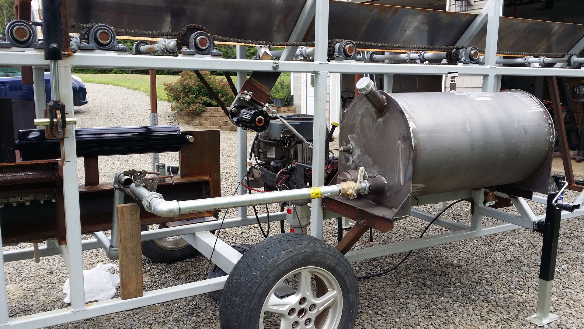

Hydraulic tank:
Here is the end plate with 3" suction port (we have a suction strainer that will go in and reduce the opening to 2") 2" return port (will be reduced to 1-1/2), 2 " fill port, and a port for a temp gauge.
Here you see we made a baffle right above the suction port on the inside of the tank so that it can't create a vortex and suck air.
Here is the longitudinal baffle inside the tank which makes the fluid run to the far end of the tank and back again to get from the return to the suction port.
Finishes tank with a 1/2" breather port in the top and two 3/4 drains in the bottom.
Here it is mounted on the processor. The return is plumbed in for the most part. Misssing the oil filter in this pic.
Picture of the return manifold from the other side.

Pusher plate and ram are in place. We have welded on some scraps of 2" square tube to hold the logs during splitting.
Infeed trough has the plates welded in place.
Fuel tank is mounted
Engines are welded in place. Had the local exhaust shop bend and swage pipe to fit the two engines. Didn't want exhaust running into the fuel tank or the block of the other engine.

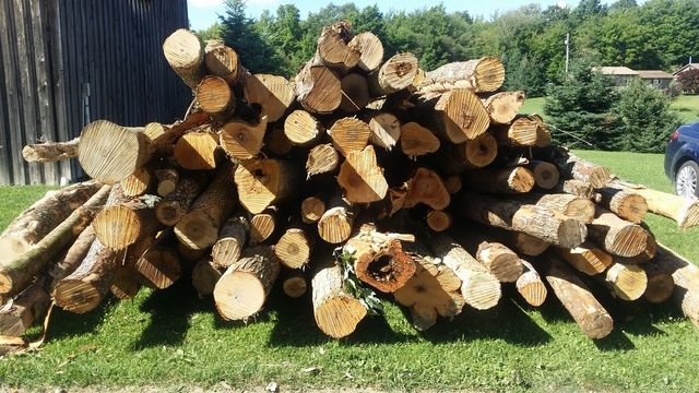

First load of my logs are delivered and wouldn't you know it... It's got the smallest diameter stuff that I've ever received.

How tall is that pusher block? It looks really tall hopefully you won't have a problem with it bending in at the top like I did with mine. Looking good though.
