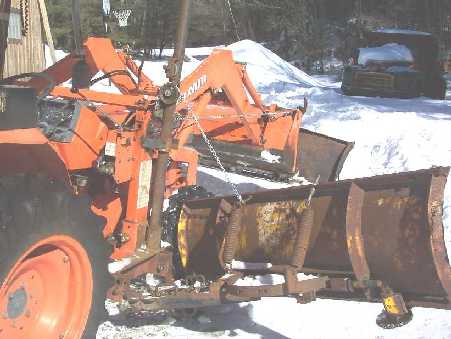

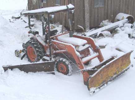

Hi,
Here is how I am dealing with the NH winter. I whipped up a wing blade for my machine just before the first snowfall this year and boy am I glad I did, It excels at "half mast" pushing back snow banks. I would have been doing alot more loader work if I hadn't rigged it up.

Shinnlinger,
Thanks for the pictures....looks great! How much does the wing push the tractor, or does it at all? It also looks like you have a nice rear blade with adjustment wheels? Do you clear the drive (also curious about the size of road or driveway you have to clear) with the front blade and wing and do clean up with rear blade or....I guess I'm asking how you use the various tools in combination? John

John,
I only use the front blade for clean up or pushing straight ahead into a pile.
I have quite a bit of driveway between my place, out to the mill and up to my parents. on a one lane driveway I can use the wing and the rear blade angled the other way to clear a 12 ft path in one go, and then I will ussually wing back the other way and push the snow over the top.
I welded wheels on the rear blade so that I can lenghten/shorten the top link to raise and lower the blade to control it's bite. It is nice when the ground isn't frozen yet but you still have 6 inches of snow to deal with and you dont want to tear up the yard. I also grade my driveway with it in the summer. With it running the opposite way of the wing and having the straight ahead blade on the bucket, I have all my angles covered.
I have been really happy with the wing and I cant reccomend it enough. If you use your tractor for snow removal, you really need to consider one. It works really well at pushing snow banks back. It can push me sidways, but I just rasie it untill it stops and come back for another pass if necesary. I raise mine by rolling the front bucket, and it works so well that I wouldnt bother with putting hydraulics on it even if someone gave them to me. It is also nice to be able to see exactly what you are plowing, because you are sitting right up on it.
Using a truck plow isnt as ideal as a gimballed wing setup like a highway plow truck, and I did have some issues, but it was pretty easy (and extremely cheap) and lends itself well to tractor use as there arent as many fixed points on a tractor.
