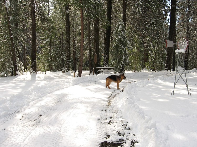

I couldn't wait until spring to try out the wheels. Used them for plowing the driveway. They worked great. Set the blade angle reversed (backwards) at one notch and the wheels offset to match. Set the wheels so blade was about 1 1/2 inches off the floor when tractor was on shop concrete. Only scalped the gravel drive in a few spots; very minor.
(in this photo the 3PH is in raised position)
   / Another Gauge Wheel Build Post #38
I got my wheels done before the weather turned bad, but I did sneak in some grading when it was in the 50's earlier this week, then back to hibernation for me.
Good looking dog, too.
