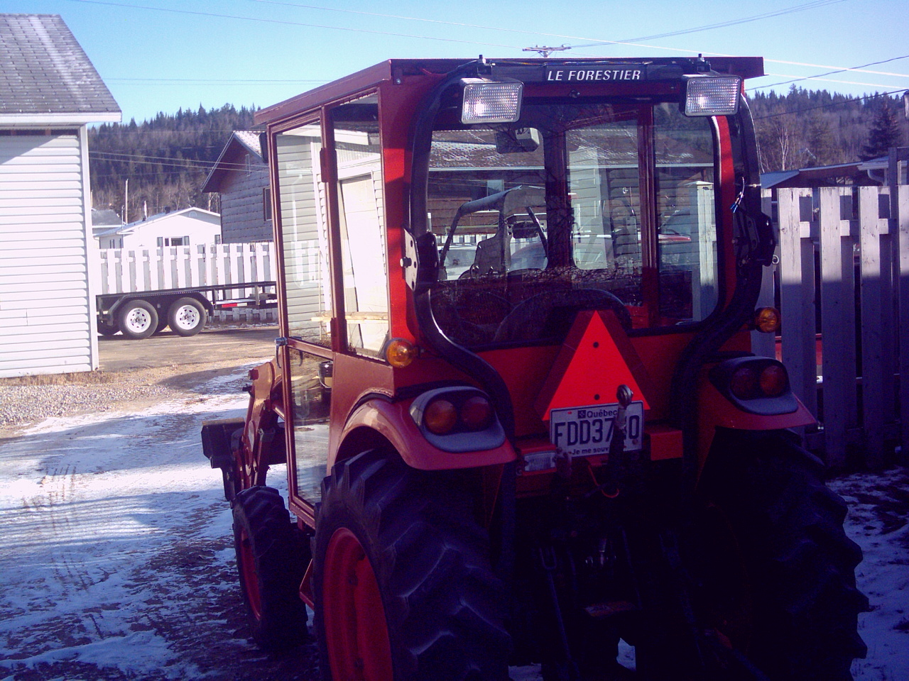

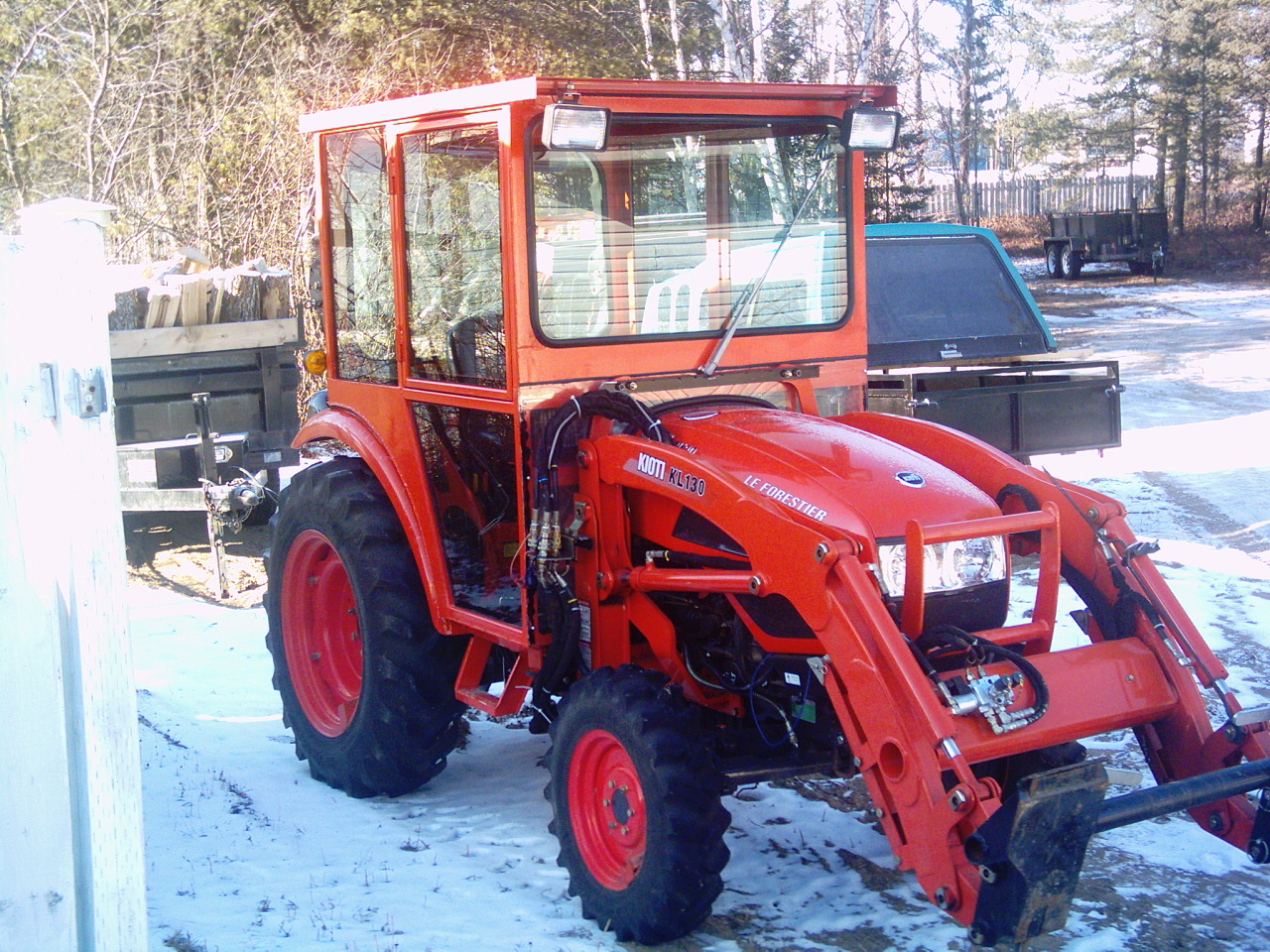

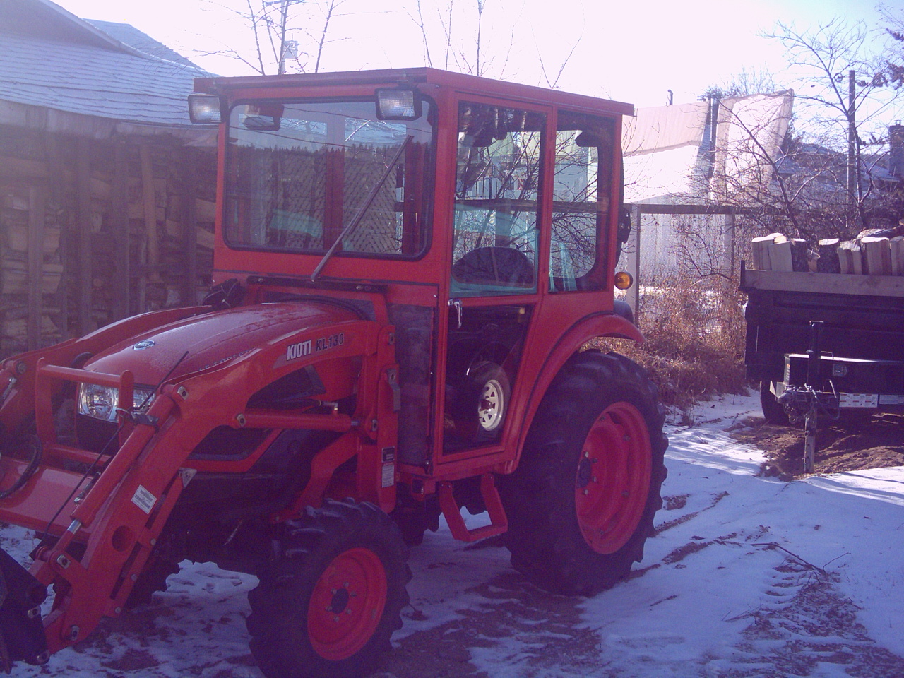

Ok now that i got my tractor back with windows installed, i guess that means i'm pretty done with the project, thanks to all the help and advice. :):thumbsup: Now where is the snow...:confused: can hardly wait to start plowing:laughing:

Looks great, now if it ever snows this year you will be lovin' it........Craig

Very nice Karl, you made much better time then I did on mine. Every right to be proud of it.
   / Another home made cab tread #27
That's got to be the nicest home made cab I've seen.
Looks as close to factory as you can get.
JB
   / Another home made cab tread #29
superb job! what a great feeling it is to save so much money while building it exactly the way you want it. this forum rocks!:thumbsup: let it SNOW!
