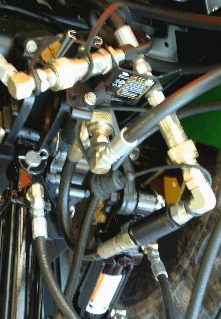

Thanks to liledoun, I have finally been able to piece together a top & tilt setup for my JD 4300. His post "My homemade TopNTilt/4th&5th control valve" helped me figure it all out. I actually finished the project a couple of months ago, but finally got around to painting everything this past weekend. All I can say is what a difference when using the box blade! Here's a pics of the tilt cylinder that I got from Prince.

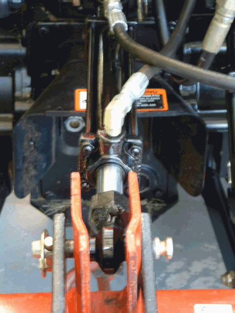

Here's a shot of the top cylinder (a bit blurry). I picked it up at Tractor Supply. The end is just a weld on CAT 1 welded to a nut that is threaded onto the end of the cylinder.

Here's a (fuzzy) shot of the plumbing. I tied everyting into a JD power beyond kit. Pretty simple setup.
Thanks again to liledoun for all the info that made this a pretty simple (but sorta pricey) project!
