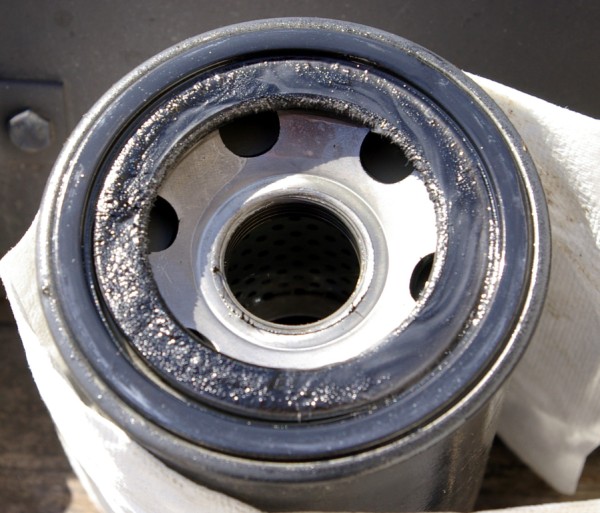

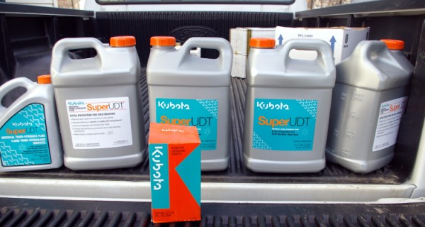

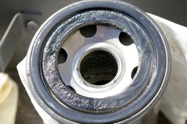

I just did my 50 hr fluid changes on my GST 3130. Two dealersd said to use only the super UDT for the tranny and rear differential. They said you could use regular gear oil or Regular kubuta UDT for the front axle and that is what i did. Also have to remember the wet brakes....After payiny good money for your tractor what's the difference of a few more bucks for the Super UDT if they say it's really needed. Why take the chance? I had a lot of crap in my hydraulic filter after my 50 hr maintinance.
