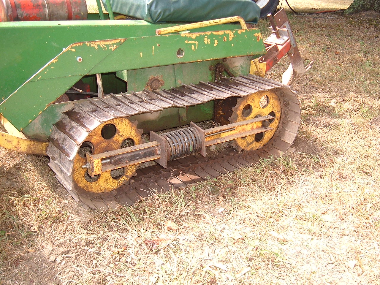

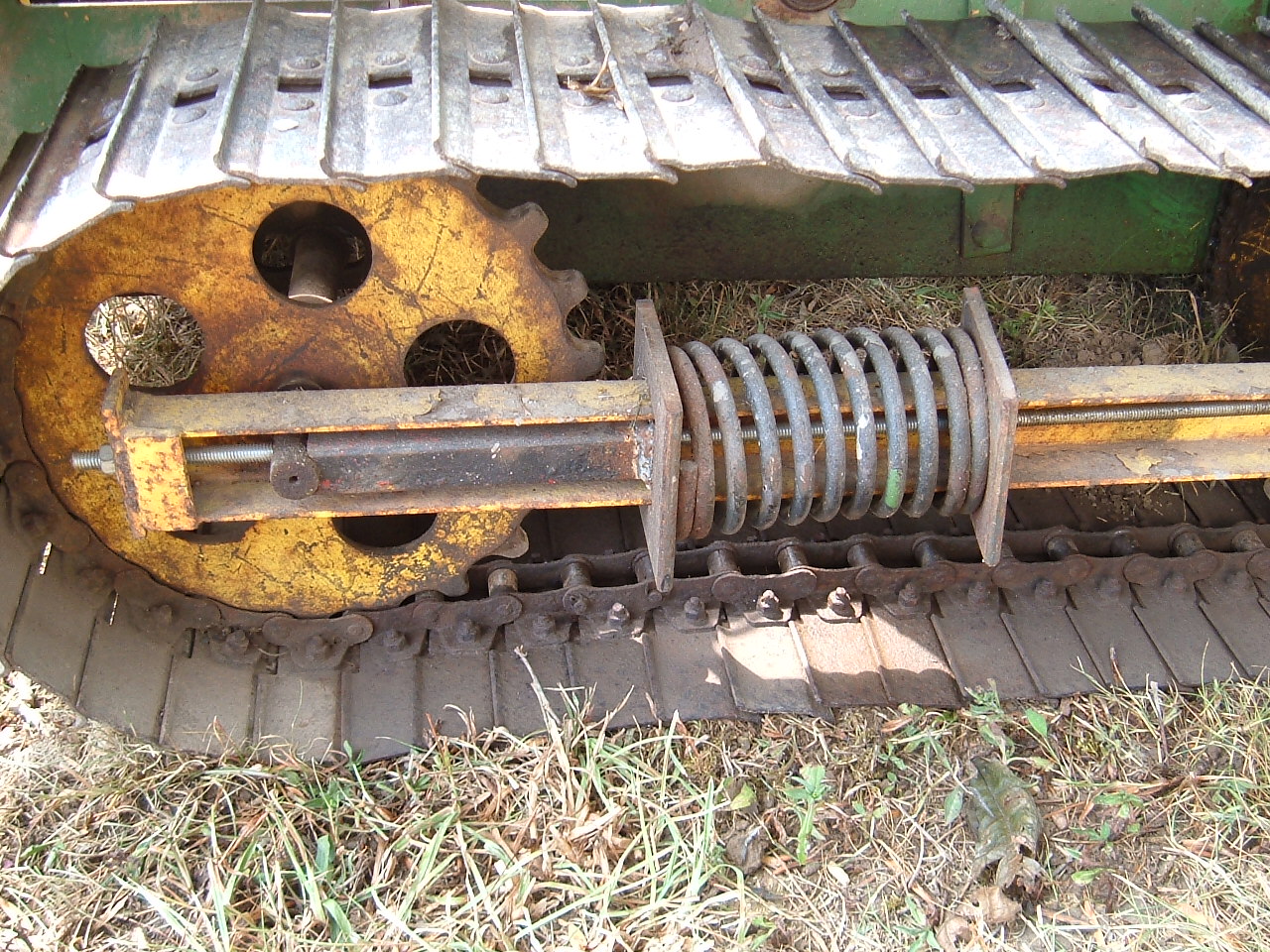

I'm a little late to this BBQ but I'll add my $.02 to the mix. I've been working with Mini Dozers since 1969. They do have some problems. The original design had a bolt for track tension. All it took is a small rock in the track and it parted company with the machine. I tried a recoil spring like you have but found it to be too light. I finally used a set of rear springs from a Chevette. However, provision for must be made to have enough preload on the spring and keep that preload off the front axle. High tension on the track leads to premature track failure. If I can get some pictures of the set up, I'll post them. As the tracks wear they can snake sideways and derail. If you use conveyor belt (think snowmobile track) and put holes in the channel cross pieces to engage the sprockets it will help with keeping the track straight. It will also let the sprockets push the snow and small rocks through the holes. The machine can get a bit jumpy if you are heavy handed on the controls. It takes a light touch. I've tried idlers for the top and bottom of the track, but found they weren't worth the effort. It is a "Cute" machine it works well for spreading gravel, loose top soil and plowing snow it definitely beats a shovel.

You might think a bit about the your track tensioning spring. You don't want full spring tension on the track all the time. Running the track "Tight" will wear it out quickly. The picture I'll post will show a Chevette rear suspension spring compressed to provide movement when a stone etc. gets in the track. However, it doesn't hold that pressure on the track all the time. Inside the square tube is a stop, the all-thread provides a means of tensioning at the rear of the spring, without putting that tension on the track. The nut at the front of the all-thread is tightened only enough to get the correct "Slack" in the track.
