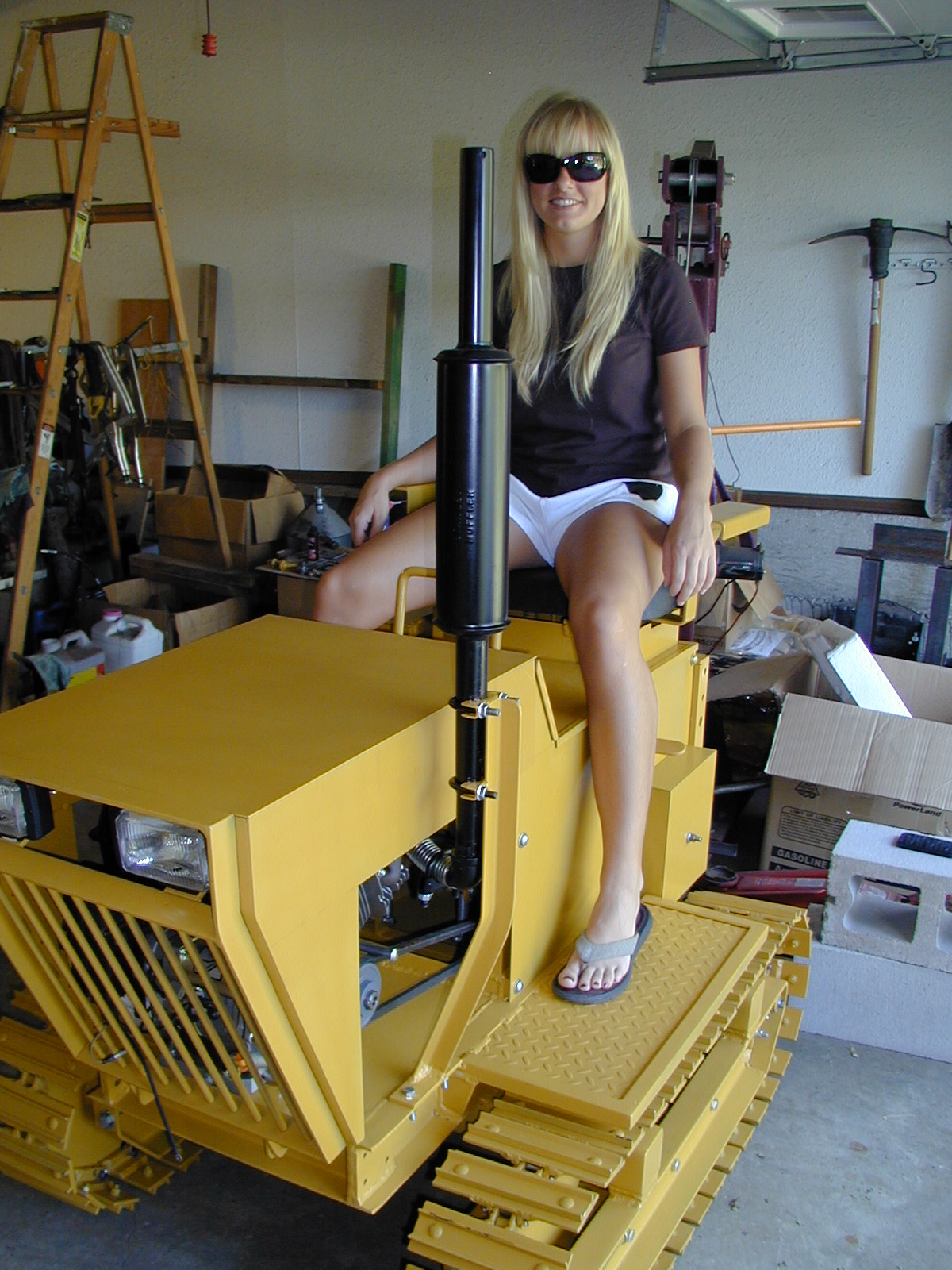

I have finished installing the additional bogey wheels which I had mentioned in my 2nd from last post. This should take the sag out of the track and relieve some of the stress on the individual links. I had posted my project on a welders web sight and one of the members spotted a problem, which, luckily, I was able to easily correct. :) He noticed that I had installed the engine-to-jackshaft idler pulley in the wrong location. Since the engine rotates CCW, the idler pulley should be on the return or slack side which in this case, is the bottom side not the top. If all goes well, I should be able to post a video of it in action soon.

   / Another Mini-Dozer #333
If anything hard gets picked up in the track and carried forward, it could jamb against the deck support directly above the wheel. Looks like a pretty tight shear there. Could bend or break something if that should happen. Maybe the wheels should be heavily sprung so as to give way.
   / Another Mini-Dozer #334
I second that.I also think the bogey wheel should be able to rotate forward, and down, to allow said object to clear through,and the bogey to spring back up into position.
   / Another Mini-Dozer #335
I would make it sprung to go straight down (or either way), as the same thing is possible in reverse.
Whats the matter, don't you like my mud scrapers ? :D.... just kidding....yes, I agree, it probably will be a problem area. But I am going to test run it some more first.

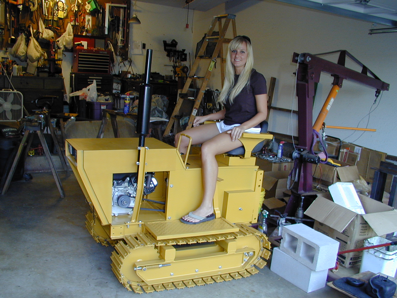

I need some advise. I may have asked this question once already. I apologize if that is true. In the photo below, the dozer is up on blocks. Notice how much slack that there is in the track. Do you think that I should run it like this or should it be tighter or looser ? Thanks in advance.
My uneducated, unexperienced, speculative advice is to run it like it is. If you see some evidence of slipping or slop, then you can tighten it.
   / Another Mini-Dozer #339
I think it should run like it is. Any tighter it will give you problems of binding. Like any chain it should work best at a slightly loose setting like you have. This will help compensate for rough ground, rocks and turning.
Just my $.02
Chris
   / Another Mini-Dozer #340
It's hard to tell since it's on blocks, but it looks to me that there is to much slack as compared to my full size dozers. That said, I'm not sure how strong your idler spring is. Do you have another shot with it on the ground? On mine, i run just a slight amount of droop between the sprocket/top roller/idler. Any less and she'll want to roll off the front idler when back dragging. Then again, you have a front "sprocket" and that might not be an issue...
