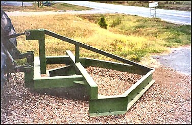

I thought I might have a lead on a pan, but when I went to look at it, it was a "Jerzee grader" brand of grader.
Looks kind of like what a pan might look like, but the holding section has no way to hold the dirt if it is picked up. It merely fills up the box with exess, and drops it when it finds a hole.
This one looks like it might take a dozer to pull it. I don't think my 70 hp JD is going to pull it, unless I am totally off base on it.
David from jax

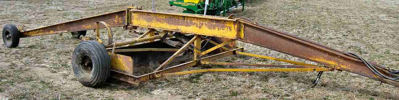

/ Building A small pull pan Type scraper #79
David, it seems that the machine you describe is the same as what i called a "bottomless scraper" in my previous post. In Holland we call that type of machine a kilver box but i dont know if theres an official English name. It's allmost the same as a pull type box blade.
/ Building A small pull pan Type scraper #80
In a very loose sense of the word, you could call this a box blade. It is more of a box than the traditional box blade, with about 3' sides. A cutting blade at the rear of the box, that piles dirt up in fron't of it. It has wheels that are mounted behind the box, giving it an ability to control the depth of digging. Across the front of the box there is a location for a pin, which I assume to be for a drawbar to hook up to. It also has two arms which fold inward in the front, that MIGHT slip up under a tractor or dozer giving it some sort of guidance or strength (not sure why they are there)
I have requested pictures from the owner, for me to post here.
David from jax
