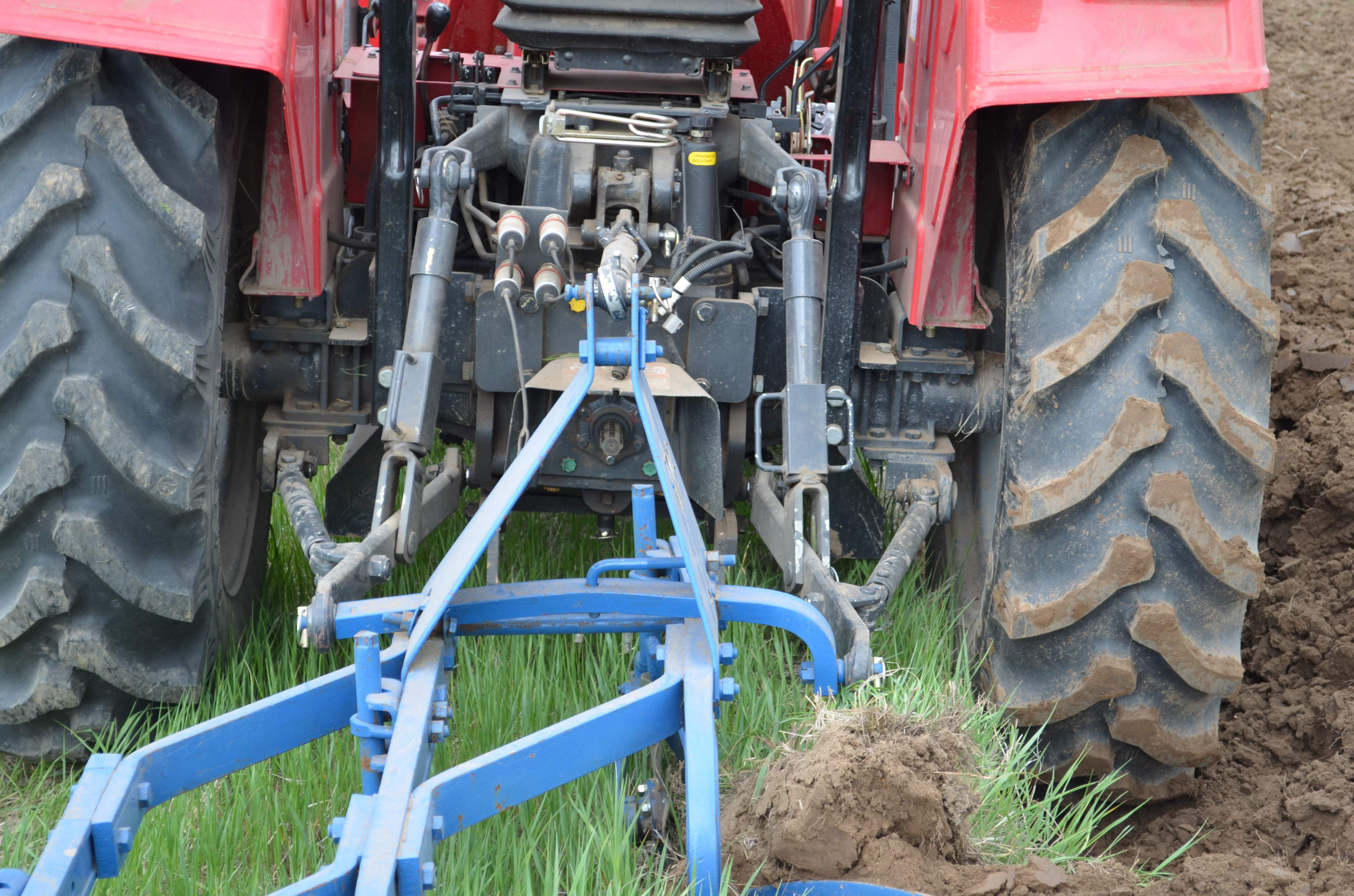

Mearntain,
1. Left side of tractor both wheels up on your 7" blocks.
2. Lt lift arm is totally collapsed. Stays here while plowing.
3. Top Link to level plow front to back. Measure length from center pin (tractor end) to center center pin (plow). Write it down for future setups.
4. Rt. lift arm to level plow right to left. Measure this lift arm and write it down. This is the length of the Rt. lower link used AFTER you have made your first run
of plowing.
5. Get plow to be center lined up with center line of tractor top link. Step back from the rear of the plow to visually see this line. This where the cross shaft
adjustment comes into play. Get adjustment close as you can and field adjust in the field after you have plowed a short distance in a furrowed row.
When you open up a field to plow their is no furrow to have the tractor to drop into. So your first run is with a different RT. link setting. You will need to extend the right link to level the plow for this first run. Then return the link once you have the furrow to drop into. Fine tune adjustments as need but Left Link stays collapsed... Plow should follow directly behind the tractor as seen from a distance from the rear of the plow.

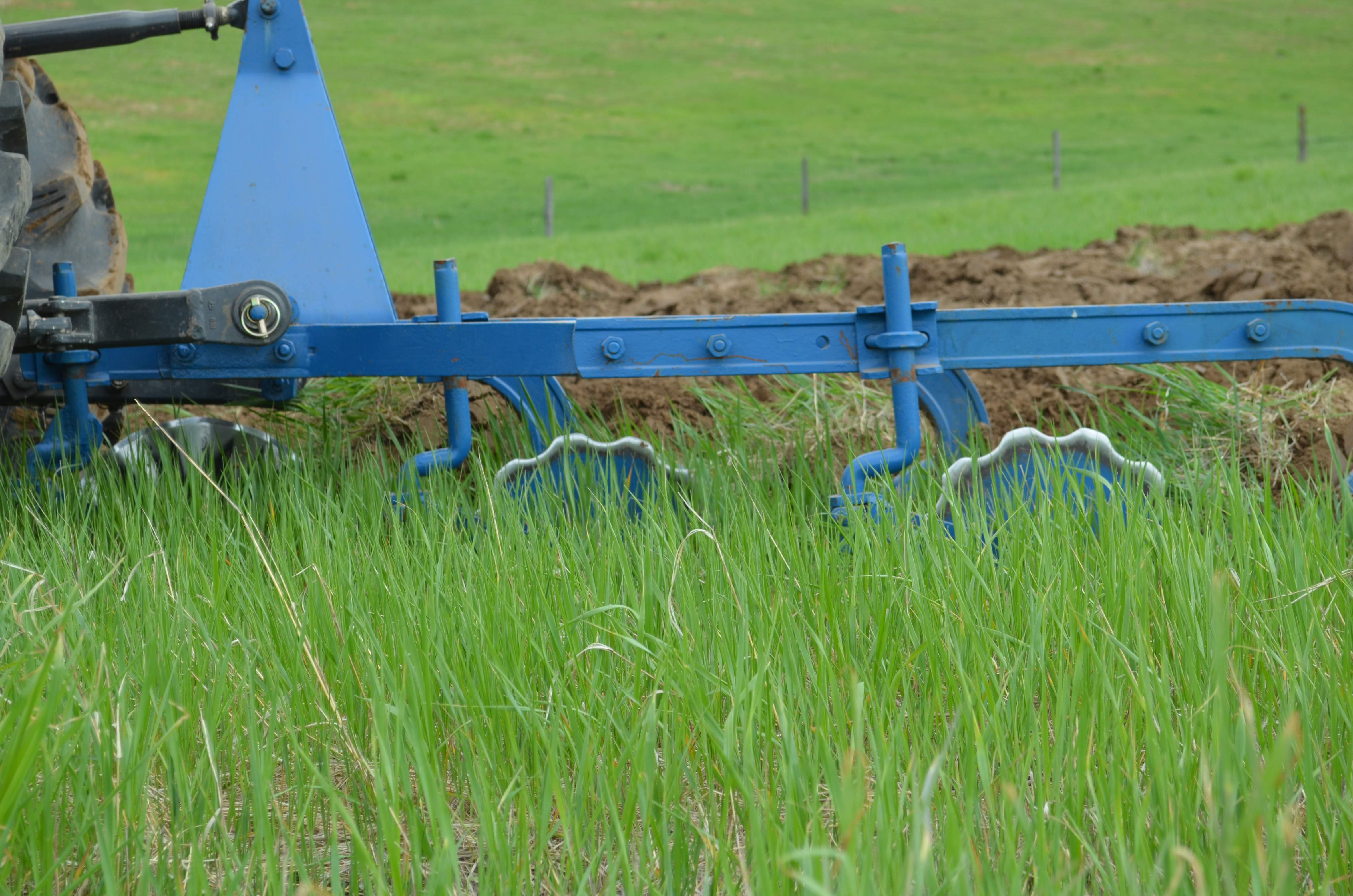

Hope this simple explanation helps.
idaho2

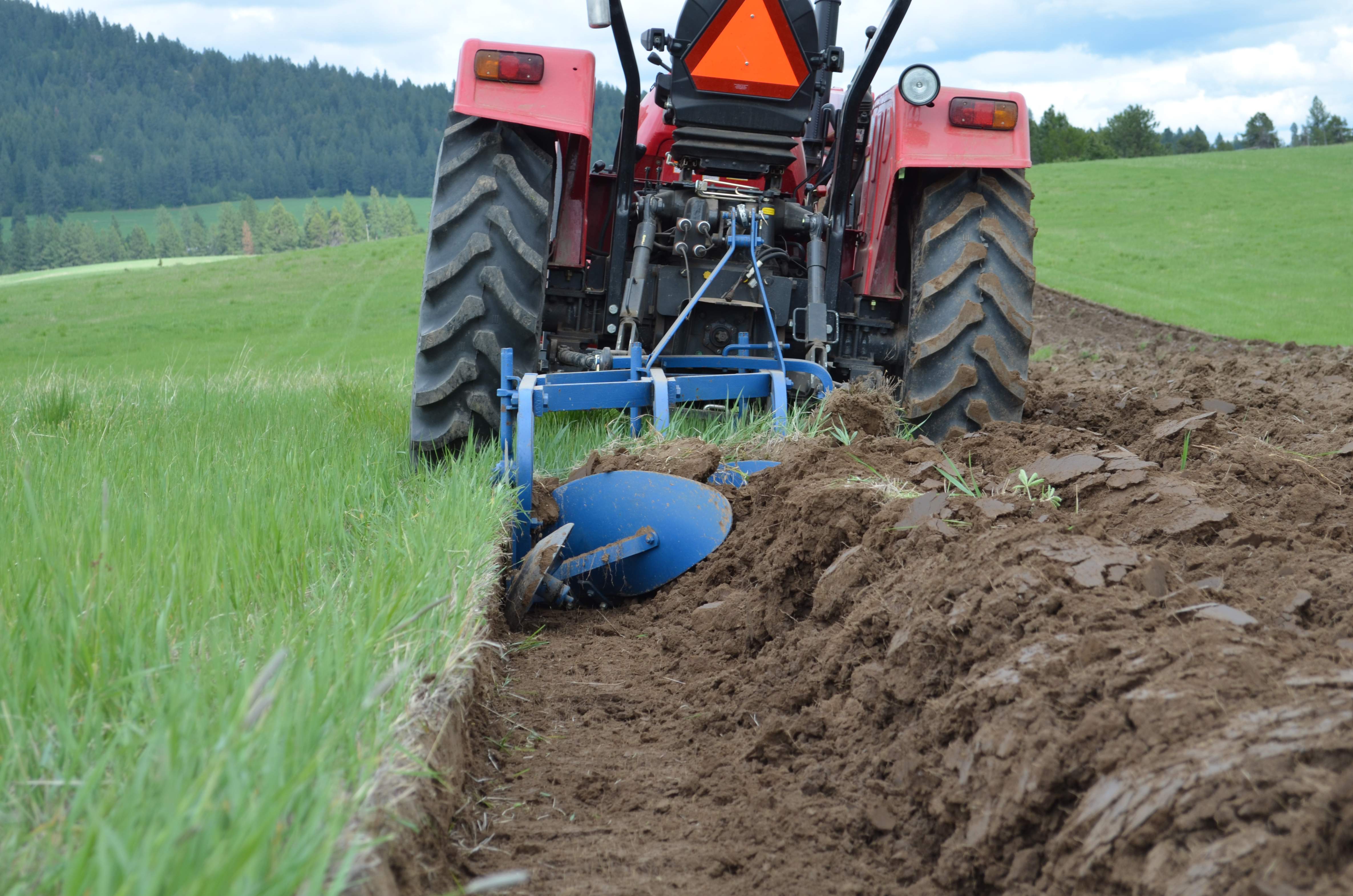

Thanks for the very detailed explanation and pictures. I think I've come very close to having it set up right, but I think it could do a little better. I got everything lined up with the centerline, or so I think I do, and it wants to pull to the left with the top link angled, not pulling straight behind. It starts off cutting 14 inches, but once it pulls to the left it seems to cut about 12 inches. The ground seems to be plowing decently, filling in most of the previous furrow, but not completely and occasionally missing a couple inches of ground.
When you say make the adjustment with the left lift arm completely collapsed, what do you mean by that? Imy pretty sure I don't have any adjustment for the left side. With all the blocks I had available, I was able to to get the rear tire at about 7" and the front at about 5.5" off the ground.
The settings I had were the top link at about 26 1/8 in and the right arm at about 2 1/8 inches. I ended up moving the right lift arm pin to the front hole as that seemed to have it mostly straight. I also sleed the cross beam to the right slightly so that the lift arms were both at about the same angle to the tractor. Heres a pic of how I set it up. Does anything look out of whack to yall?

Sorry to hear that is was sprung.
If the loops on the right rim are set on the outside of the wheel disc, you could gain a couple inches of adjustment by setting the loops to the inside of the dish. From the rear view, it appears to be setting wide enough, the loops are to the outside. And looks to be plenty of clearance between the tire, and fender to do this. If the tires are loaded, a helper should be in order. I did adjust mine in, but I have an overhead I-beam, with a chain hoist on a trolley, to do my lifting/scooting.
Looks like your on the right track, with just a little tweeking left to be done.
With the tire/wheel set in, you can get your sideways fine adjustment on the crossbeam.

The distance from the inner side of the Rt. tire wall to the tractor midline is 22"to 24". Now measure the distance from (the flange that holds the Rt. link pin) the inner side of the pin to 12" on the horizontal draw bar, Mark it. Now the mid line of the mast to the draw bar (cross member) should be very close to this 12" mark on the draw bar. If not, then loosen the U bolts and adjust the mast portion only. These measurement are to help align your plow to the "pull" of the plow to follow the midline of the tractor. This "pull line" is the imaginary line that extends to the second bottom on the plow, once this falls in line then your set and the plow is now married to this tractor. Hooking up to a different tractor will not work properly.

The mast is the "A" frame and the feet of the A are attached to the Horizontal draw bar (cross member) held together by the two U bolts. Forget anything about the left side of the plow. For clarification the Right lift pin (Cat 1 or 2) is the Large bolt thru the flange that is tapered and this pin is used to hook to the tractor. It is measured from this contact point (tractor wheel side) 12" on the horizontal draw bar. The "A" should be centered over this mark.
The image below is from my plow/tractor showing where to measure from and to. Hope this helps.

That diagram you made up shows its perfect. It looks like I'm right around 21 inches to the inside of the rear tire to he center of the top link. My cross beam is currently at 10 inches, so I need to slide it 2 inches.
