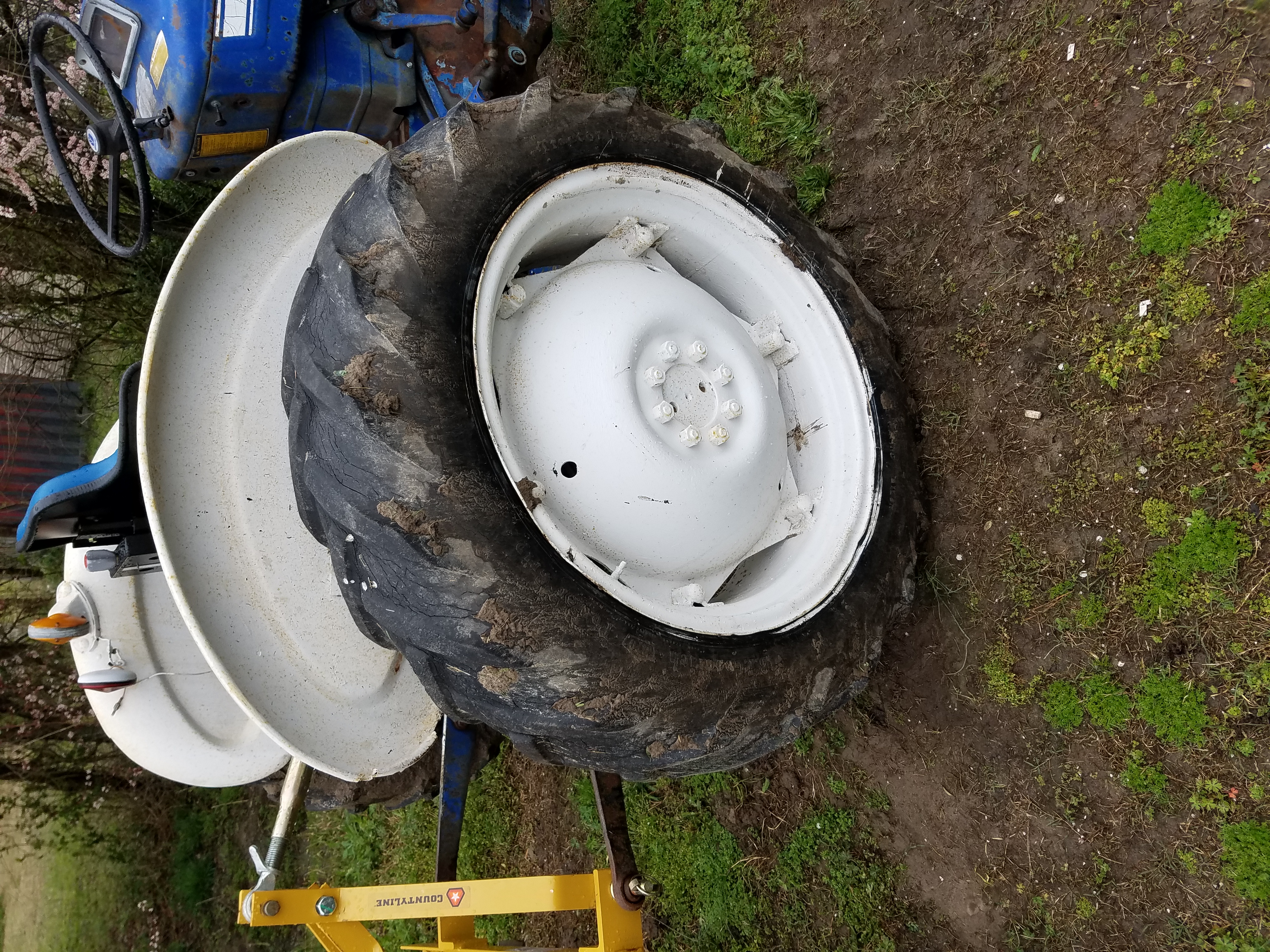

I hate to beat a dead horse, but I do believe setting that right tire in, so the loops are to the inside of the wheel dish may possibly cure this. That will set the whole tractor, and plow two or more inches towards the furrow wall, and cut the first furrow clean at the bottom.
Not cutting that first furrow off cleanly, will produce a lot of side draft, and kick the plow sideways.
I had to do that on my Ford 2000, my IH 240, and last year with my Super C with a two way single bottom. Except with the Super C, I had to set both sides in. All pull like a dream now, with that being done.

In regards to moving the tires in further, that's not much of an option for me right now as I don't have the equipment or tools to assist with doing that. Another reason is that if I move the tires in further, I will have to shorten the check chains more than they are now as to not hit the tires in the new location, and I then won't be able to lift the plows high enough to get out the furrow with the chains maxing out.
