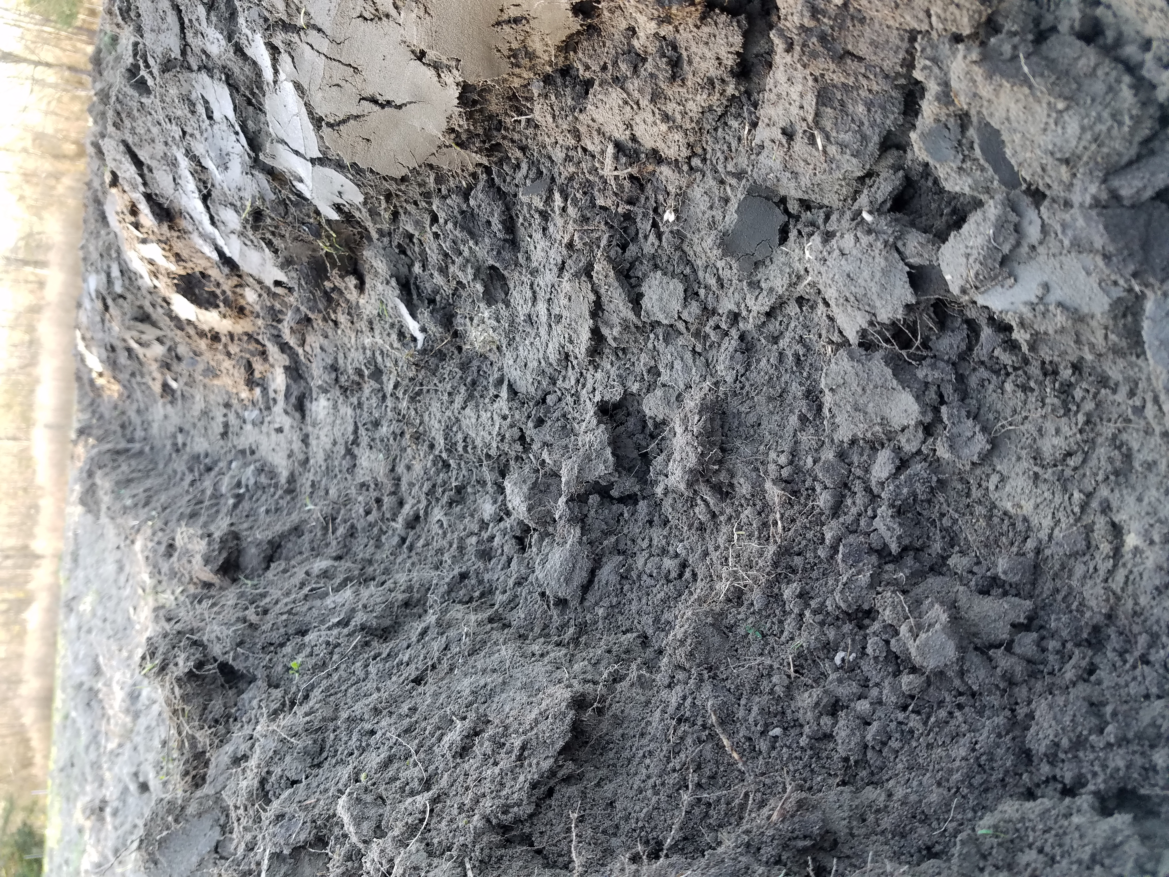

I didn't measure it at the time, but this is a picture I took the other week of how deep the rear was cutting. Id guess it was around 6 inch or so range from what I recall.

So, besides drifting left, your plow does not want to go deeper. Properly set your plow should bury itself until your 3pt has reached it's set lowered position. Since you aren't using Draft Control and you are lowering the Position Control lever to the bottom setting your plow should bury itself until your 3pt arms have reached their lowest possible setting. And when that happens your Ford will either spin out or kill the engine.

I don't be seeming to have an issue with it not wanting to go deeper. If I shorten the top link, it will go down deeper. I'd say I'm perfectly satisfied with the depth I'm getting, just not with the tracking that I'm getting that's causing me to miss some ground.

I do have the lift links attached to the furthest out hole on the lift arms, so that is limiting how far the 3 pt will drop to some point. I also may be coming close to hitting the hard clay base below the top soil preventing it from going more. I never really payed attention to see if they were bottomed out or not. Are you suggesting that there is something wrong with my shares preventing it from sucking properly? Which may be what is making it pull to the left.
