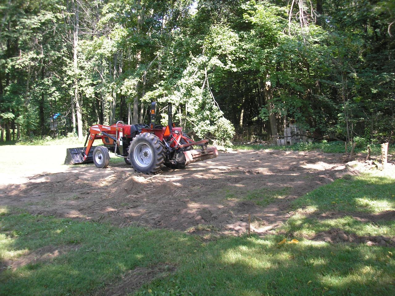

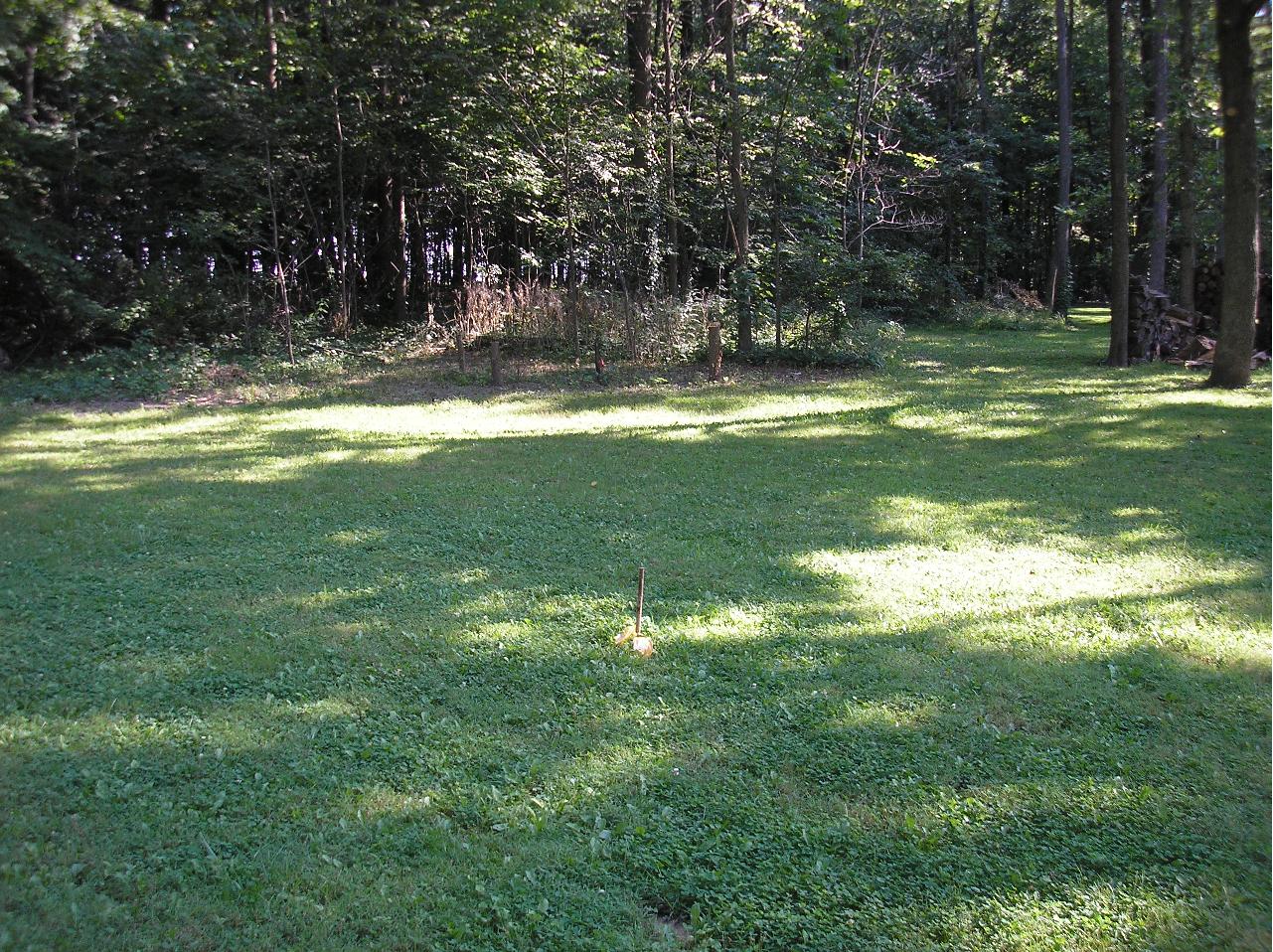

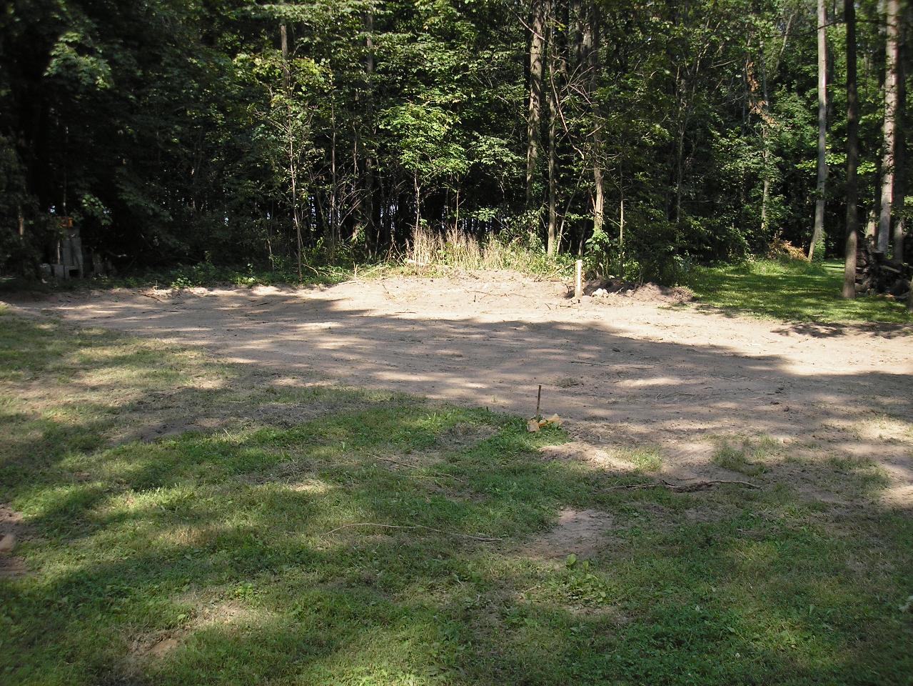

Well the progress contimues,
After getting the permit last week, yesterday i borrowed a tractor and got to work.
the sight had a slope to the rear and i had to remove a couple small tree stumps.
After a few hours of work i realized i was not that skilled at loader use, but became better as the day went on, and a boxblade might have worked better than the blade.
to see all the pics majhost.com Gallery
mark

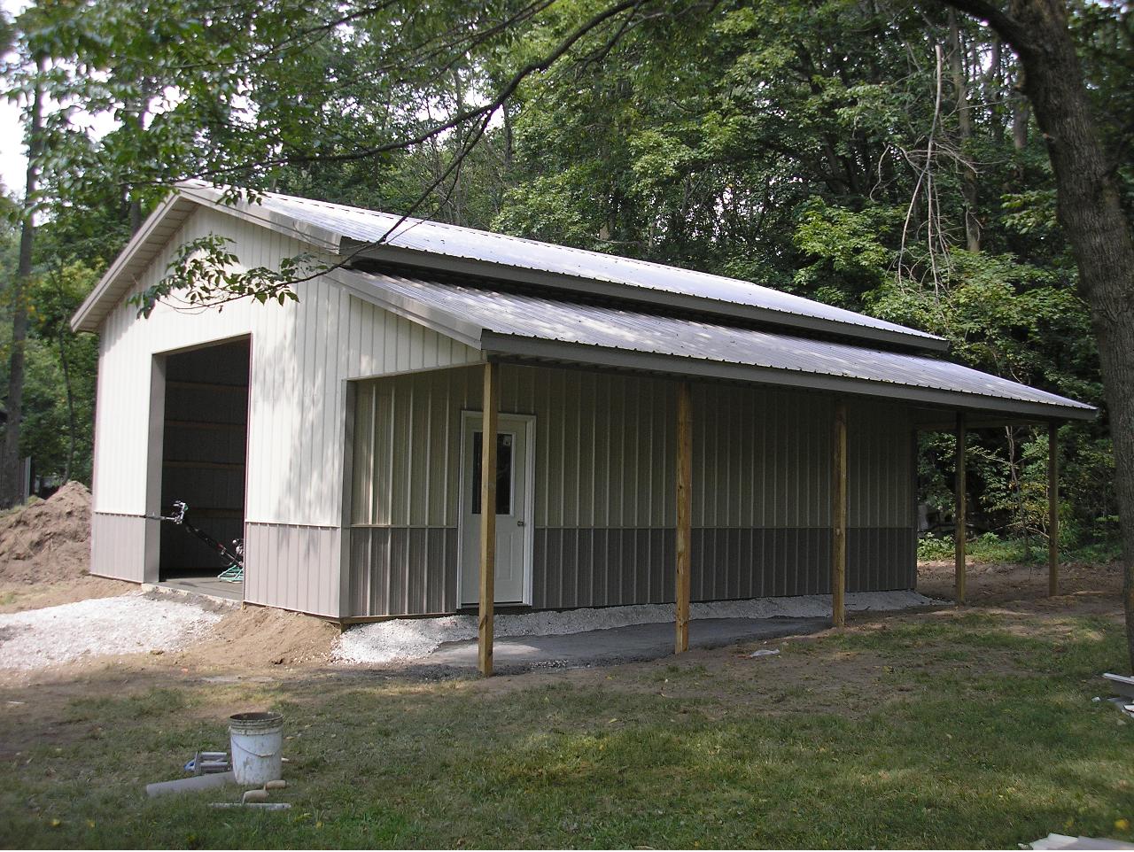

The barn is up waiting on the overhead door.
It was unbelievable how fast a good crew can put one up, if i wouldn't have had the concrete floor they could have been done in two days.
to see all the pictures majhost.com Gallery
now the projects continue,
trench and run electric and water to the barn
wire the barn
pour a concrete apron on the front
put gravel down on the floor of the lean and move all the fire wood and restack it.
regrade and reseed.
Mark
