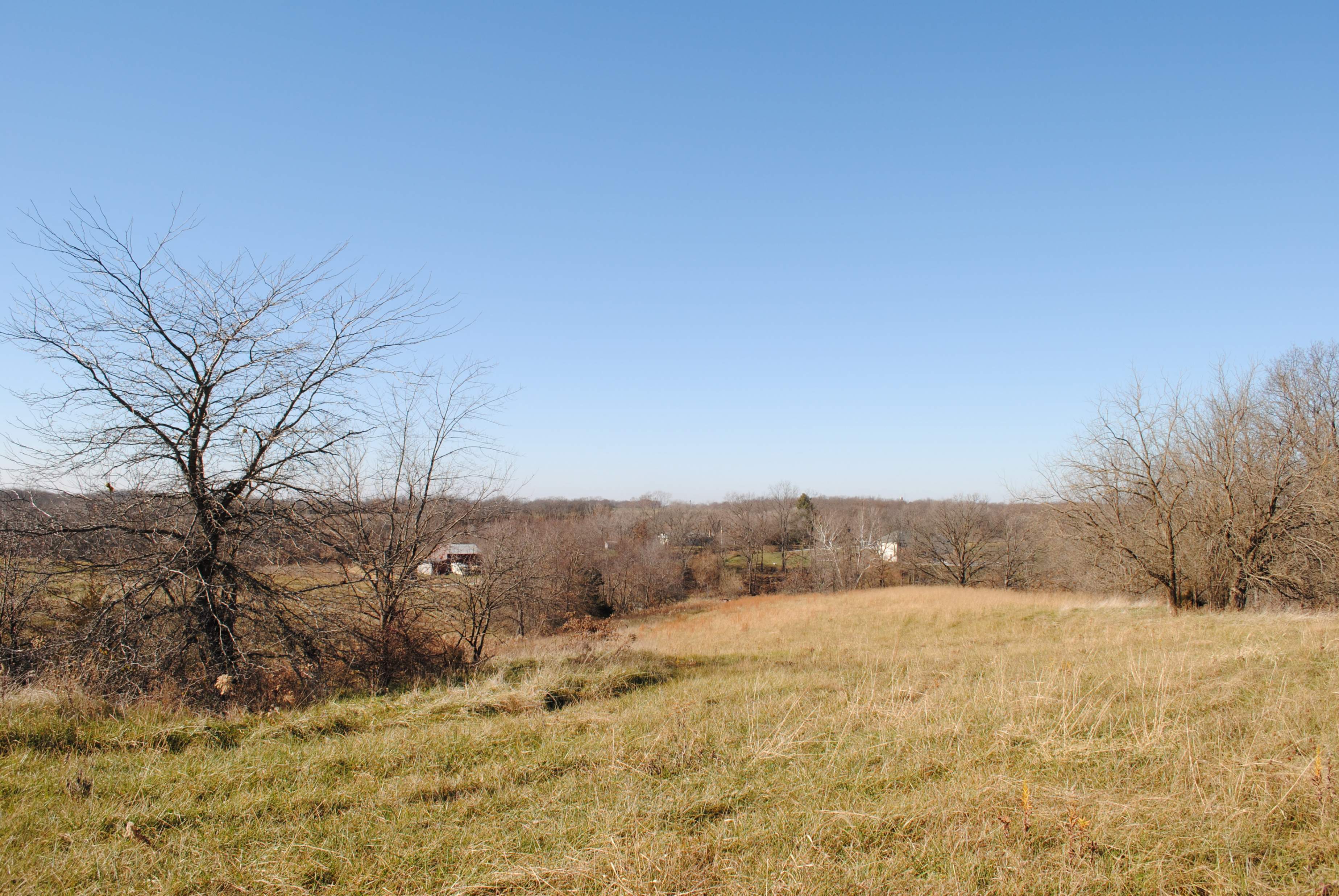

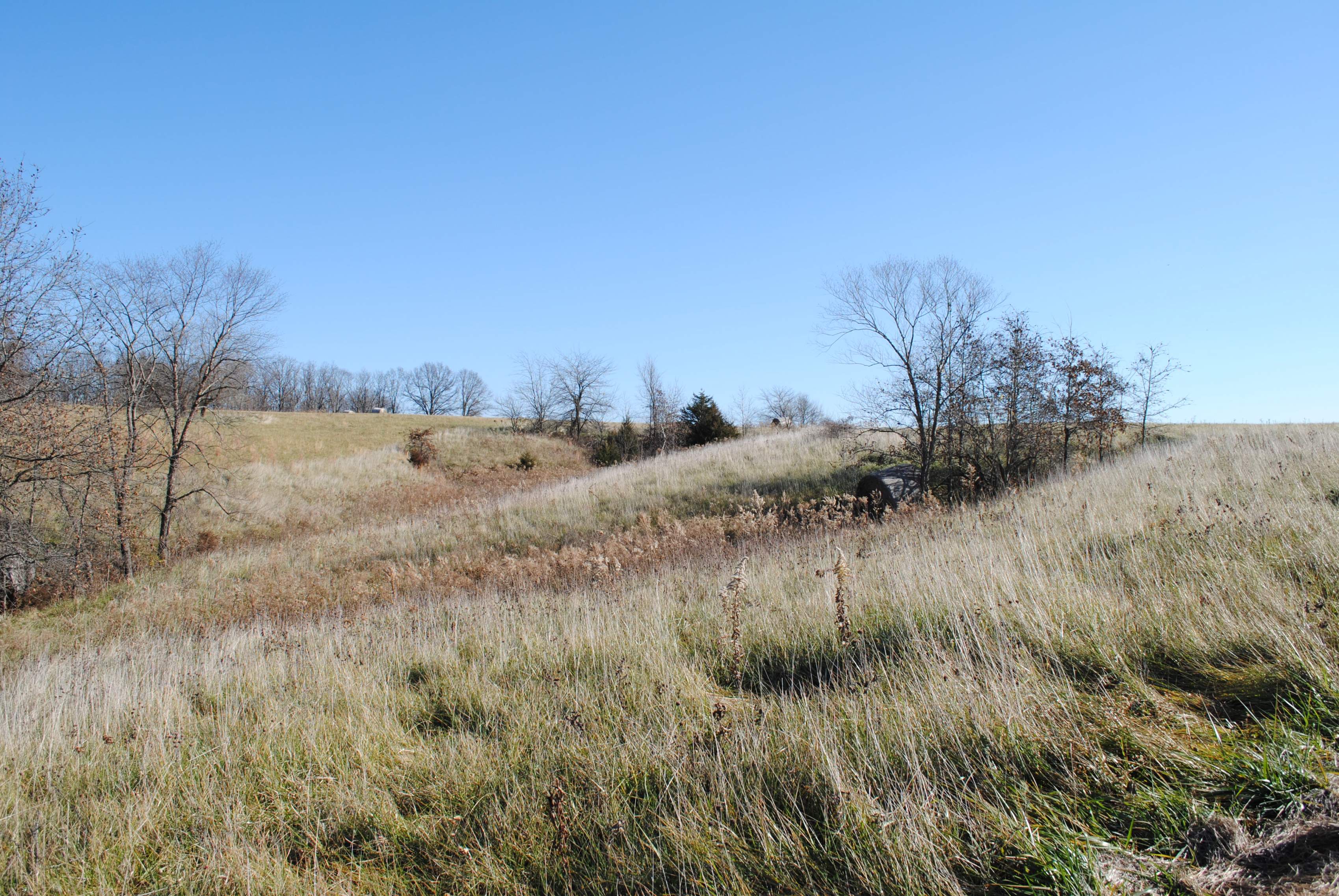

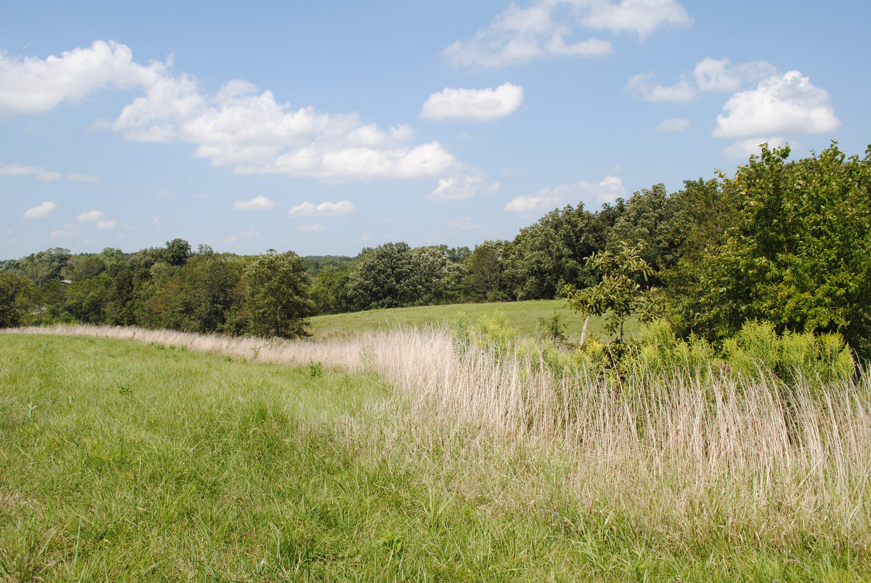

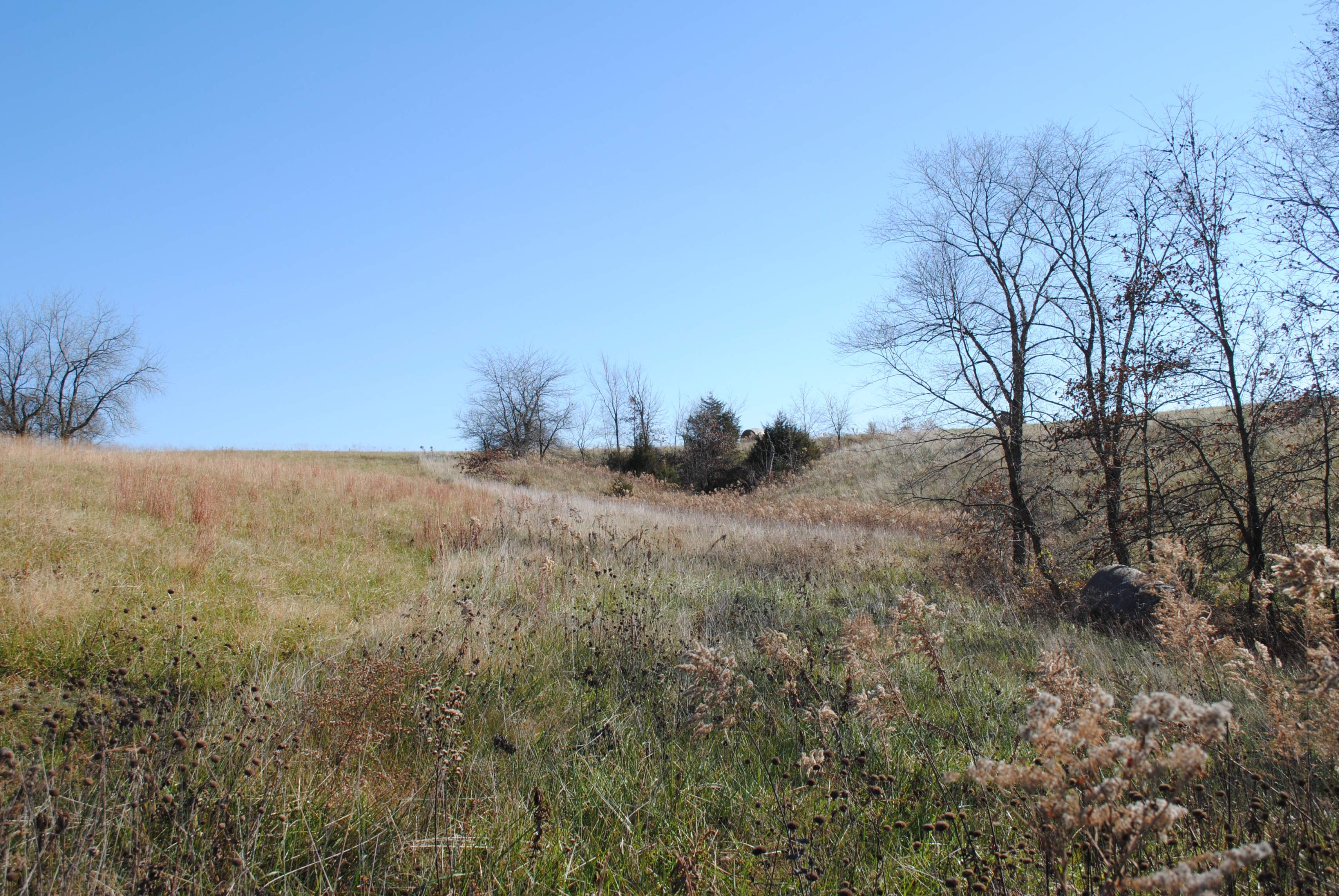

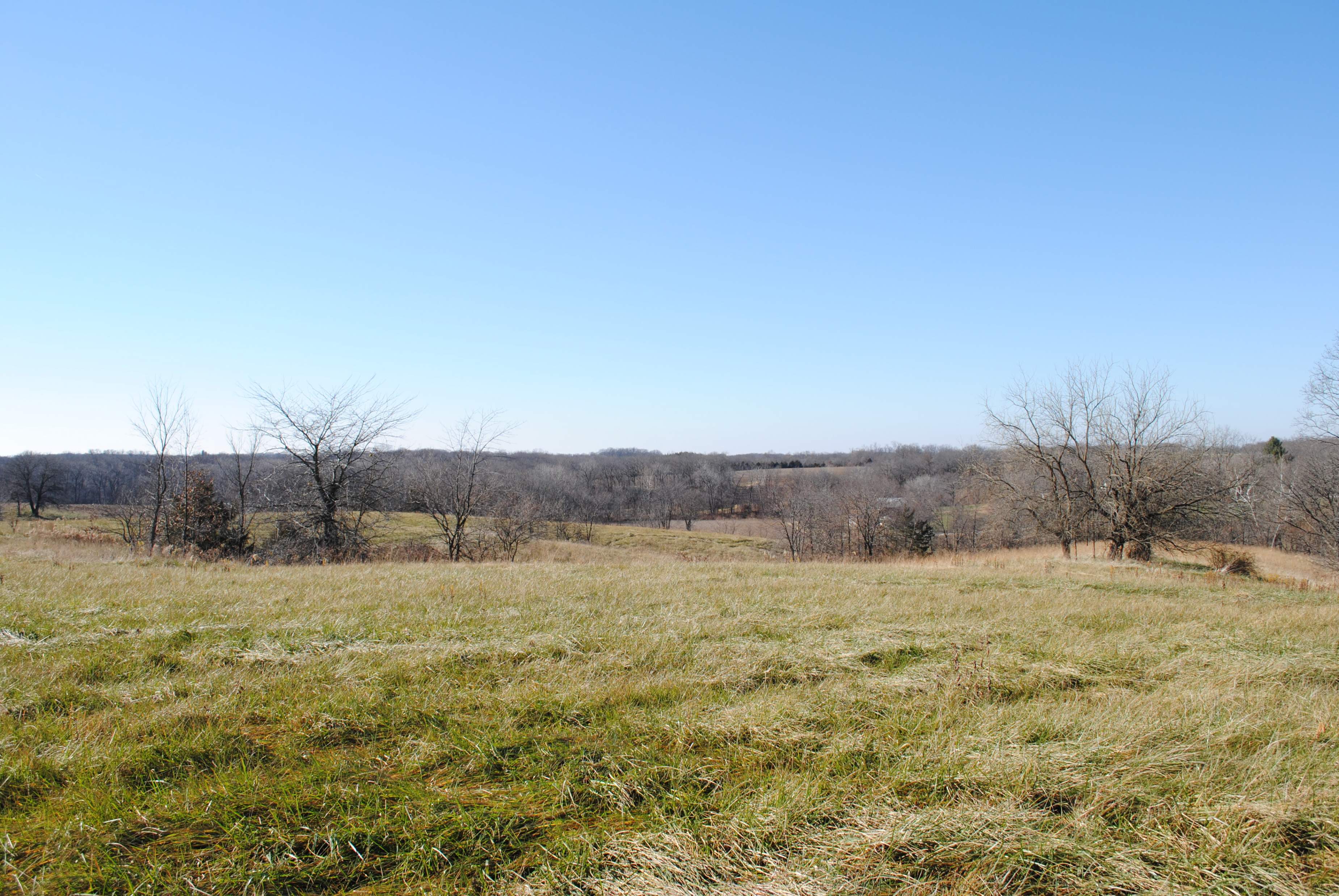

Well, a year and a half after purchasing our property, my wife and I are finally getting a pond built. After interviewing a few contractors, we hired the guy who owns the farm across the street. I have seen a couple of ponds they built and it seems like they do good work. They are planning on bringing in equipment on Tuesday or Wednesday, removing trees and topsoil on Thursday, then determine the water line on Friday using a laser. He said they would put out flags where the water's edge will be and then have me look at it to determine if any adjustments need to be made. He said it would be a few more days to build the dam.
The property is 30 acres and I'm guessing pond should be about 1 acre. Attached are some photos and aerial views. The property line is blue, the proposed dam location is red, and the white numbers are where the photos were taken from. The number corresponds with the order the pics are posted and the white line extending from the number is the direction that the camera is looking. I included an aerial view with 10ft topographical lines also. Hope this makes sense. I'm not very good at explaining things.
I'm open to any suggestions. Maybe something you would have done different, or some things to look out for during the build. I'm thinking about having them put in a small sand beach, but I'm not sure. Does anyone have a beach and if so, how do you like it?

Congratulations on the pond project. You have a great looking property. I like the rolling terrain and mixture of cleared and non cleared with scattered trees. Have you decided on a depth? We hope everything goes well. Look forward to seeing lots of pictures. Good luck!

Not sure of the depth yet, but I am guessing 15-20 feet. I would really like to make it bigger, but I have to be realistic about my budget and if we go bigger the north side would have to be built up some and cost would rise exponentially. That being said, if they get the water line laid out and it seems too small, I'll probably have them make it bigger. I have a friend with a 3/4 acre pond and it seems like a good size, so I figured an acre would be ok.
   / Another pond project #5
Have you located your home build site or any out buildings planned? I like the view from the lower right of position 3. Screens out the view to the neighbors and would have a nice view of the pond. Not sure of the North orientation. Beautiful property. My BIL has redug his pond 3 times getting it to hold level, even with it setting on Missouri clay. Just plan on more building sites as you expand for equipment & workshops & barns for all the extra equipment all TBN's seem to aquire.

That sucks about your BIL's pond. I sure hope we don't have any problems like that. Your right, position 3 is our top choice for a home site, but that may change. Who knows, we are still a long way from building. That photo faces almost directly west. We were initially planning on putting the pond on the south side of the property, which would allow south facing windows overlooking the pond, but after talking to contractors we decided that this would make a much nicer pond and it would be more centrally located on the property. Windows facing west over the pond will probably be good too.

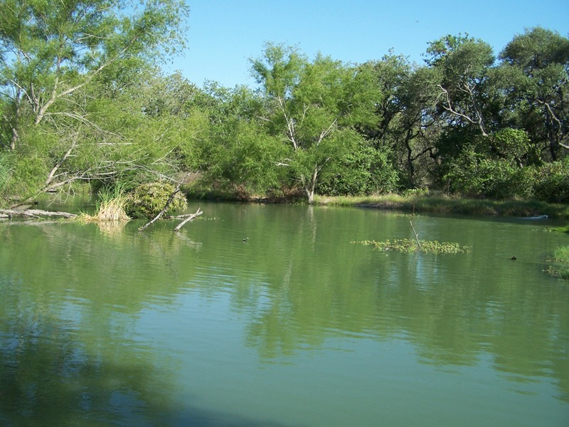

FF117,the first pond I built was right off my front porch about 60 feet away.We always wanted a pond "right in our front yard" so i dug it and it was only about 1/3 of an acre.All we have here is sand but we wanted a beach area with no vegetation where we could pull up and park the paddle boats,put up a gazeebo and bbq area.I built up this area about 70 ft by 30 ft and it was nice.We had shot the grades so I knew the maximum water level but I never thought about waves and how high they can become even in a small 1/3 acre pond.Most of this pond is surrounded by trees but a large field to the south was my undoing as we have a strong prevailing wind from the south.You would not believe how fast that beach washed away in one afternoon in fact:mad: When I saw your photos of where your pond will be I saw a lot of open area around your pond site and my first reaction was...boy you are going to get a lot of wind on that water. I think though, if you put some small rip rap or railroad ties and built that area up a little bit it will be fine. A lot of guys down here like to build a beach sandy area that slopes gradually right down to the water and without vegetation...unless the cat tails take over which you don't want...usually all that sand just silts your pond. I thought of this because I don't know if you have sand on your property or whether you were paying to have it hauled in. That could get expensive if it washed away. This is the only reason I mentioned it...because of my experience. What kind of soil do you have there? I do not know although I was born probably pretty close to where you are at, at Chanute AFB, Rantoul. In the end, it always works out for the best...just thought I might save you a headache. P.S. It's always worth it though, I think, because this is the view off our front porch. The 1/3 acre pond has been expanded now to 2.5 acres and it runs back into a heavily wooded area and I am ready for the next phase :)

Thats a nice view from your porch.....2.5 acres, wow. We live in Quincy, about 3 hours west of Rantoul. Thanks for pointing out about the wind, I hadn't even thought of it. It's crazy that your beach washed away in a day, bummer. Maybe the south side is best for our pond because we usually get north winds in the winter when the pond will be frozen, plus there are trees to the north that may deflect some of the wind. I don't know, maybe we don't need a beach, just thought it would be nice. Guess I can always put that money toward a bigger pond.

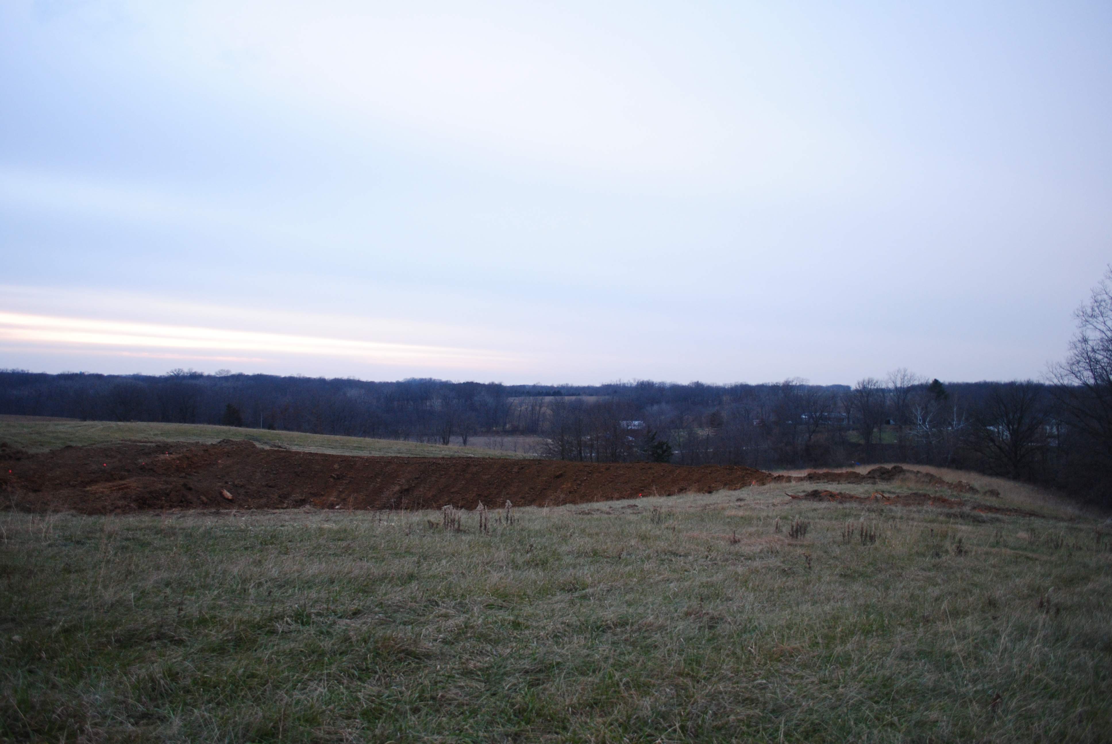

Well, things have been moving fast. They got the equipment moved yesterday and got a lot of work done. The dirt has been working good and things have been going smoothly. Unfortunately though, my estimation of a one acre pond was optimistic. Based on the grade it only made sense to put the levee in one place. We tried to maximize the water surface area while still allowing the back side of the levee to be mowed easily. All I have now are cell phone pics, but I'm going back out tomorrow and will take some with the real camera. Good news is, it looks like it will be under budget so I can have the beach built and maybe get some other work done. They might be done by the weekend, which is good because we may get some precipitation on Saturday.
The equipment they are using looks pretty nice. They have a Komatsu D65px and a Komatsu PC300LC excavator.

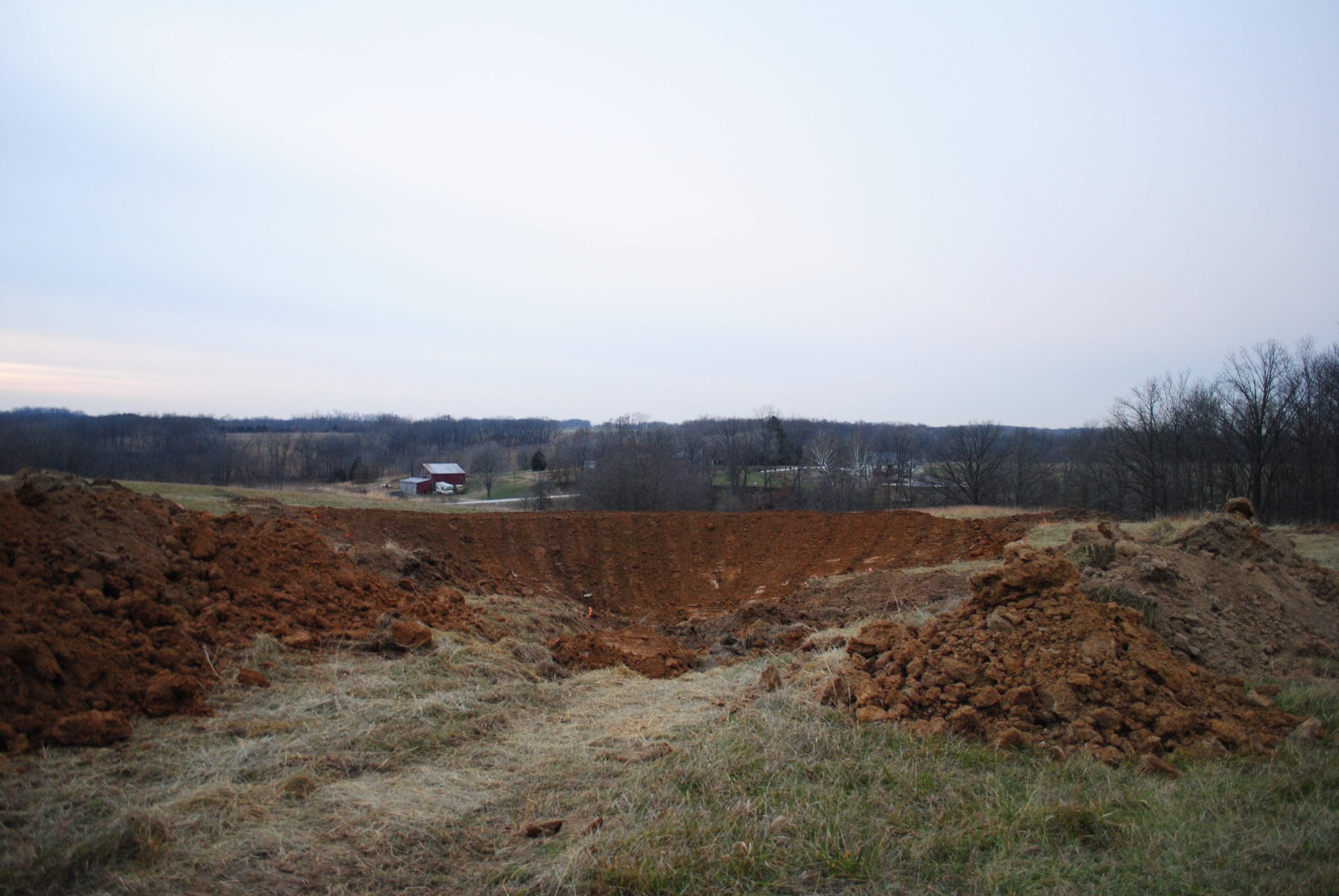

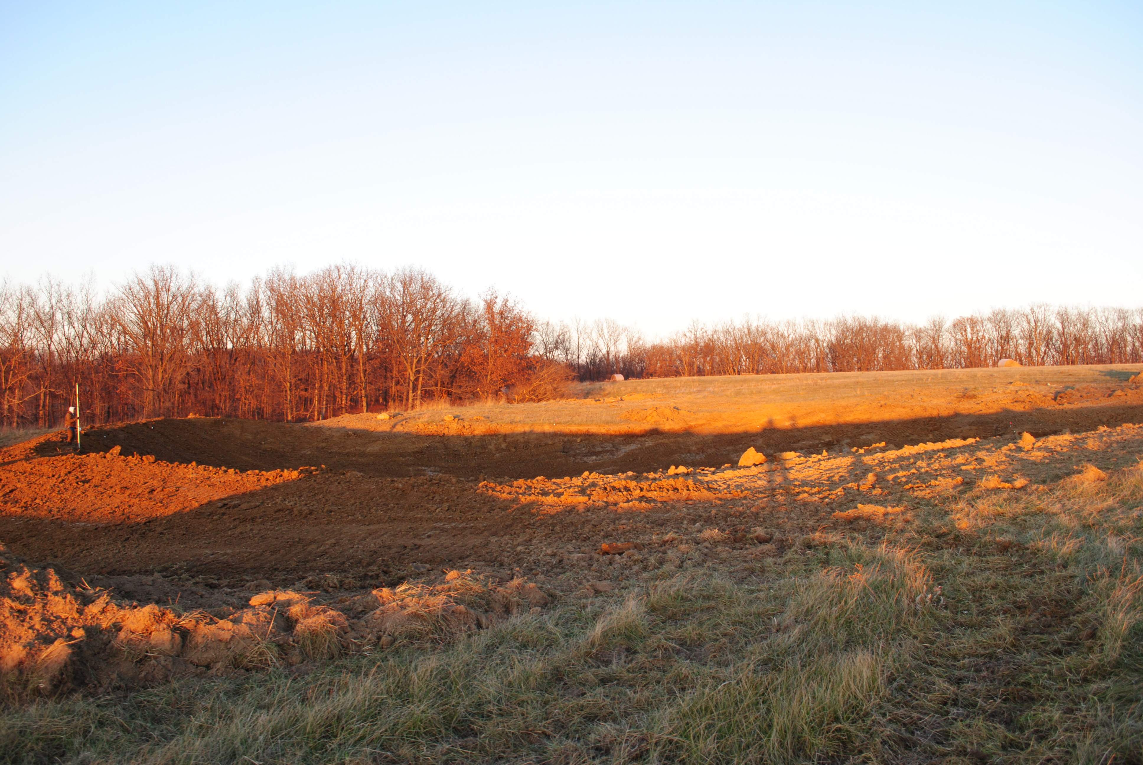

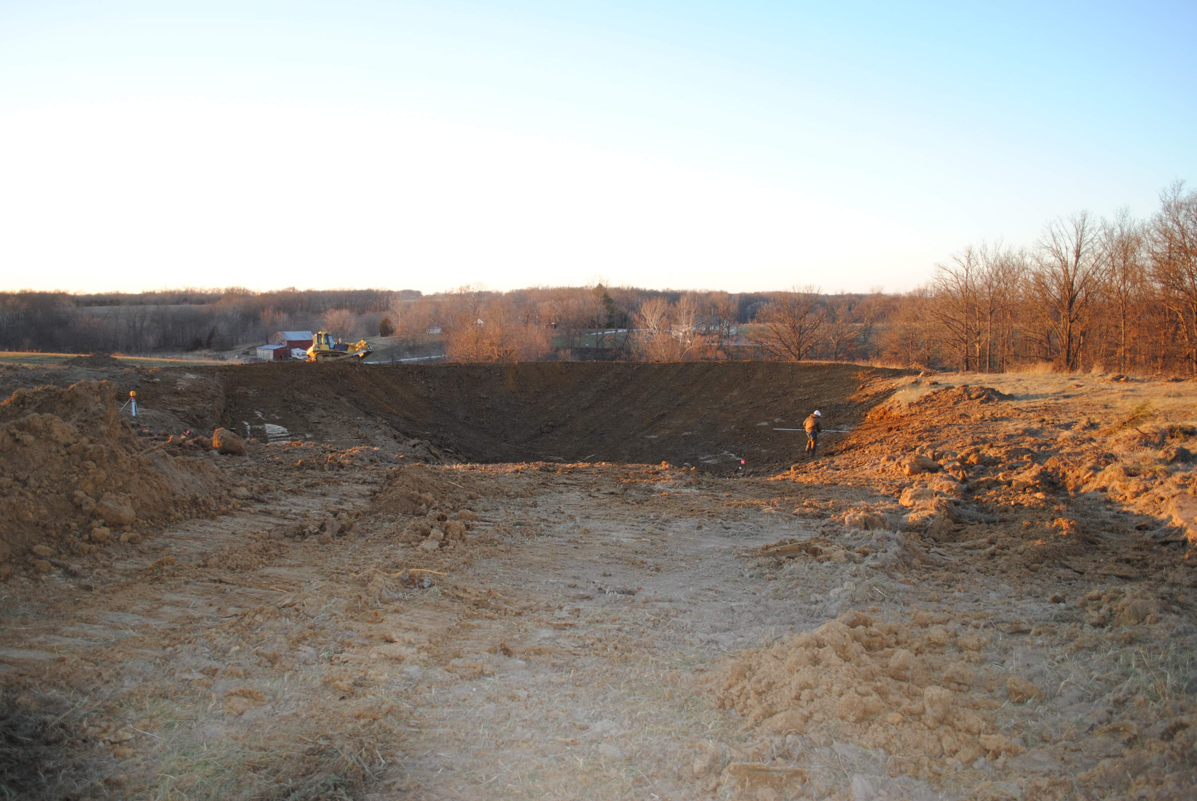

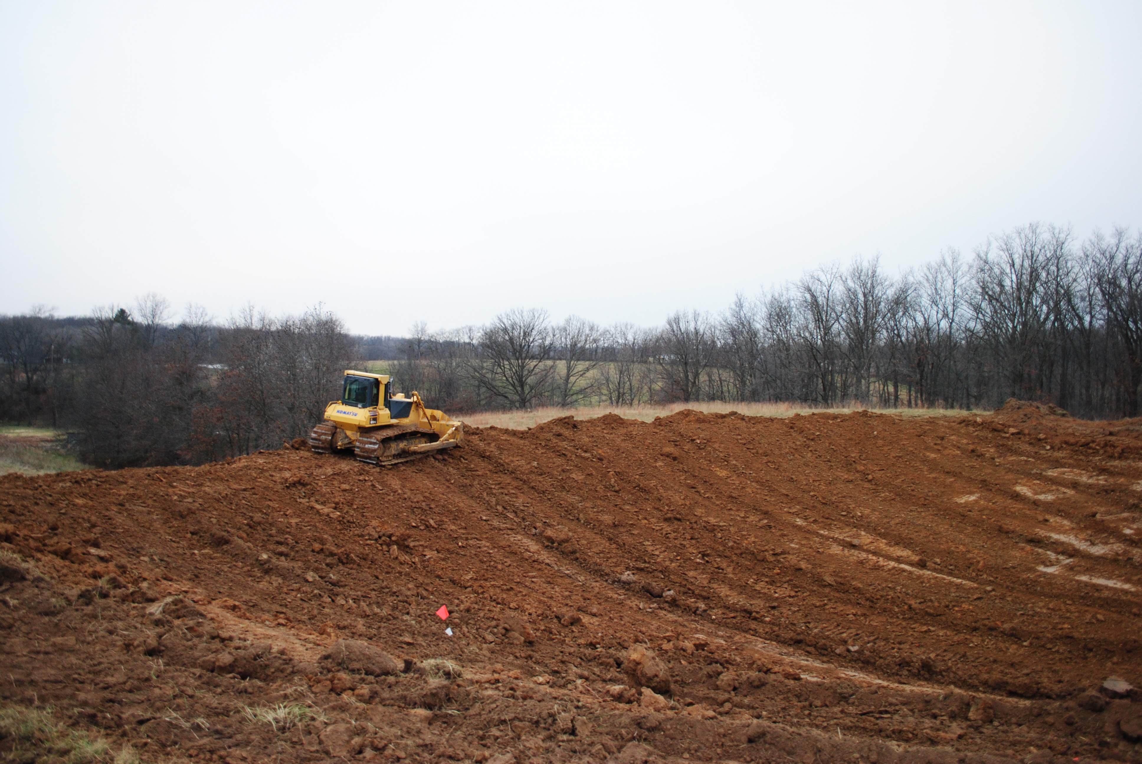

Went out to inspect the work today. The levee is almost done, but there is still a lot of finish work to do around the edges and the back side of the levee. The original plan was to install a pipe for overflow, but with the limited amount of drainage to the site we decided to just put in an overflow spillway on the north side. It will be wide and is in a place thats already covered with vegetation. Not installing the pipe was at the suggestion of the contractor. This caught me by surprise because he would be making more money by installing the pipe. The edges of the pond will have a steep initial drop (to keep out the cattails) and a ledge around the outside. The edges still need to be worked so that I can mow up to the water. It's still a little hard for me to visualize.
Total depth will be about 15-16 feet. This is deeper than I wanted, but the topography dictated the depth. Beach will be on the south with the bottom contoured to hold the sand in place.

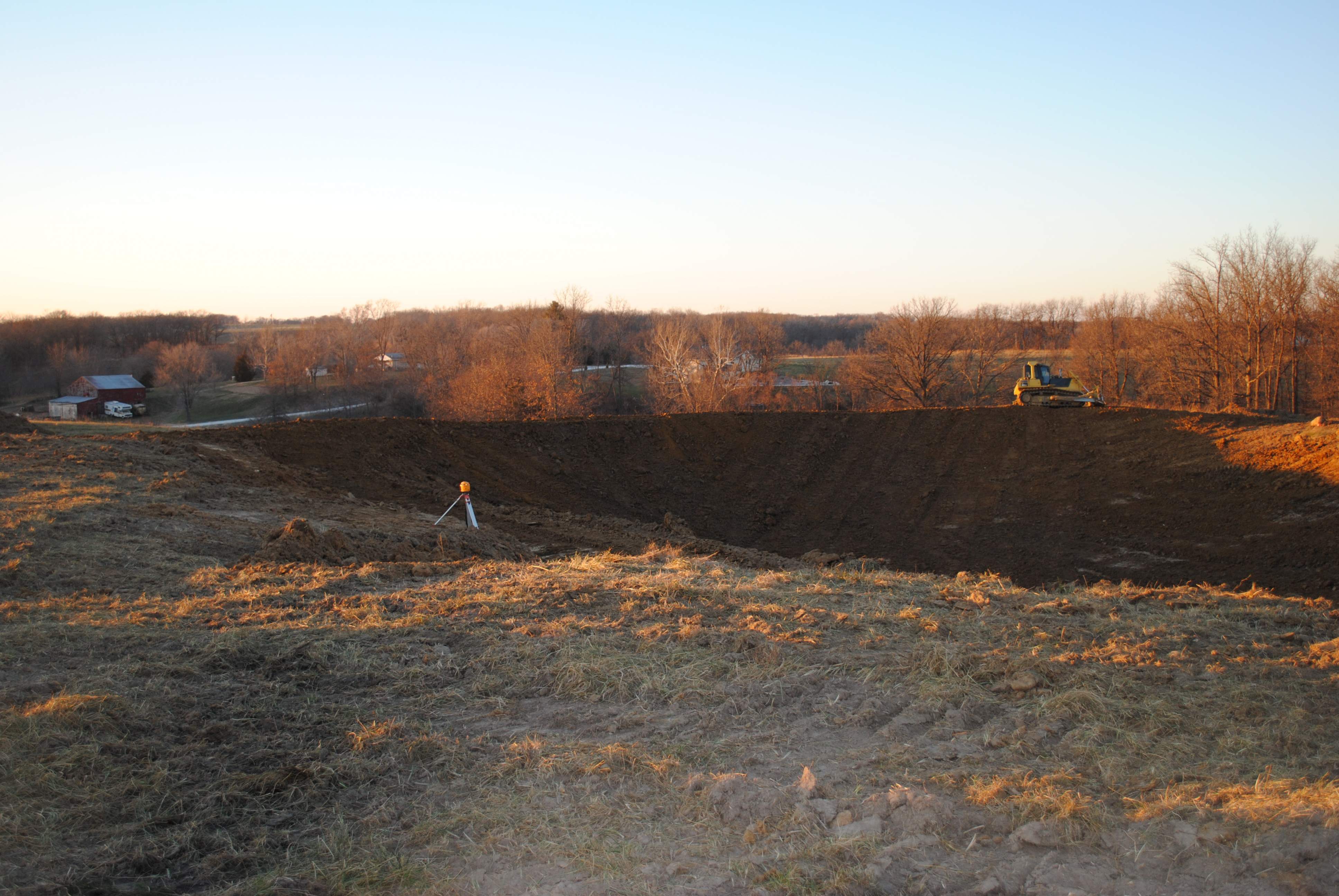

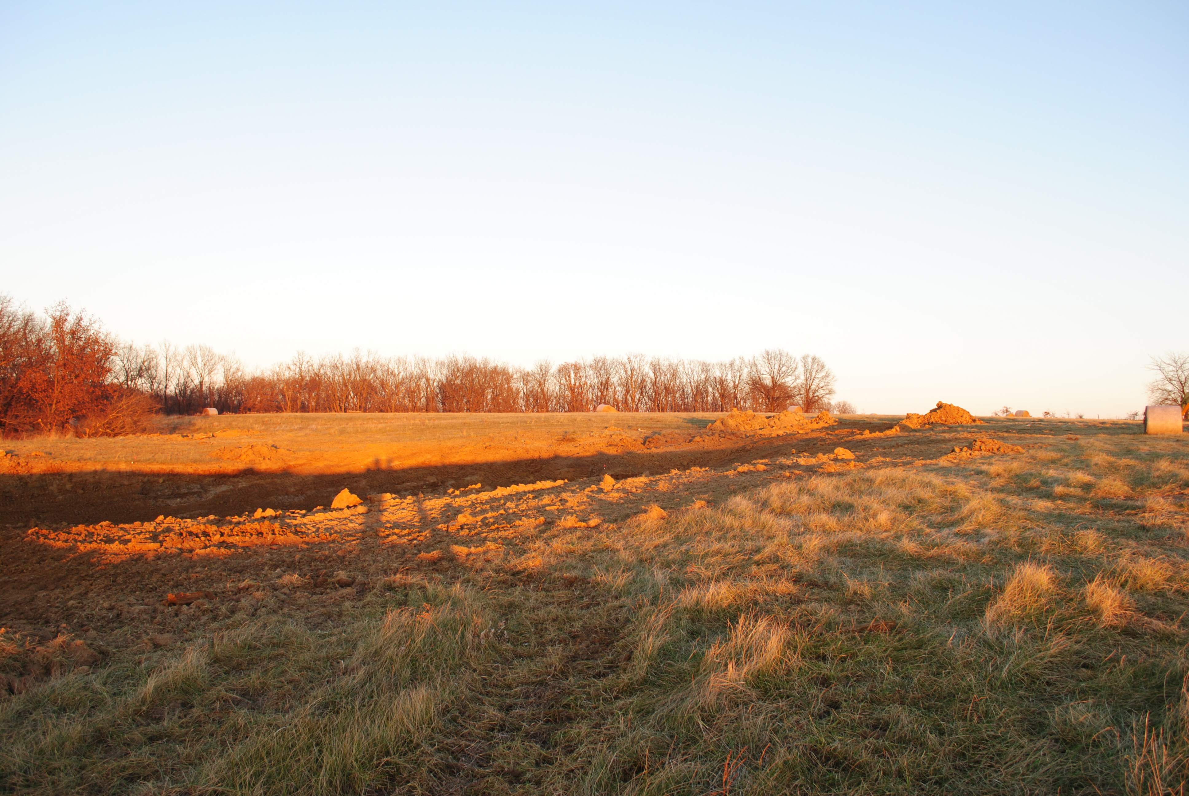

Good news: The dam is complete and they spread top soil on the back side tonight. They made a nice shelf as wide as the dozer all the way down the south side. This will serve partially as the beach and the rest will be fish habitat.
Bad news: They hit sand yesterday...a lot of sand. They spent a lot of time digging it out and backfilling with clay. He said that they dug out enough sand that they could have put the dozer inside the hole. Needless to say, I don't think we're still under budget, even without the overflow pipe. Also, the back side of the dam ended up steeper than we wanted. I'll probably have to mow up and down instead of side to side. Although if I had a small lawnmower it would probably be OK. He apologized repeatedly for this, but explained that it would take a few more days to push enough dirt to make a noticeable difference in the grade. It's not a perfect world.
The dam has gotten pretty large and the pond pretty deep. I'm guessing close to 20 feet. This is good and bad. Bad because it makes a lot of useless water and will take a long time to fill. Good because if we have a drought there will be plenty of water and we can put geothermal lines from our future house on the bottom. There's still some grade work to do around the edges and they have to finish up on an old pond site that I'm having them clear. Assuming no problems, should be done tomorrow. That's good because it is getting dang cold and the ground will be frozen soon. Sorry for the long post.
