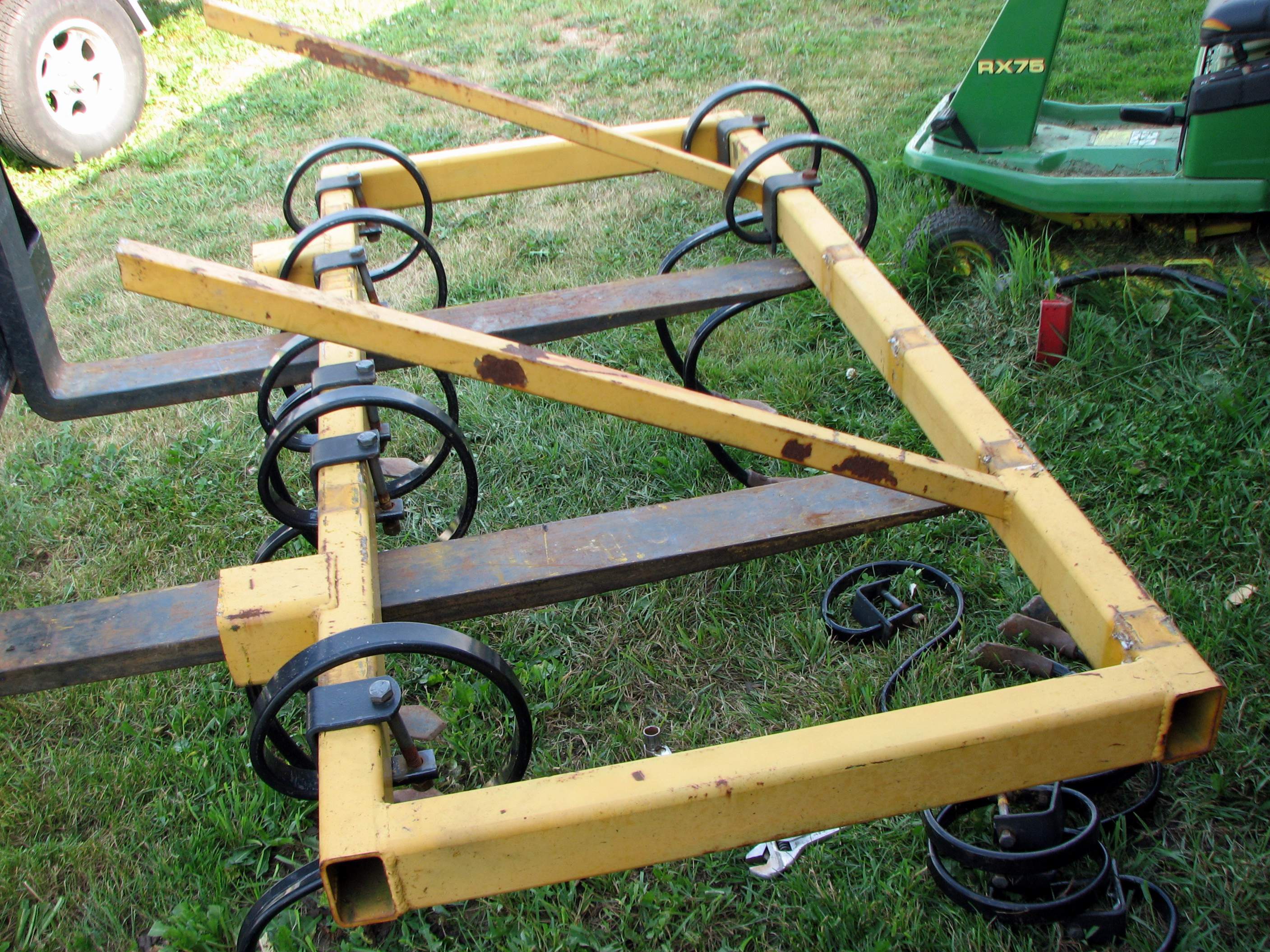

I bought this plow early this year:
http://www.tractorbynet.com/forums/snow-removal/234268-new-plow.html?highlight=

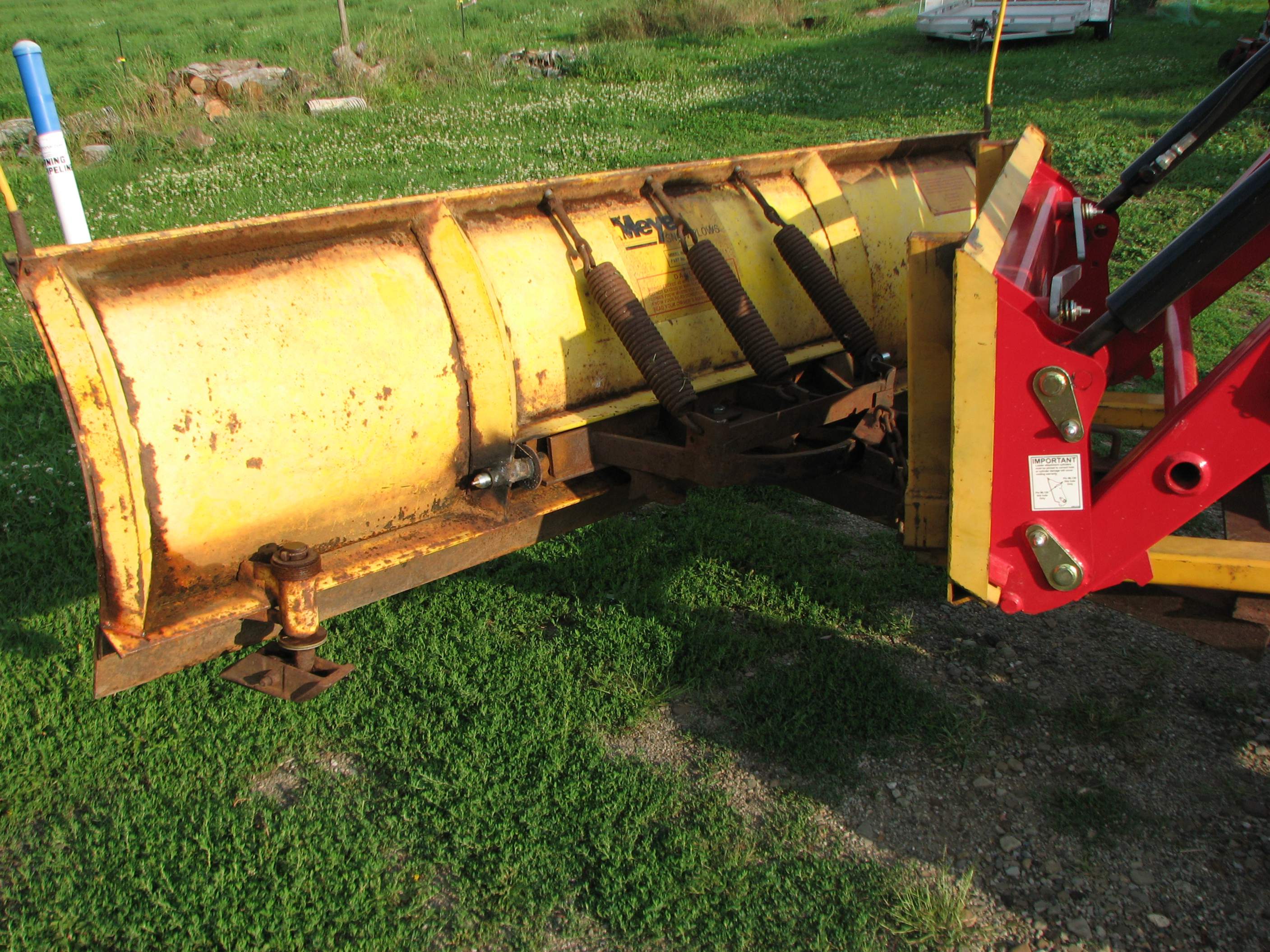

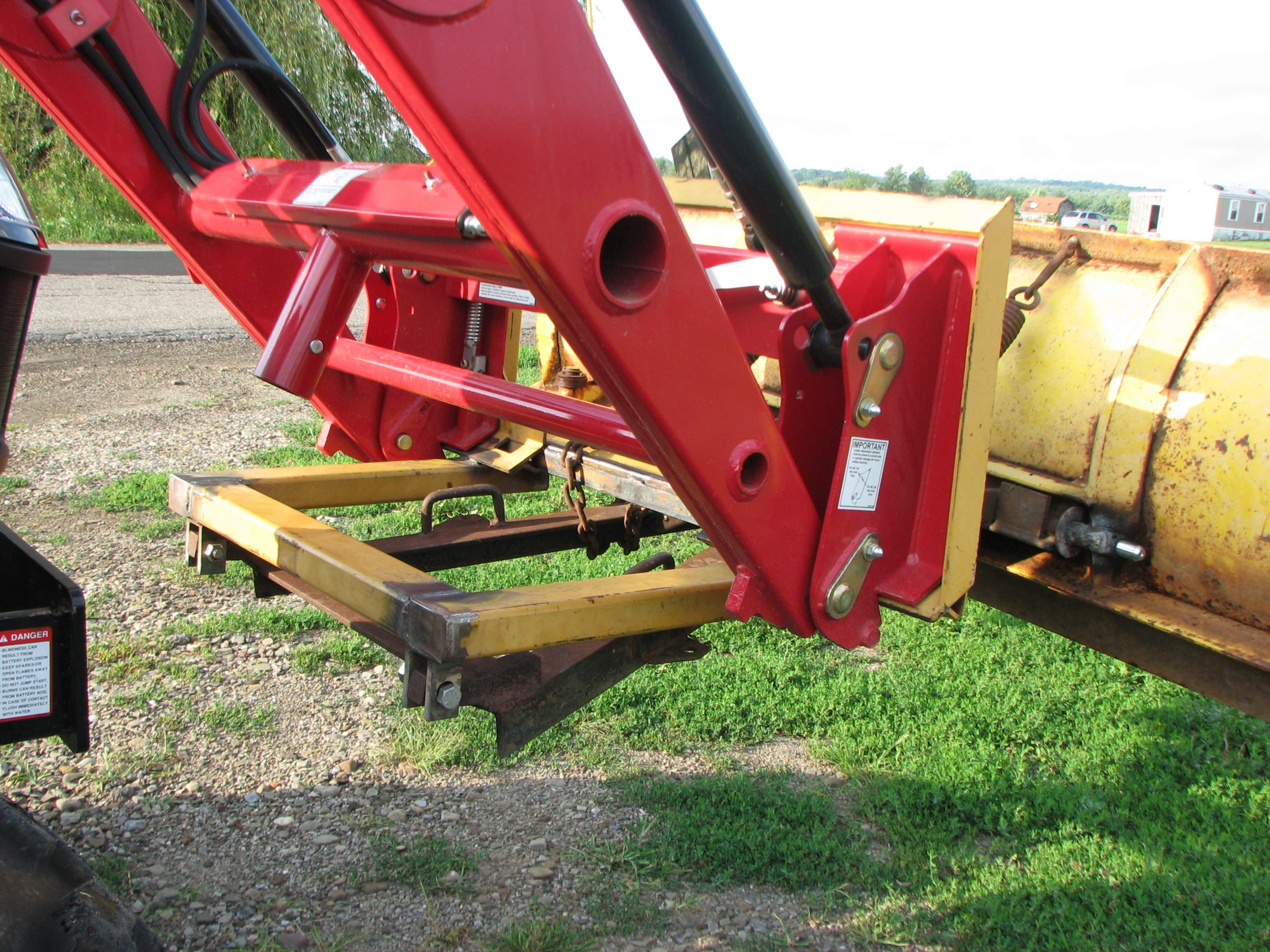

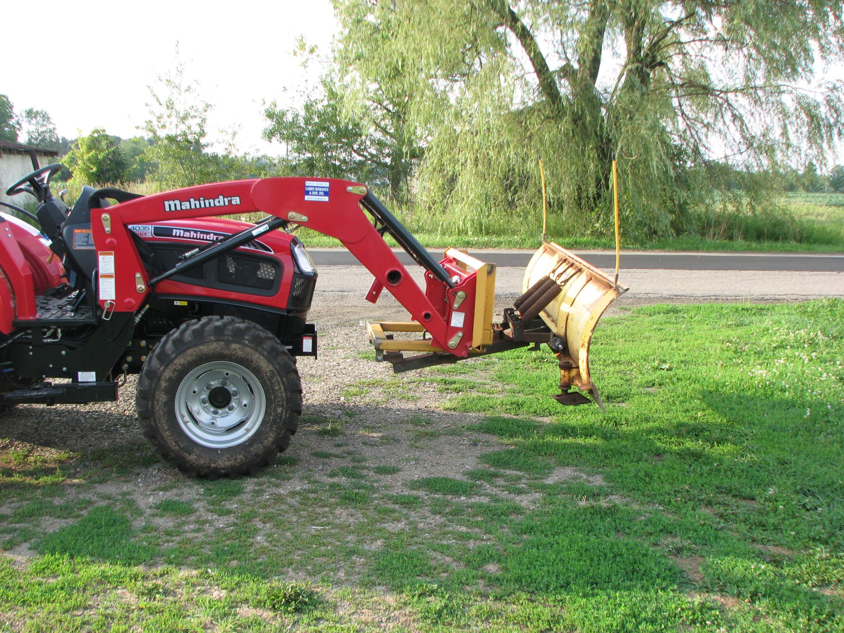

I'm finally ready to start working on the build, and I need some advice. I picked up a new old stock skid steer cultivator attachment for $20, I've cut off the QA plate and cut up the tubing for use with hooking up the plow. Here's where I am right now: I want the plow to be connected to the rear of the QA plate as far as possible, in order to bring the blade up as close as possible. (I've looked over the threads regarding this design already). I'm going to be utilizing the plow's chain float, so the connection will be a pivot. But on our Mahindra 4035, the first stabilizer bar only allows 10" max sticking out the back. This means that my brackets going out the back can't go back farther than 10" or it will hit the bar during curling. This doesn't bring the plow back far enough for my liking. So I'm trying to decide what my best option is here. I can think of three possible methods:
1. Be satisfied with 10" set back.
2. Set it back as far as possible and just don't use the curl
3. Cut a section out of the plow's A-frame to shorten it.

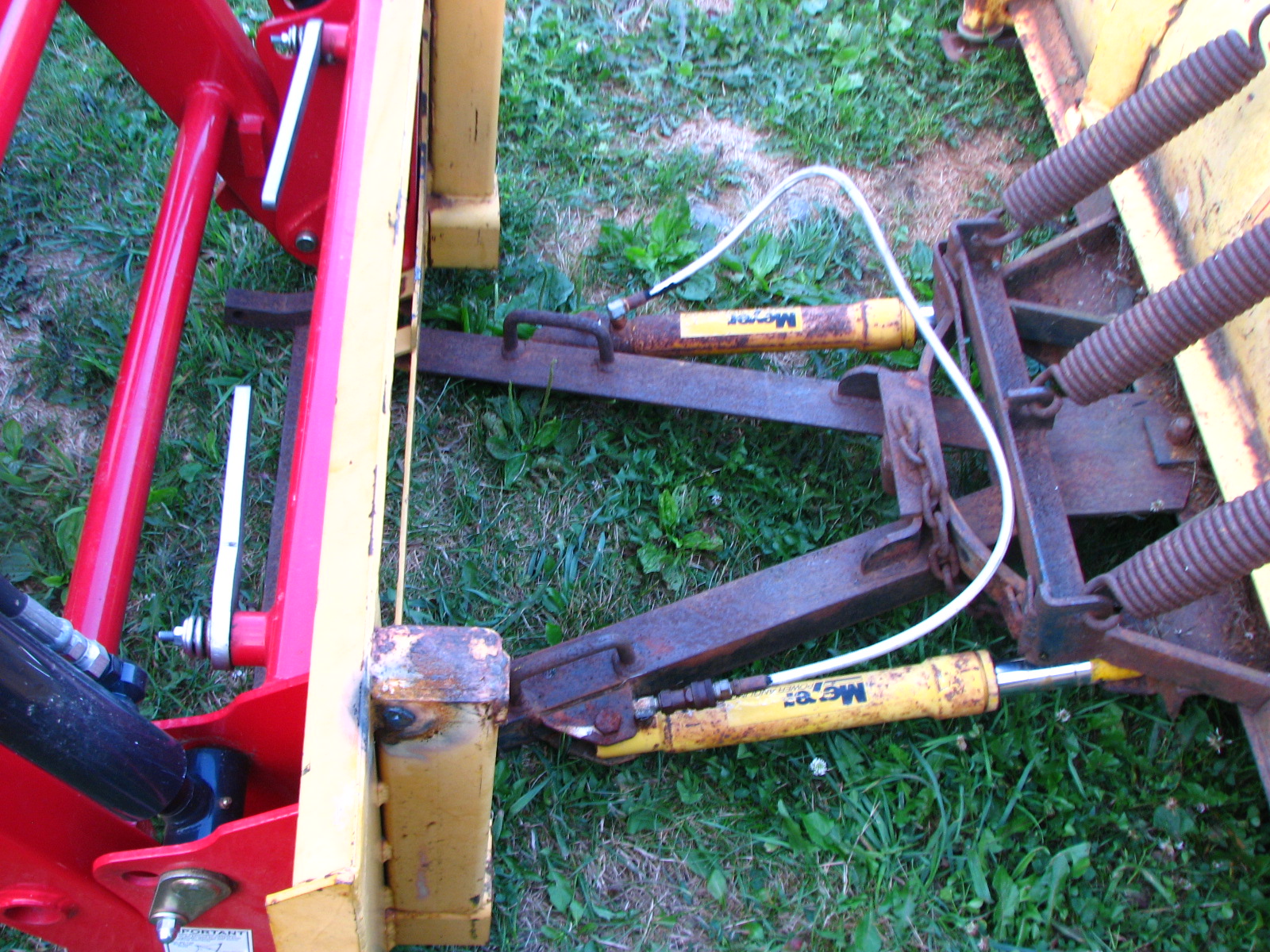

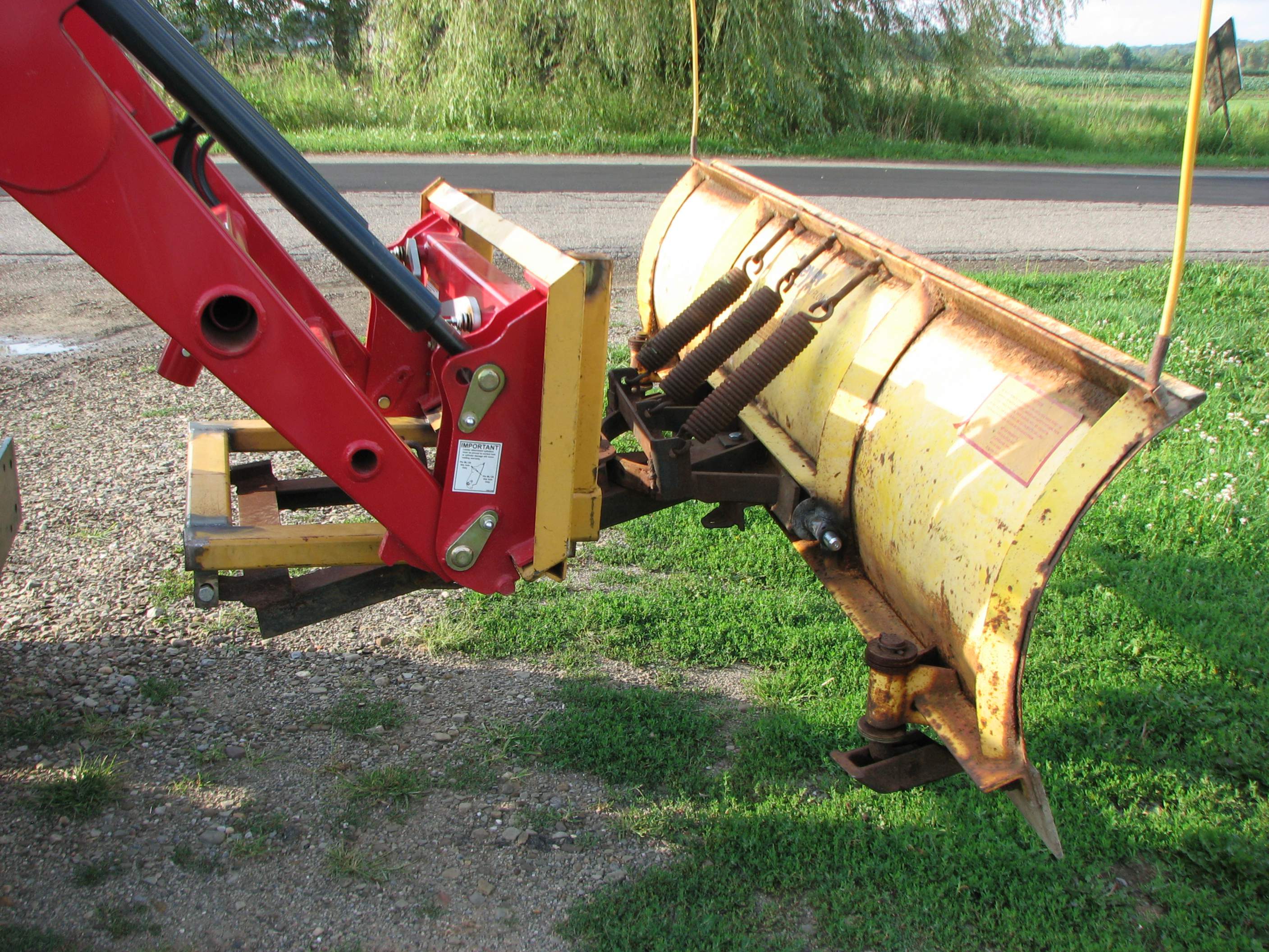

What do you all think? How important is it to have curl, keeping in mind it will be a chain float? I'm posting some pictures here as well. First pic is the cultivator after I cut the QA plate of but before I cut the frame up. 2nd pic shows the stabilizer bar in question. Last pic shows the QA plate in the approximate position. The plow connection in the picture is 8" out the back. (max 10"). My goal was to get the QA plate to within 2 inches of where the chain attaches.

I would move the QA plate farther forward.
There is really no need to curl a snow blade down far enough that it will hit the loader crossbar. You can always cut a little off the back of the plow A frame late if needed.

Looking at your 2nd pic gave me a thought that has crossed my mind when plowing with a blade stuck way out off of the loader and trying to turn with a heavy snow load on the blade (not so well) . I'm guessing this is why you want to keep everything as "tight" to the tractor as possible right? Here's maybe a different approach that might work out nice especially if you do not have front remotes for angling the blade. Just leave the blade alone, make a drop mount off that flat plate on the front of your machine and put some quick disconnect(s) on your bucket cylinders and use that for angling the blade. Drop a chain down off your loader somewhere and use that to lift the blade up and down. I suppose that if you wanted to you could use a solid connection between the loader arms and the blade and end up with down pressure on the blade if needed, otherwise use the float position for normal function. Overall this frame mounting is much better than sending the shock of the plow through the loader. You will not have the wonderful stacking ability of a loader mounted plow with this frame set up.

Thanks for the suggestions so far. I'm leaning toward not worrying about the limited curl when mounting it closer to the QA plate. I can try it for this season and if it makes trouble, change it next season. I really need stacking capability, that's why a frame mount is out for now.

Does your FEL have a float mode? If so, why not use that instead of the chain? It gives you more flexibility because if you want to apply down pressure (not float it) you can. Like for scraping ice.
I shortened the back of the A-frame on mine by about 9" or so. Not hard to do. You need to get rid of those thick mounting tabs in the back anyways as they will get in the way and catch things, IMO. Easier just to whack off a chunk and weld on a new cross member.
You will probably want to get rid of the cylinder hose guards too (the "handles") as they will probably get in the way of the SSQA on the FEL, especially if you move it back closer in. Not needed as the SSQA plate should protect them.
/ Another QA plow build thread. (Need help)
Yes the FEL has a float mode, but keeping the chain float allows the weight of the loader arms to stay over the front axle for better traction. Also chain float reacts quicker to terrain changes than hydraulic float. I think both methods work, but from what I've read on here and other forums, chain float works a little better. If it works out like I plan, I will be able to apply down pressure as well.

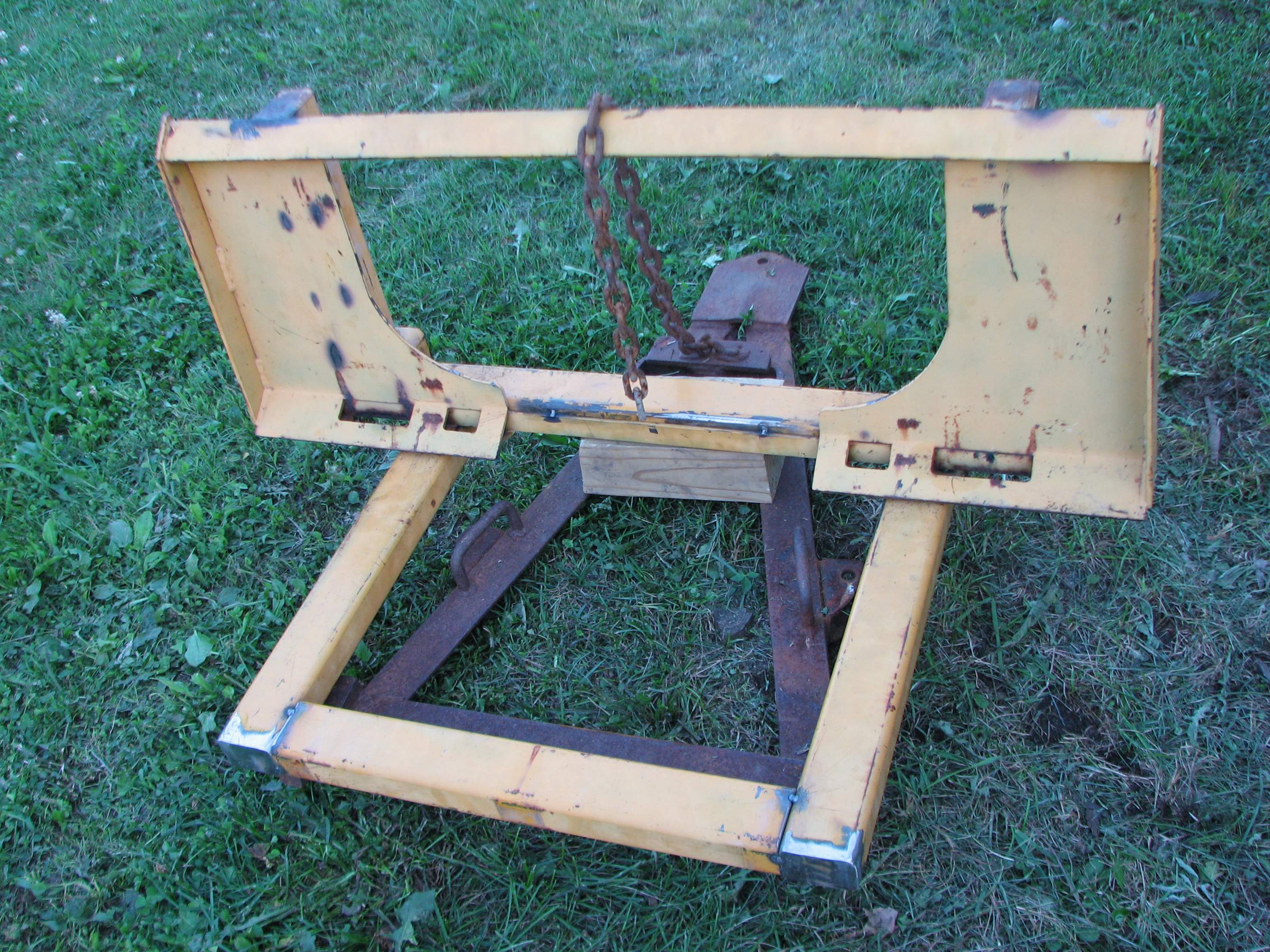

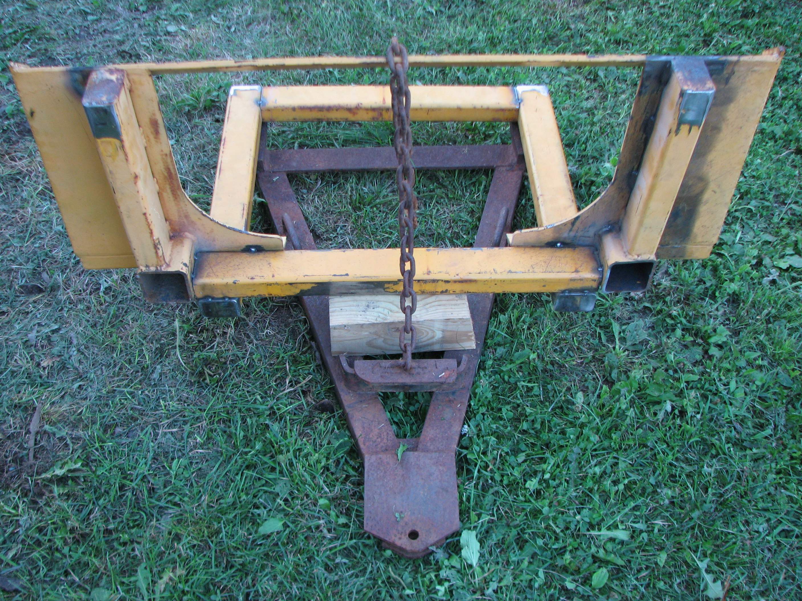

I had a few hours to work today, and got the mount frame tacked together and on the QA plate, and mounted it on the tractor to verify that everything works. I'll be adding several brackets and reinforcements, tabs underneath for actually mounting the plow frame, and I need to figure out a way to attach the chain to the QA plate, then it should be ready for painting.
/ Another QA plow build thread. (Need help) #15
you can weld a piece of steel with a groove cut in it for the chain. Adjustments in length are easy.
#16
Thanks! I'm planning on welding a piece of angle along the top bar of the QA plate for reinforcement. Then I'll weld a grooved plate to that.

Update 8/5. I finished welding up the basic frame today and added the tabs for connecting the plow. I will be adding reinforcement, braces and gussets in several locations yet before it gets cleaned and primed. I don't have the hydraulics on yet, the x-over valve, various adapters and hoses will be here tomorrow. Here are some pictures.

It looks good. i like how close you have it positioned to the tractor. Did you say you were going to put ski shoes under the back too?

I'm not sure yet. Once I have the angle cylinders mounted and the float chain properly attached, I'll have to see how close the cylinders are to the ground. I don't see any reason to have shoes in the back, except to protect the angle cylinders.
