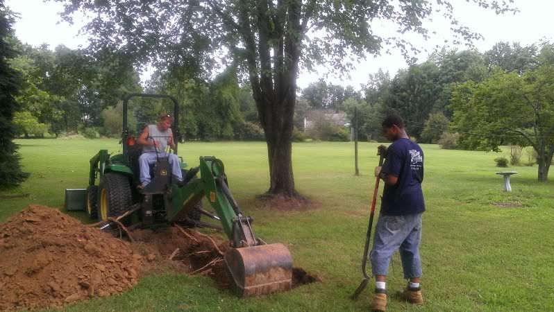

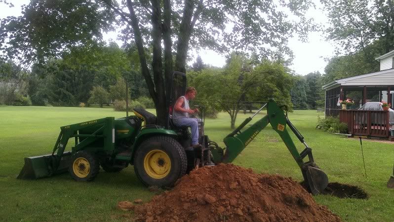

Is this is common config for a septic?
The reason I ask is when I had the septic inspected, they were probing for lines perpendicular to the Dbox (90*). Looks from the pix I took, lines are going out in multiple directions. I know they had a hard time finding them. In the 1st pic you see the probing rod they were plunging in the dirt to find the lines, but it was deep and hard clay to push through.
I understand what you are suggesting. A riser on the dbox, and then on the ends of the field. I just can't figure out where the heck my field is.

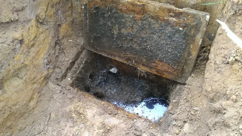

Here are some (gross) pix when they came to dig up and inspect Dbox and system.
from the camera's perspective, the lines are going straight away from camera, along the trees and porch.
Dbox: Looks like one line out to the side. IIRC, there were 3 or 4 lines out the long side (not pictured). The visible long side port is from the tank.
So it looks like most lines would go straight out from here (under the deere.) Under a whole bunch more trees of course...
