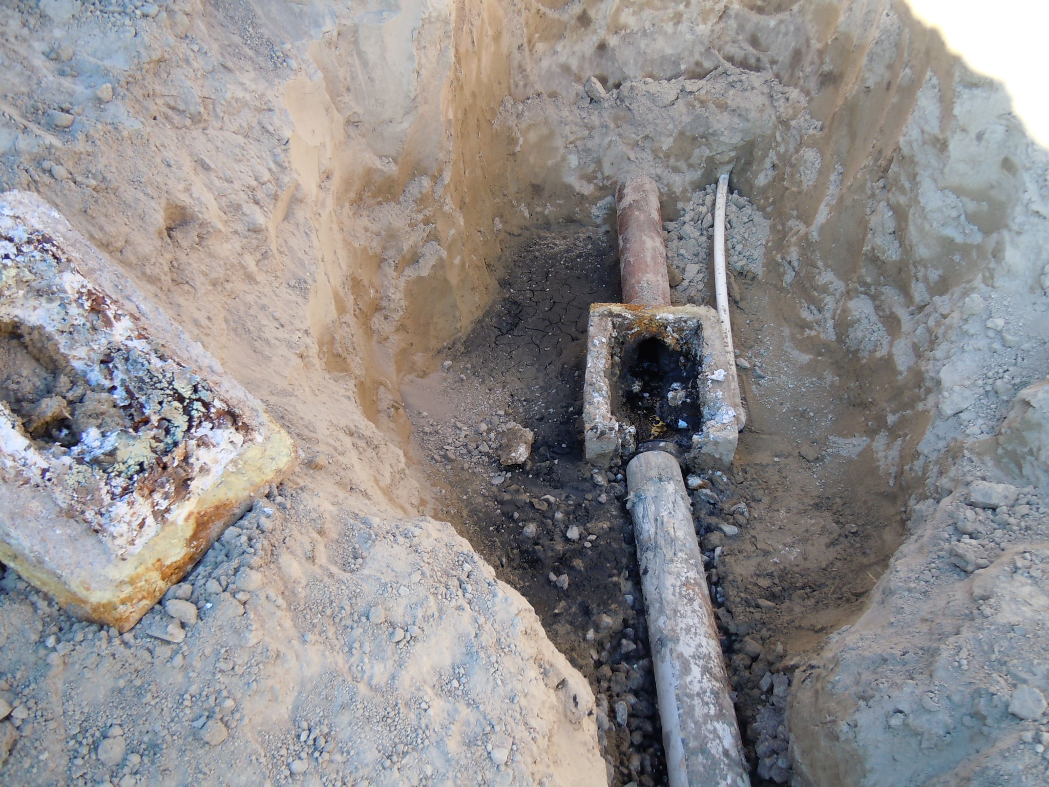

Instead of caps at the end of the leach lines do 90ー and daylight them. I would also do clean out fittings at the beginning (tank side) of the lines and daylight those as well. Makes for easy inspection, maintenance and it's just nice to know where things are.
It's hard to tell but it looks like a simple T between the two lines. Remember the flow out of a septic tank is very minimal. With that thought the tee will have to be perfect or better to ensure even distribution between the two lines. Most would opt for a distribution box so it's easier to adjust as things move over time. You will want to mark that location too.
Based on the tank size, rock and pipe length I'm guessing a two maybe three bedroom place?
Looks good! Nice work. It's looking good out there! The panel etc also looks good! The dream is near.....
Already planned on all of the above except for the D-box. I initially drew the plan and submitted them with a distribution box, and the engineers at the environmental dept changed them and said to use a "T" instead. It sits on a concrete block which is dead nuts level. The D-box would have been easier. Your right about the size.... 3br system, but I'm building a quaint cozy 2 bar now that the kids are grown and gone.

I think a tee is better than a D box. Here is a picture of the failed lid on my D box. Long story short, we had back up in the basement. Now I do not have a D box.
