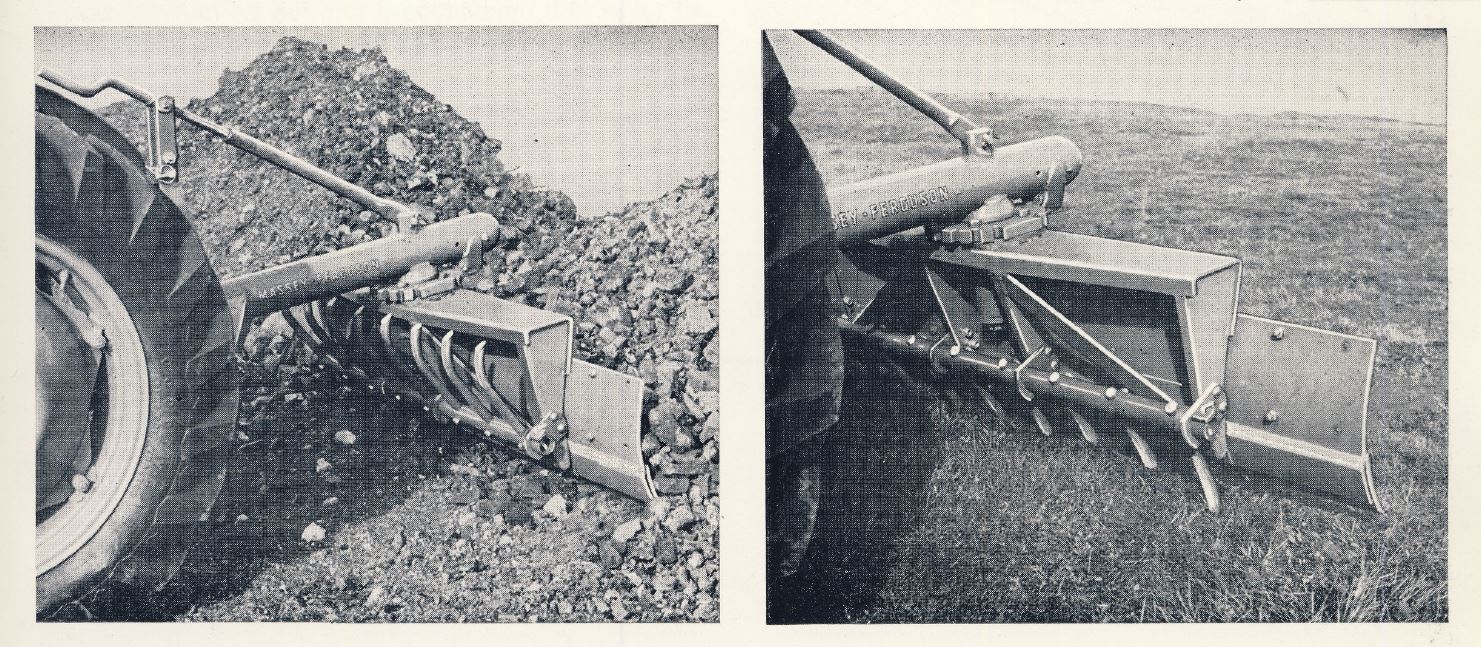

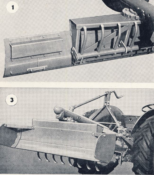

My blades does not have the rippers or extensions. I keep looking for the extensions but have yet to find any. I filled the rear of the blade with concrete to make it heavier so that I would actually cut.
Here is a snip PDF of the sales brochure for AU. I tried to upload the brochure but it was to large and the website I got it from is no longer functioning. MF21 ripper.JPG There are side plates that can also be bolted on to make the blade wider and end plates that can be bolted on to make it a box blade.
