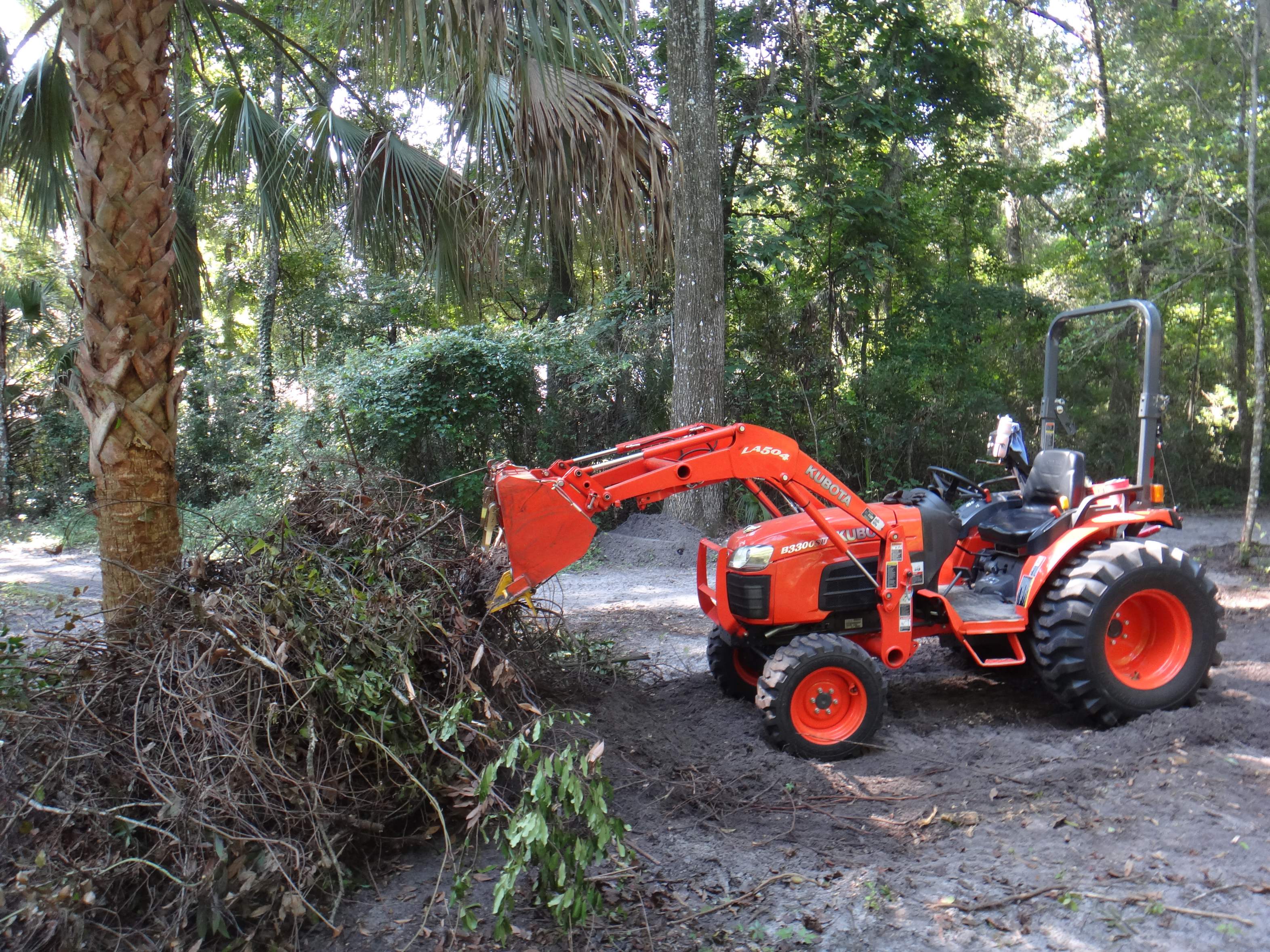

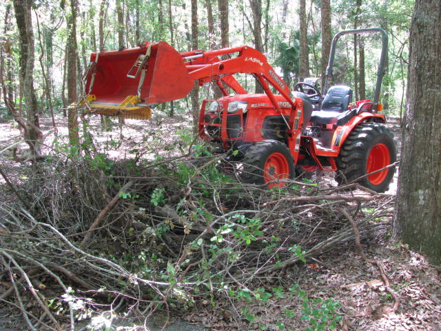

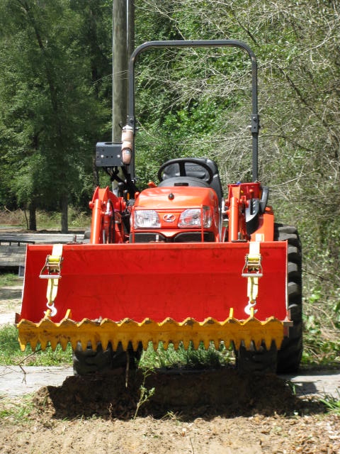

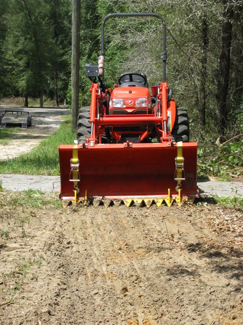

I have a Kubota B3300SU tractor-loader package: 33-hp/1,900 pounds/4-WD; largest in the 'B' series. I consider my tractor totally inadequate to your stated bale requirement.
A Front End Loader is the most useful tractor option.
About my favorite attachment goes on the FEL: Ratchet Rake @ $400
You can use RR for minor grading on your road and RR is the berries for tearing out brush and piling brush.
THERE IS NOTHING WRONG WITH A USED DIESEL TRACTOR IF WELL MAINTAINED.
Ratchet Rake Video:
http://www.youtube.com/watch?v=gvinkbW8Z90
